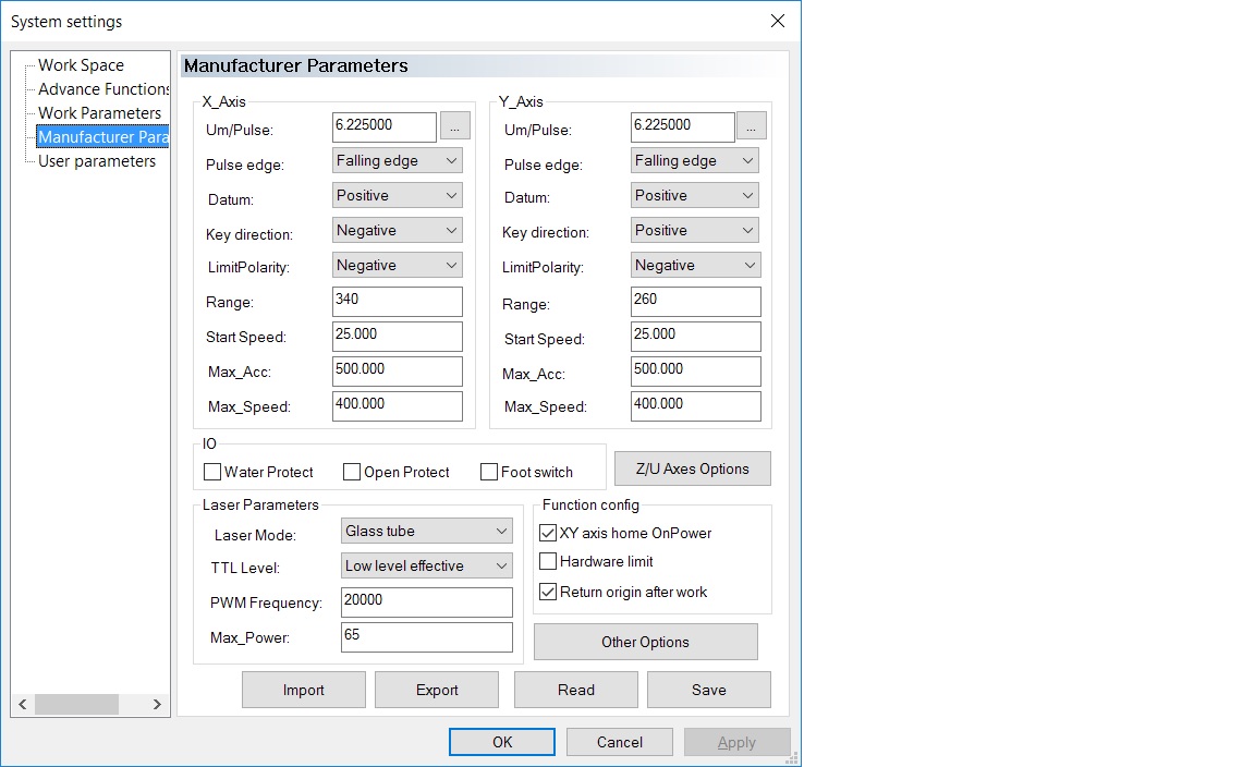

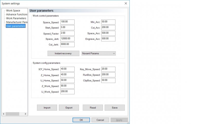

Please post manufacturer parameters and user parameters for review
BTW, acceleration seems not right because the moment seems hesitate

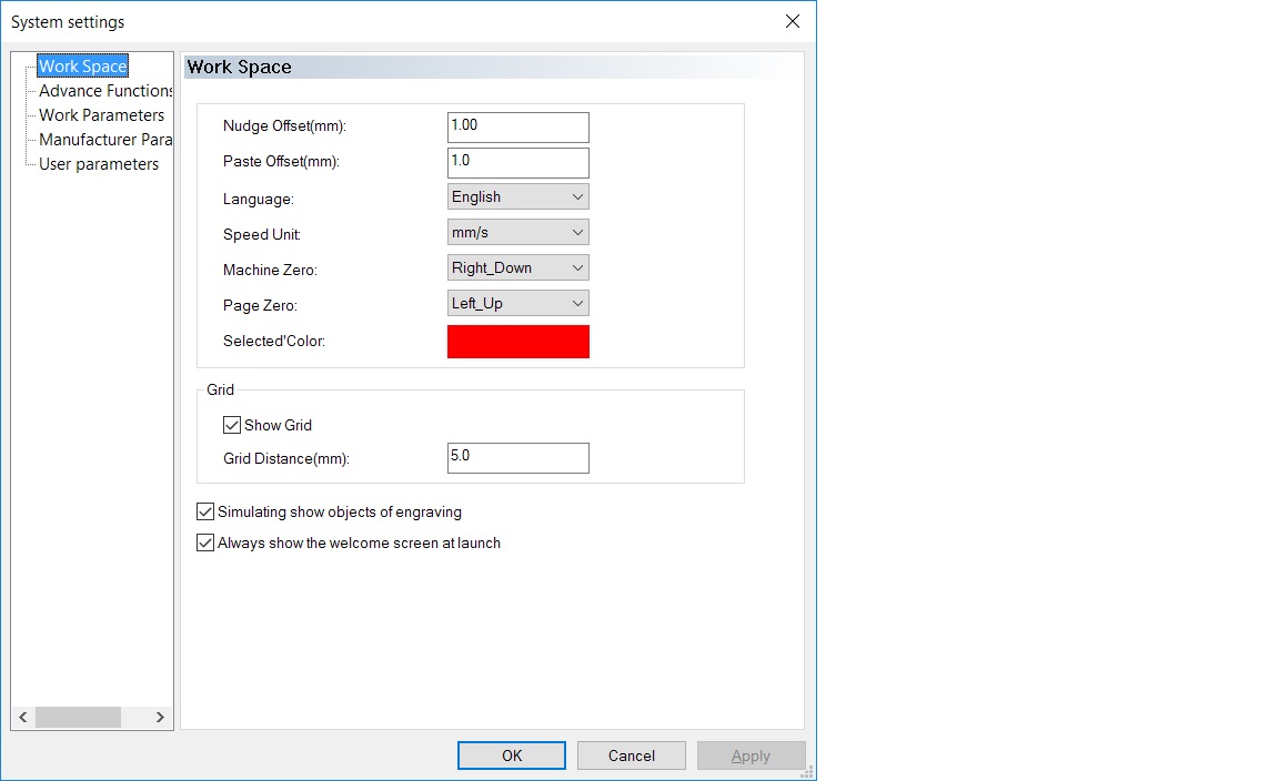

Re: Element E5 limit switches not working, faulty DSP?
I included the screenshots with this reply.
It could be that the acceleration settings are not correct anymore. I started with the factory setting and I have tried almost every setting to get the limit switches working. My working space (x and y range) 345 x 260mm is bigger than factory standard (it took me a few days of thinking, measuring, cutting and fine tuning.) The actual working space in my K40 is a bit bigger.
By looking at the parameters, I saw nothing wrong beside the max acceleration. But that doesn't do anything to the limit at all
