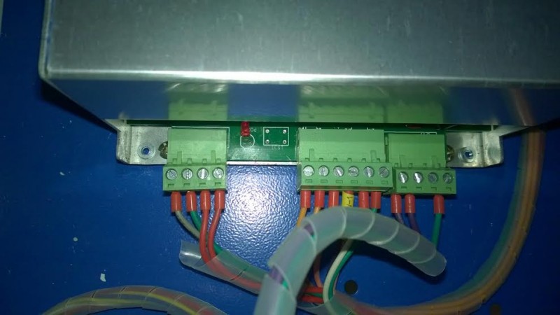

Sorry if this has been posted numerous times but I did not see a power supply like mine posted with a definitive answer. Can you tell me if this power supply is PWM compatible and if not what issues will it cause to use it with the AWC608 upgrade kit?

Do you have the same looking PS as I do? Its odd that mine is missing a wire on the right most group compared to the one in the link you sent.

I tried it and it worked. The quality is very closed to PSM. It is hard to find the missing pixel if without two copies from each
Here is the connection:
Shorted P+ and G
Connect K+ to TTL (DSP)
Connect Gnd to Gnd (DSP
Connect IN to PWM(DSP
Shorted P+ and G

Thanks Marco, I was able to get this wired up and it is working great!
