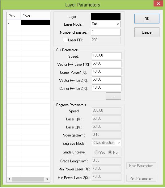

I think I found the corner power reference.
Once an object is selected on the screen, the Layer Options will be available on the right side. Doubleclick on the layer with that object and a dialog box appears that will control if this is to be cut, engraved, etc.
Cut Parameters is the section I needed.
Speed 100
Vector Pwr Laser1[%] 50
Corner Power1[%] 40
Vector Pwr Lsr2[%] 50
Corner Power2[%] 40
I changed the power levels here to 100, but no effect on corners. The gaps still persist.
I was testing on paper at 20% on the max power from the manufacturer parameters dialog box.

Re: Gaps at start and end of lines
Start speed of 5 is slow. Set it to 20
Max_power of 20 will get you to no where. Set it to 65~75 accordingly

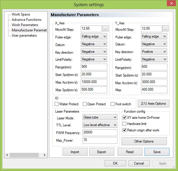

Now, do this: set the micro step to "8" and set the "um" to 12.65. Save it and press RESET to reboot the DSP

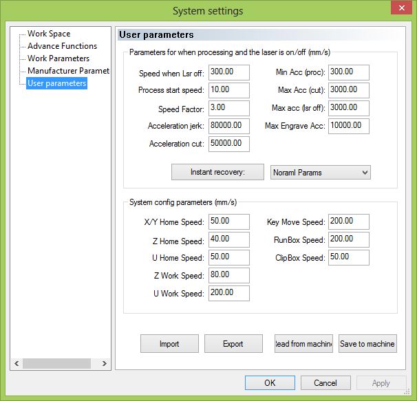

Also, send me the configuration screen on "User parameters"

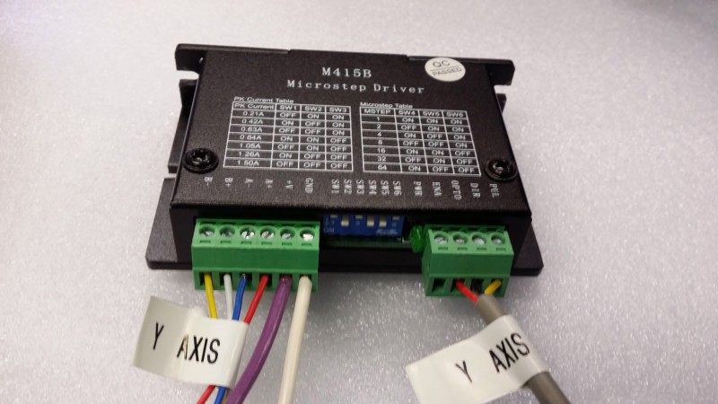

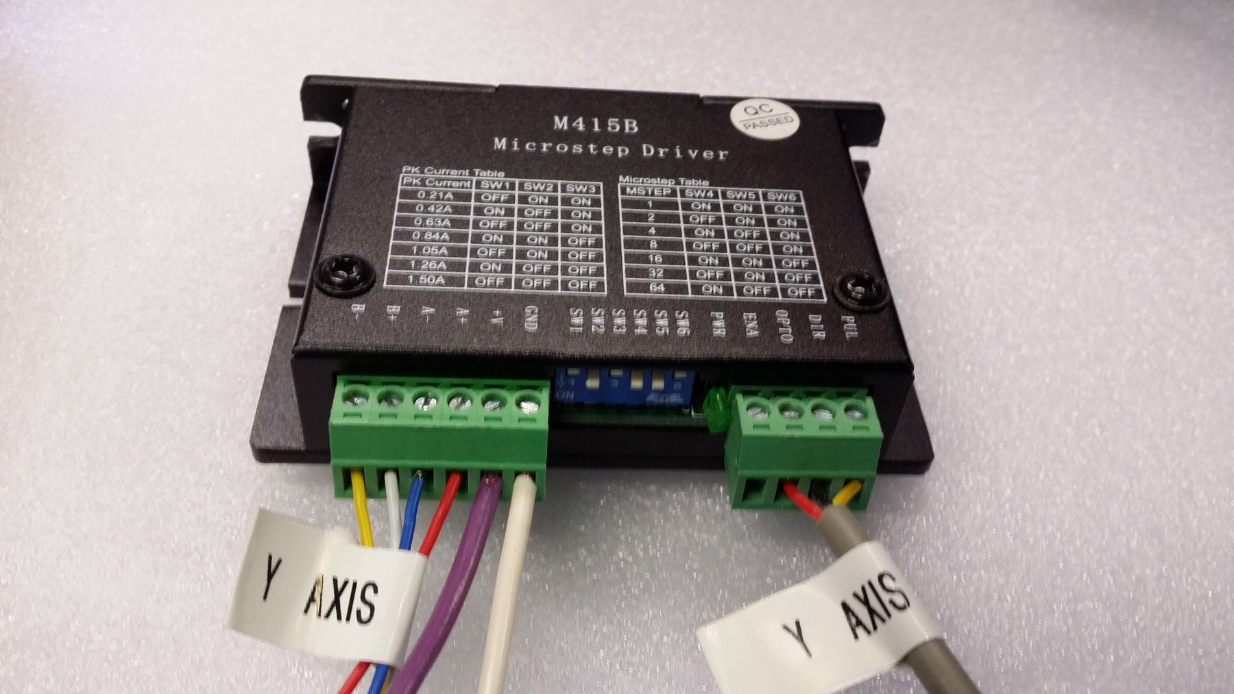

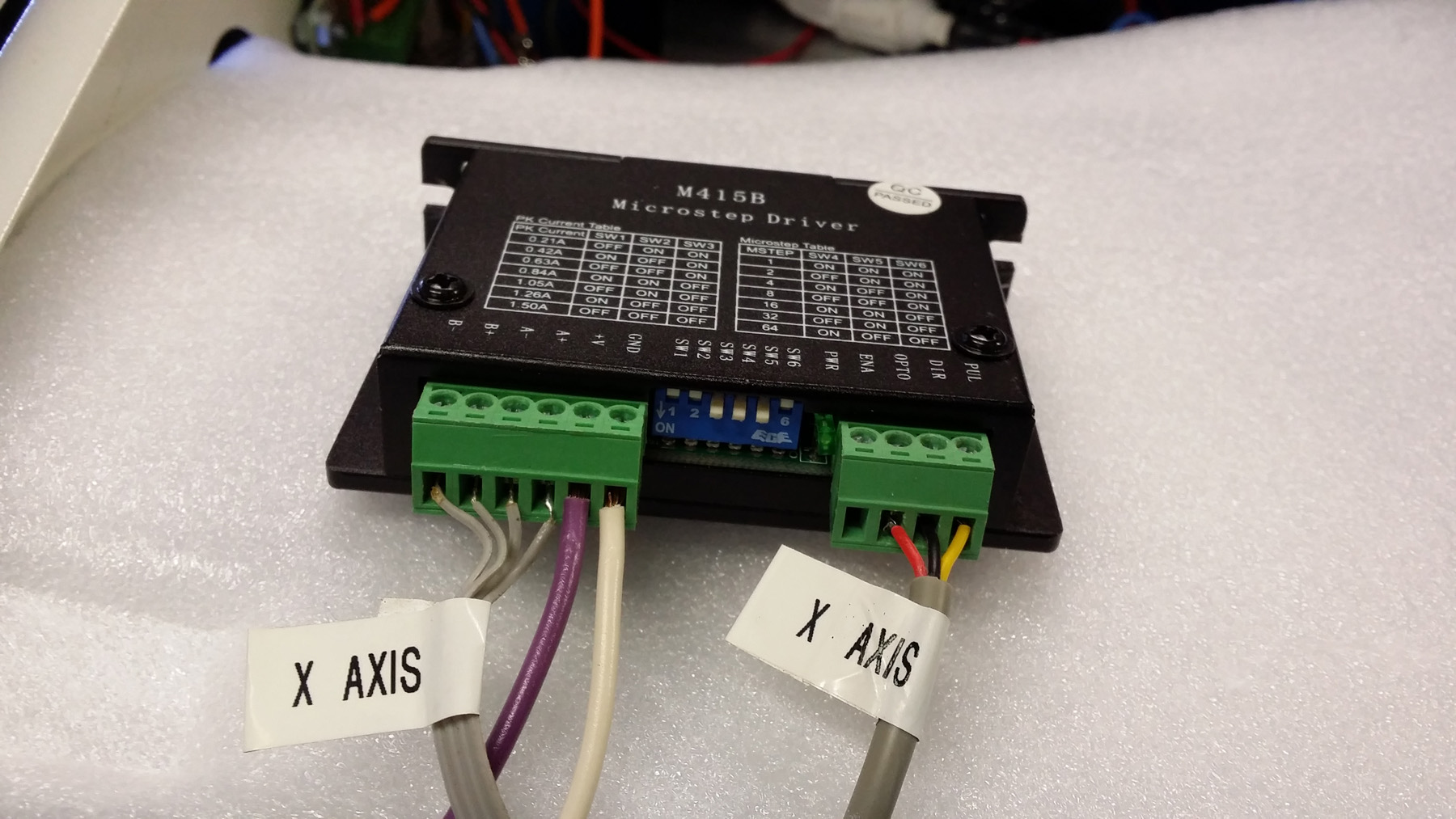

Checked and confirmed bothX and Y axis motor drivers have their microstep set to 8 as requested. They had been previously set to 16.
SW4 - UP / OFF
SW5 - UP / OFF
SW6 - DOWN / ON
UM set to 12.65 on both axis in manufacturer parameters. I did remember to read the current configuration so that I could successfully save a new one. The forum here and your information was quite helpful.
Saved configuration.
Reset DSP.
Screen shots of both manufacture parameters and User parameters included below for reference.
I really do appreciate the effort you're putting into this. This controller has a lot of potential and I can see why it is well respected.
