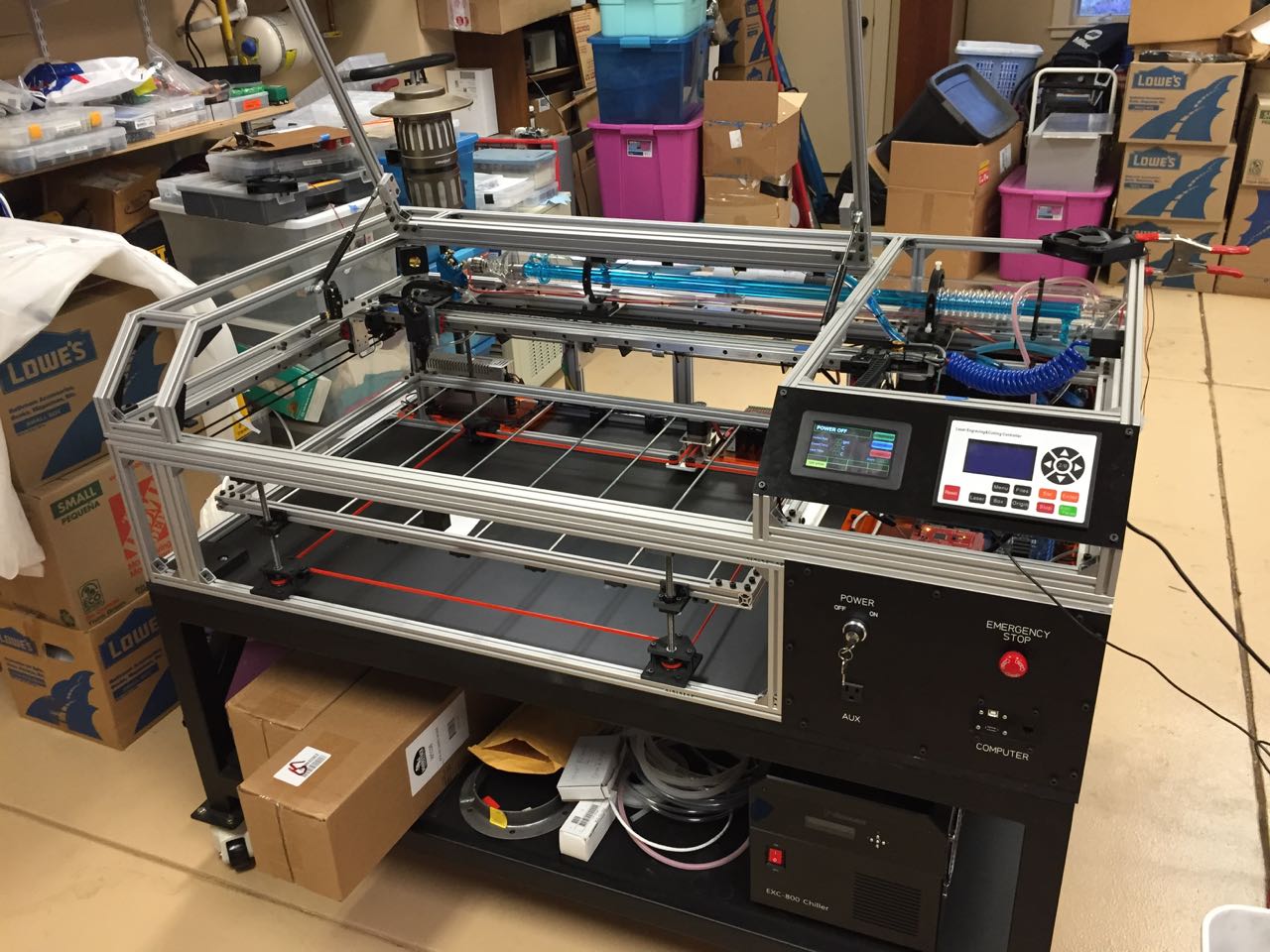

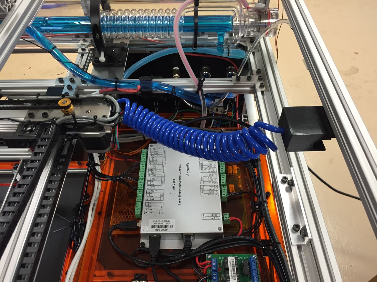

I used the following tubing for my build: McMaster PN 9148T123
http://www.mcmaster.com/#catalog/120/135/=uu78ww
I wasn't able to fit it into the tiny E-chain that I used for the wires. For the X axis, I did run the tubing through the E-chain though.
Pictures below.
/Mitch.
Pictures below.
/Mitch.

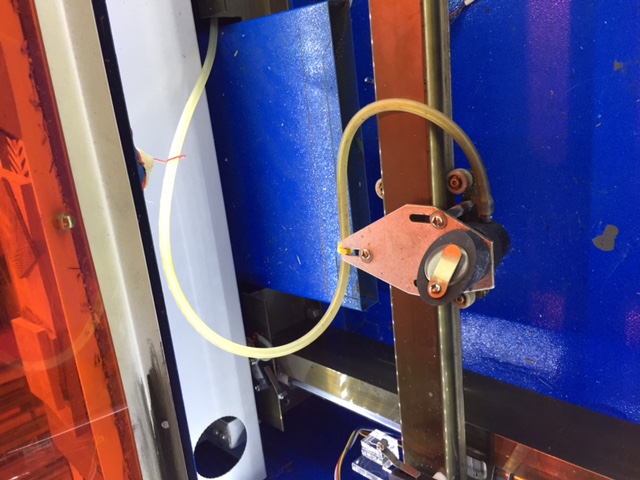

I use silicone rubber tubing which is very soft and flexible, it is zip-tied to the back of the mirror/lens counting plate.
Top dead centre (not a phrase you hear very often these days!) there is a bent paper-clip Sugrued (™) to the roof and this losely supports the bulk of the cable.
This has done many hours of work so far without any failures.
Nick
ps - Sugru - if you've never met it then Google for it, amazing useful sticky stuff!
pps - picture has got rotated 90°, no idea why but it always happens to me on this forum!
Nick

I see... the way you have it oriented it's going to work a bit like a cable carrier. That is, the tubing will "slide through the bend" rather than pull or stretch.NickWL wrote:I use silicone rubber tubing which is very soft and flexible, it is zip-tied to the back of the mirror/lens counting plate.
I like the tidiness of the coiled tubing, but your approach does have the advantage that it's simple, effective, and uses the tubing that I already have.
Thank you both, Nick and Mitch. It's really helpful to see how others have solved some of these problems.
