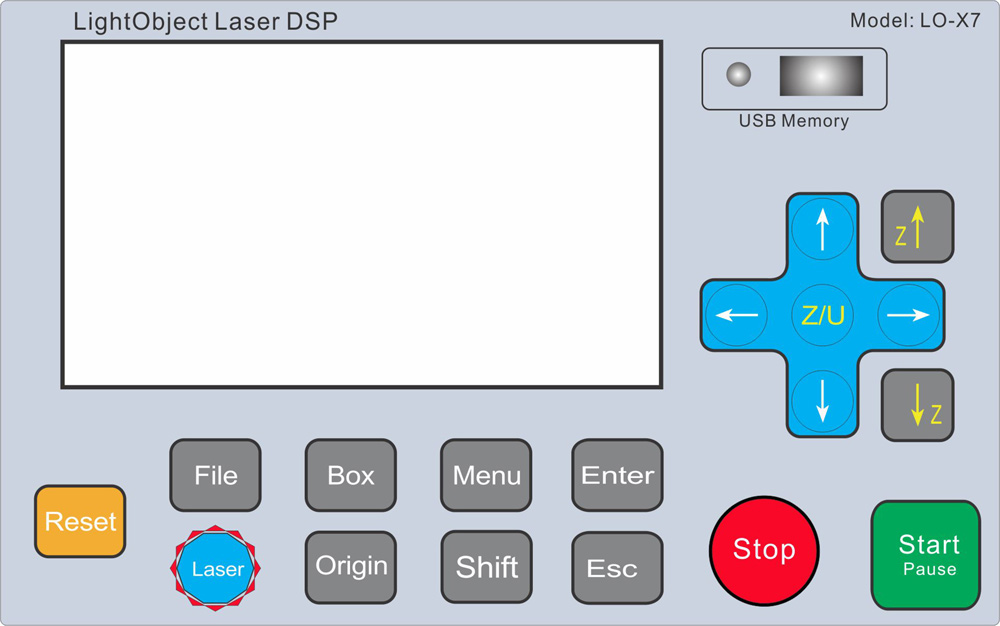

Please comment the layout of the new DSP. We're in the final stage of launching the latest DSP controller card with a 4.3" color LCD screen that is capable to show work progress. Yes, it is dynamic
This DSP card is a special version and sell by LightObject with exclusively right. The programmer is working on a specail version LaserCad that will work on this card solely but nothing else. Because of that, more features can be added to the card, some is free and some may cost.
Currently, I'm working on the front pangel design and your comment (layout, color, icon, characters) will help me to do my job better.

It's very pretty - but I'm much more interested in what goes on inside the cabinet than in the beauty of the controls.
Being able to watch job progress is a little bit interesting, but I can watch most of what I need to see through the window!
The interesting part will be the new DSP / LaserCAD features...

Why is there a z/u button in the middle of the arrows and separate z up and down buttons? It would make more sense to me to have the center button just u and keep the z up and down arrows.
For safety reasons I think it would be a good idea to press 2 buttons to enable the test fire for the laser even if the buttons are next to each other. I have accidentally pressed the laser button several times by accident, thank God no one was hurt.

A printer driver would be nice as well........

At this time, I want to stay focus on the panel layout. For the features things let's wait till I got more information from the programmer Li.
Thank you

add a button to toggle the 5v output on OUT1 on/off. that way those of use who use a relay for air assist when the table is running can turn on air while we're aligning the mirror in the cutting head.
there have been a number of times that i have to clean the focus lens after i align the mirror in the cutting head because i've fouled the optics with my test fires when checking mirror alignment.
or, add this as a software button in lasercad. either way, it would be very heklpful

I like that idea. It could also work if you wanted to run a relay/switch for a red laser pointer for assistance...or any other options for auxiliary control.swamidog wrote:add a button to toggle the 5v output on OUT1 on/off. that way those of use who use a relay for air assist when the table is running can turn on air while we're aligning the mirror in the cutting head.

That doesn't need DSP to do the job. You can add a toggle button to enable the pump or laser pointer. Isn't it?
But I'll ask see if I can get a toggle button on the software.

Give handheld version too. you know my machines big. So Handheld better for me.
By the way One big thing I want; SERVO COMPATIBILTY.
Looks AWC608 not so good for servo driving(even high-end yaskawa servos) , like "G-laserguy" said long time ago ; "the pulse-output-waveform is not perfect. The reason for that are the output optocouplers used in AWC-608". (post= viewtopic.php?f=8&t=1303&hilit=pulse+op ... s&start=15 )
Maybe you can add encoder input or better pulse output.
