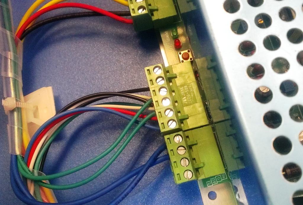

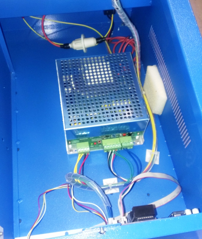

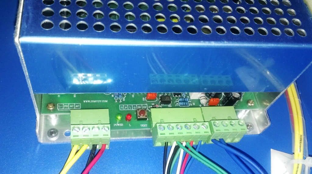

I just got a new K40 laser from Automation Technologies. Can someone tell me if this power supply is a DSP supply that will work with the DSP or will I need to get a new supply.

Afraid not! That power supply won't do the job so you'll have to buy a new one; make sure it has PWM facilities.
The advantages of replacing your old one are enormous and include (so I'm told) a MUCH longer tube life.
