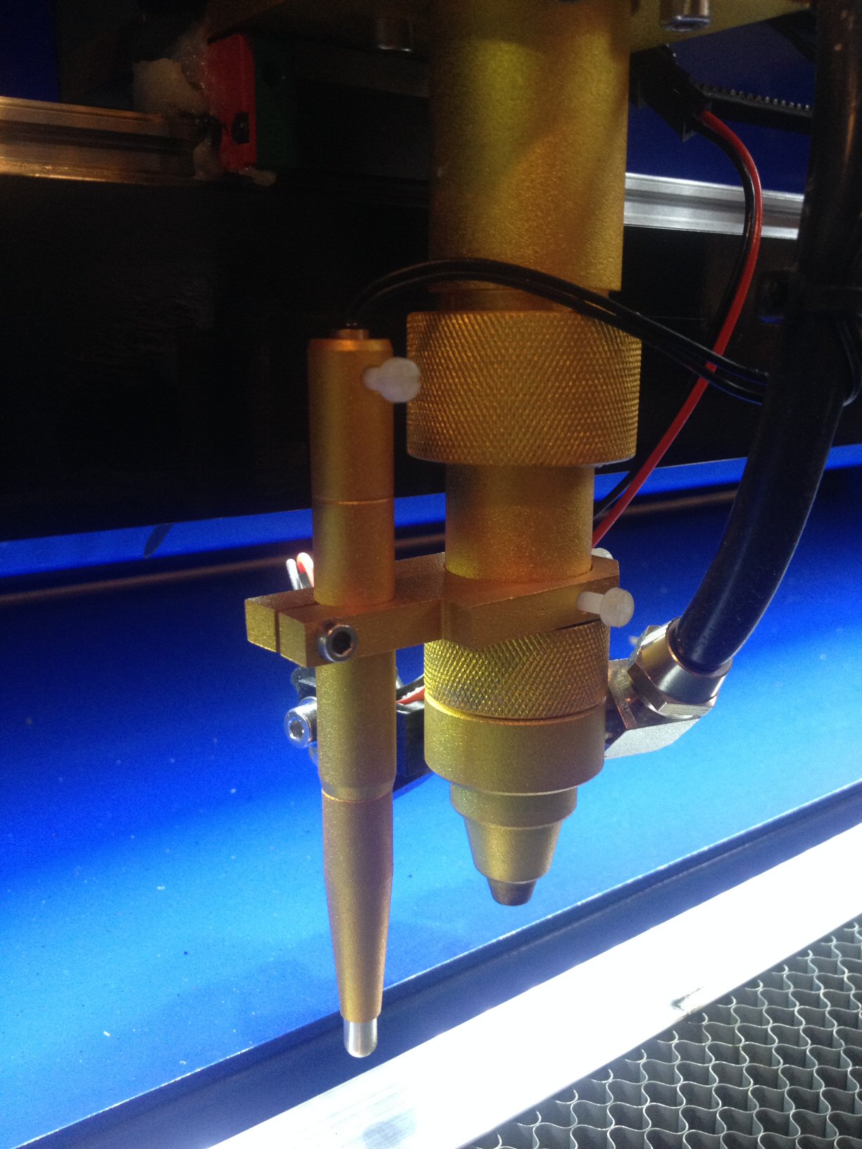

This is a picture of the sensor I have on my machine:
Re: Auto focus revisited
Nice probe! It should work
Let me send you an update of the OS as we changed a bit of something and make the 'Z' better
Check your email and PM

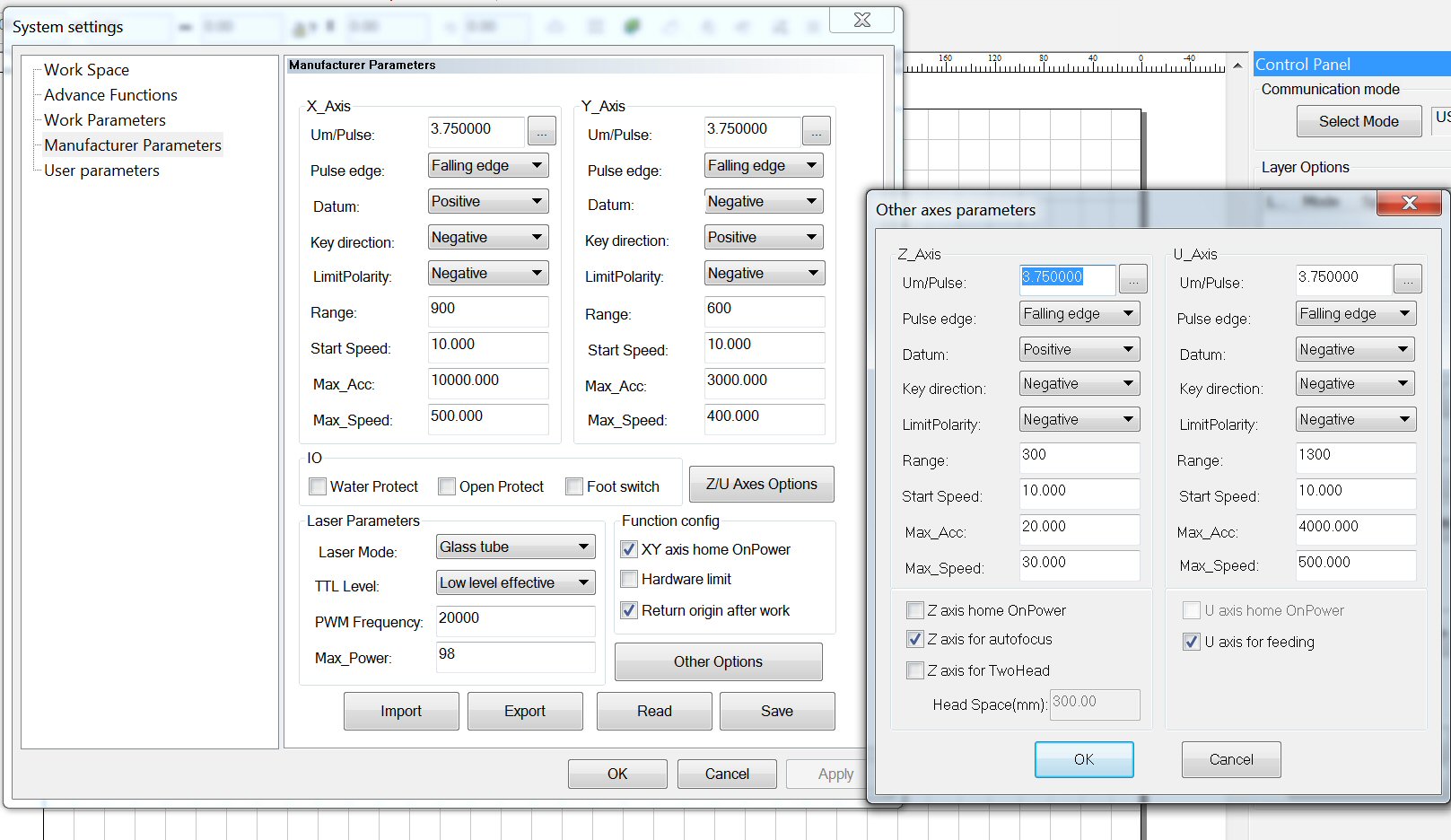

I have enabled Z home as I indicated in my previous post. I set the focus distance to 30mm and I still get a Limit triggered error. So I really need to know how you have things configured to make it work. Exactly where should my Z limit/Auto Focus sensor be connected to the controller? I have it connected to the z limit input.
I didn't see that you have Z home enabled from your previos post. Show me where. Plus, once you made change, you need to Save it and prrss RESET on the LCD control panel to apply the change
AWC608.auto focus is a little diferent than than your card. It wont do auto focus when power up. Instead, it stay to the default until you made some change on Z, then press "Auto Focus" and the Z table will move up till the object touch the sensor probe. Then the Z bed move downward to the distance you set

Sorry if my posts have not been clear. I will try to make clear what I have done to try and make this work and see if we can figure out what I need to change.
“I didn't see that you have Z home enabled from your previos post. Show me where. “
Please refer to my post of April 4th where I attached screen shots of the Z/U Axis settings where I checked the box for ‘Z axis for autofocus’.
“Plus, once you made change, you need to Save it and prrss RESET on the LCD control panel to apply the change”
I did a reset after saving the changes

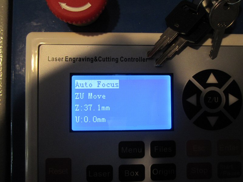

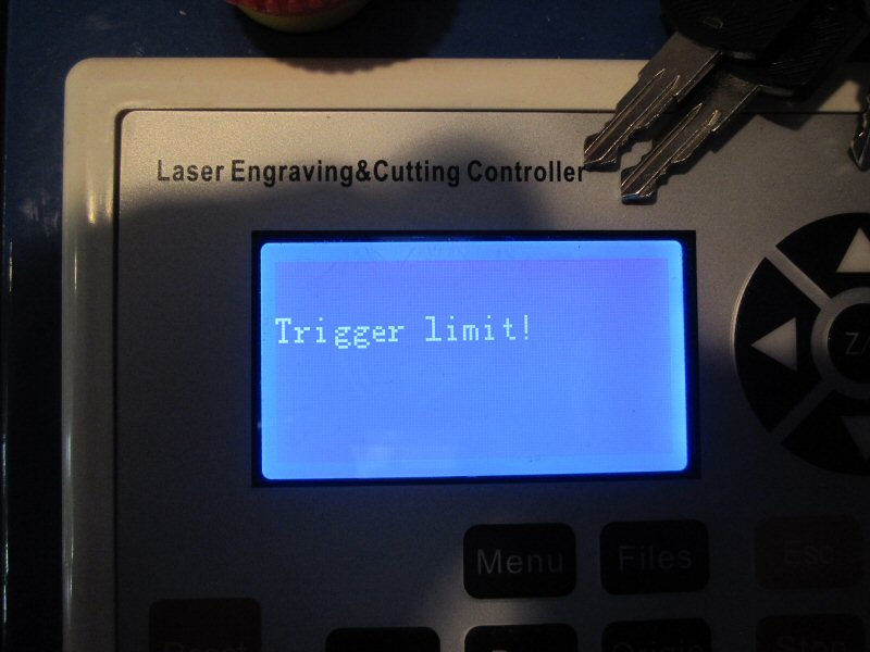

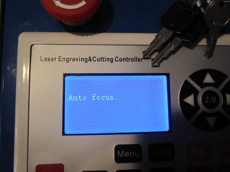

Here is where I have the problem. The Z axis has been lowered to allow placement of the work piece. I then perform the following steps:
1. I press the “Z/U” button on the LCD panel.
2. The default action becomes Auto Focus and I press the “Enter” key
a. The Z table moves up to the Z axis limit/auto focus sensor
b. LCD displays “Auto focus…” while the Z table is moving up.
c. The Z table contacts the Z axis limit/auto focus sensor and stops
d. The LCD displays “Trigger limit!”
e. The Z table does not move after this.
So, I still think that I might have the Z limit/auto focus sensor connected to the wrong pin on the controller. You have not described your connections so that I can to compare mine.
zkmiller
If you have paid just a little attention to my post, I emphasized that the "Z home on power" to be enabled. It is not just enable the Auto Focus alone. You need to have both checked!
So, check on that option and let me know if it works out
The connection is Gnd and Z-, nothing rlse different
