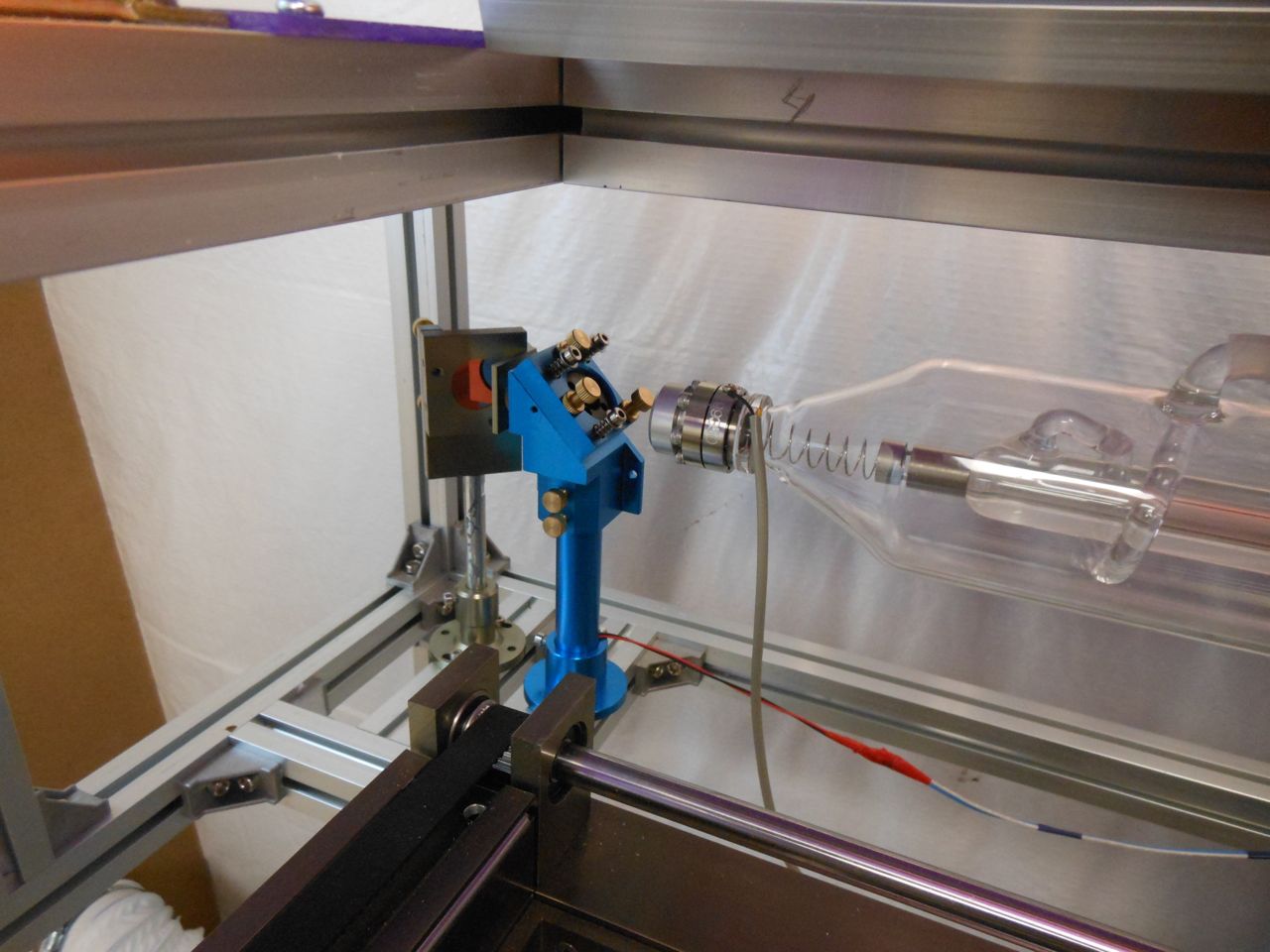

AndyKunz
- Posts: 89
- Location: Illinois
Re: how indeed does a beam combiner help?
Like this. Tube is to the right of the blue beam combiner.
