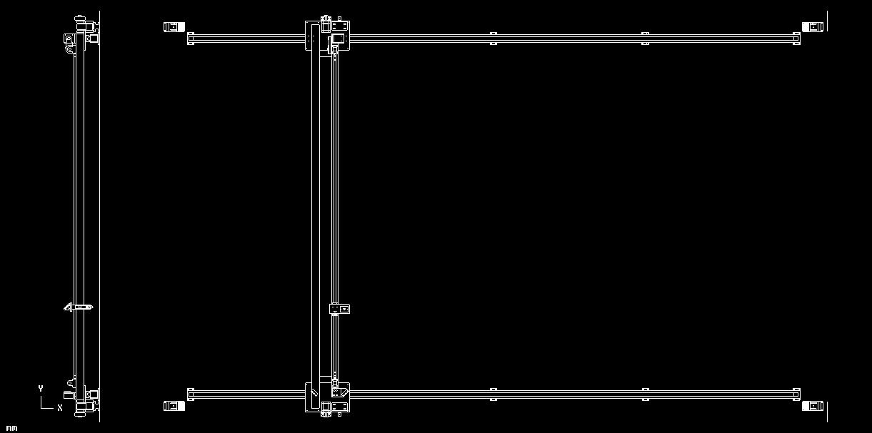

See 2M*4M tube riding XY stage. The max size using "Y-wheel" is 4m*4m (157.5" x 157.5")
Two Y motor (86 series) is required
- XY2MX4M_TubeRiding_TP.cdr
- CorelDraw actual size
- (327.56 KiB) Downloaded 381 times

DwightMann:
Yes, the tube is riding on the gantry and may be with the power supply as well. This stage is desgined for 'cutting' so speed isn't really matter as X can still "flying" like a regular XY stage. The Y axis is driven by two "86" stepping motors (much bigger than a 57 series). Engraving is OK but not to expect as fast as a small XY machine. Remember that the X is much faster than Y when doing engraving. And for the cutting, most job are running at 10mm~20mm/s at most.
The biggest issue is the "Shipping". This stage is 2M*4M = 6.6ft * 13.2ft. Most carrier refused to handle item over 2M long and they charge 'over size' quite a bit. I have ordered two of this system but it will ship to my by ocean freight. A customer just order the same system but I have to make it smaller 1m*1m and he will 'reb-build' it once he received it in this country. I have to provide him a diagram so he can make it up himself
If you have a big router then it is not difficult to convert it to a laser cutter. You may want to install the laser tube on the gantry provide that if the gantry is strong enough to drive the laser tube. One of my customer sent me a picture of his CNC-Laser machine with a 60W laser install 'vertically' to the gantry. Of course, it id dedicated for low speed cutting only. The tube was standing on top of the ganry so you look at the picture, you would feel 'Wow!' By the way, doing this way he saved two mirrors. Plus, power is more stable and concentrated than having a laser beam travelling in both X & Y distance. So, a 60W seems stronger than a standard machine and it does better cutting for acrylic or wood.
