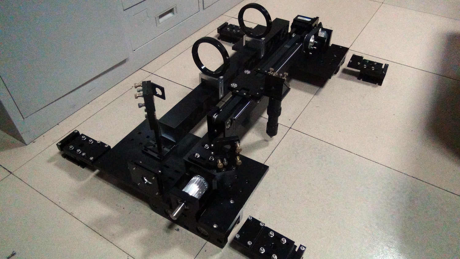

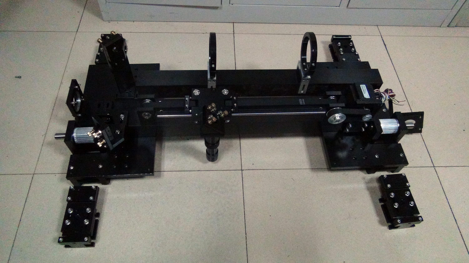

To cut cloths, even a 40W laser is good enough. However, the light beam travelling must be short. To accomplish this, there is a special setup on the XY stage. The tube is carry-on the X gantry. So the laser beam travelling distance is limited to certain length so that laser power is not affected too much. I will carry the system soon. The special XY stage is having useable area at 2000mm * 3750mm.
See attached images.
Note, the pictures seems small but the complete setup is big as the Y guider is not showing yet and the X is for a small setup. Plus, the pulley is much bigger than standard one and 3 phase motors will be used.
