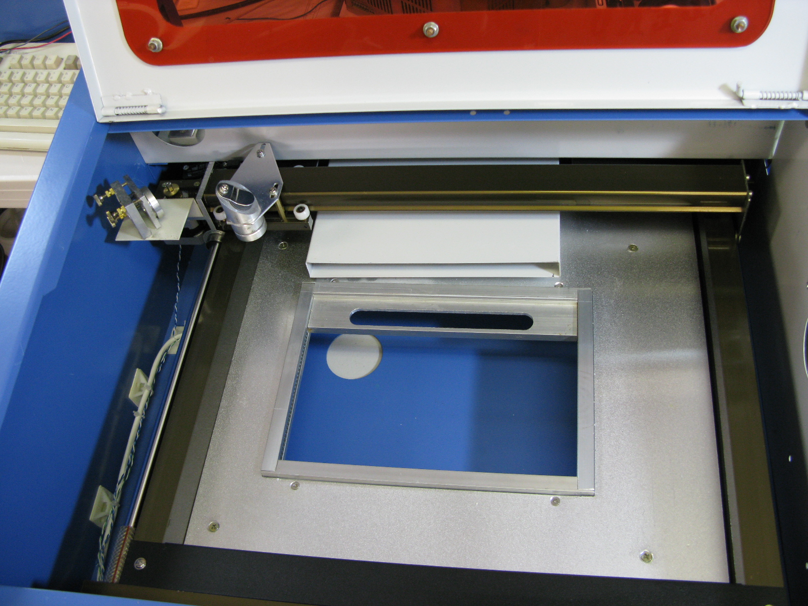

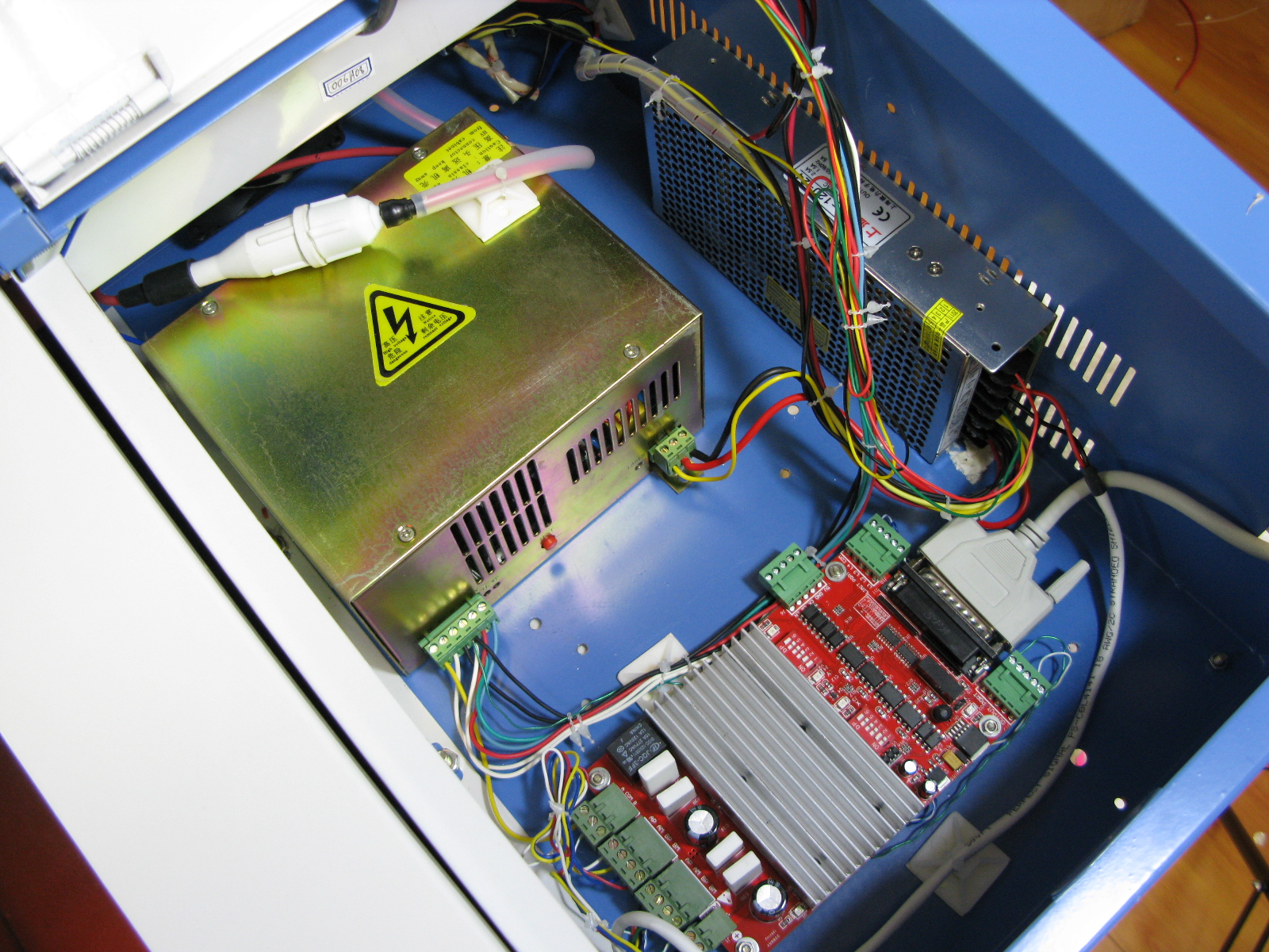

I just finished a conversion for my customer "Jim" who was very patience to wait for the project to be completed. A two axis TB6560 motor board is used and it runs great on Mach3

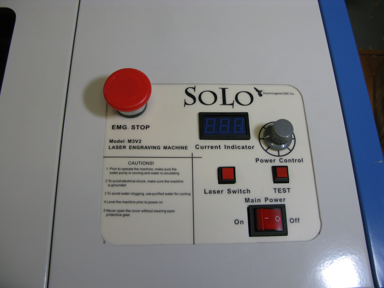

Looks nice! As a bonus I finally got to see how someone wired their emergency kill switch.

Marco, this board can it be used for engraving aswell as for cutting an how is the laser fire triggered.

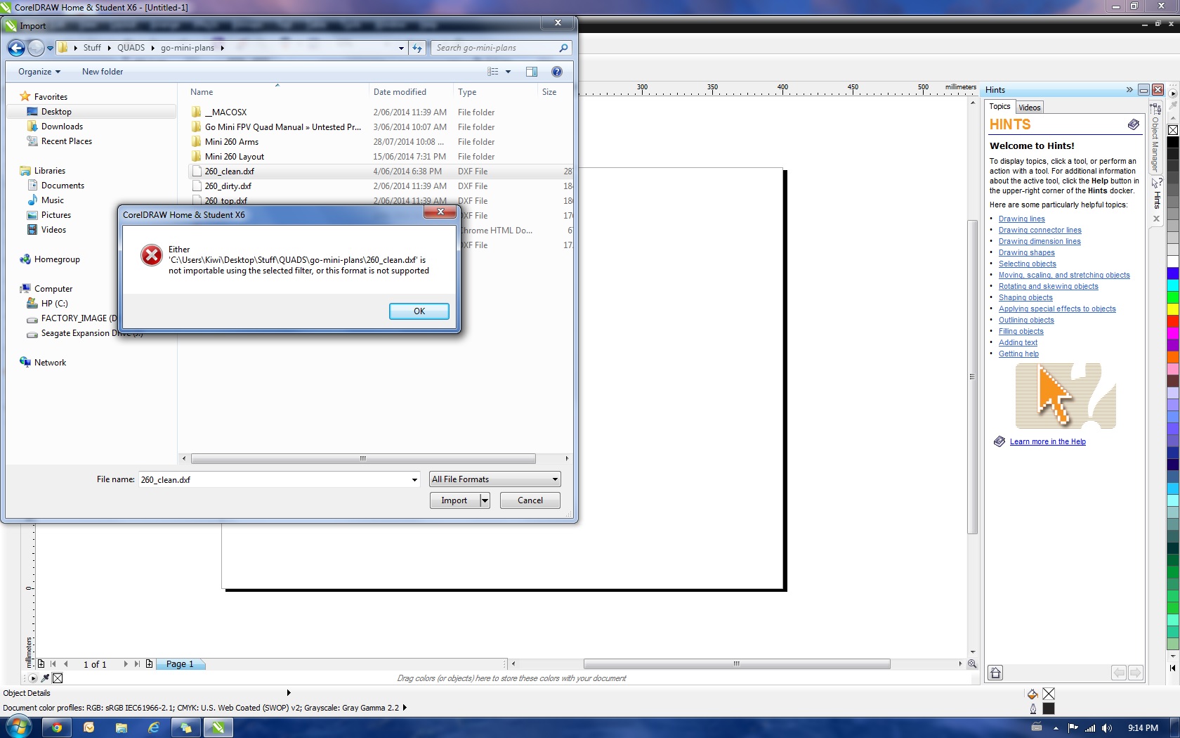

ok then something is wrong with my coreldraw, just checked which file I was talking about an it is a dxf file.
I went into draw an tried it as an open file, no reconise the file, tyhen tried import same thing so something is amiss.

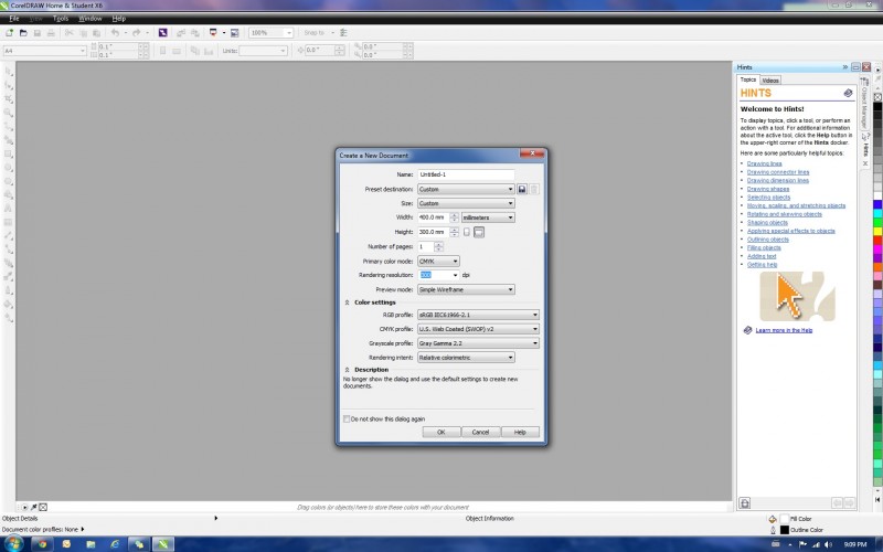

I opened fine for me in Corel X6, you need to start a New drawing and make the settings either metric or US inches and then Import. Came right in, I did my New drawing in Metric which I use because my laser engraver is Metric.

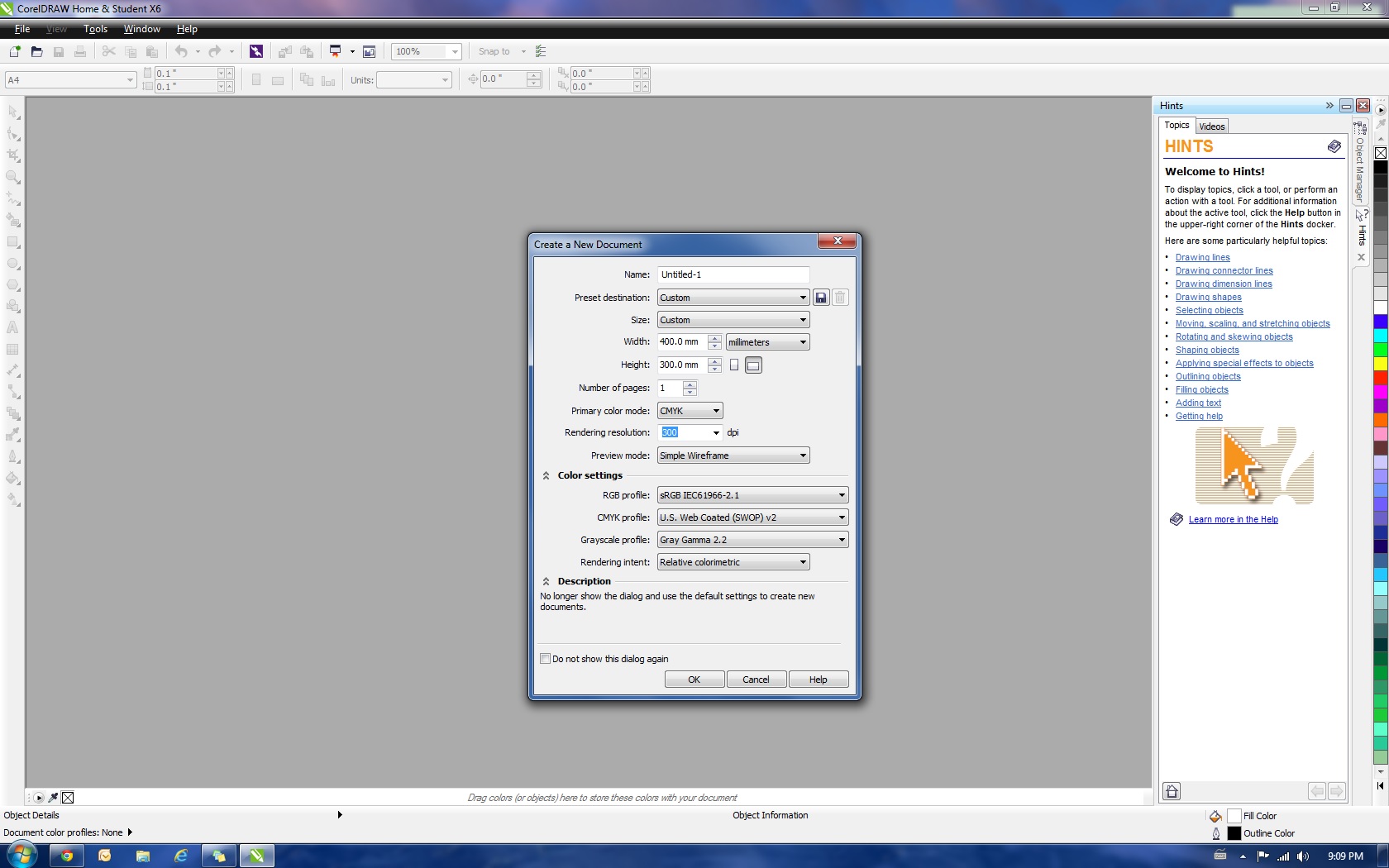

Hi,
Ok took screen shots of the dxf file, first is new draw setup, the second is import drawing.

Thanks for the insite for the dxf file, coreldraw does not handle it, just coverted it to AI file the imported to coreldraw.

Marco, Were you able to use the stock optical switches with this conversion? If so would you share how this was done? My new K40 has the ribbon cable for the switches. Thanks, Doug.
