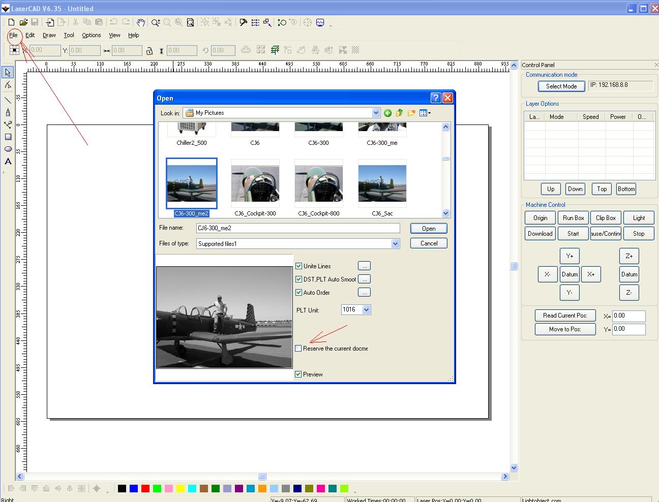

hi marco
now I am not sure where can I find this " reserve the current document" and where to put the checkmark on the laser??

Tech_Marco wrote:You may import different file into LaserCad and use layer to separate it. To enable the layer, just put a check mark on the laser. To enable multiple image, put a check mark on "Reserve the current document" and it will allow multiple images to be imported
Re: Open multiple files in lasercad
When you're doing image importing using the "Import" feature by clicking "File"
The option is right at the bottom of the pop up screen

Hi marco
thanks , I never look down there.

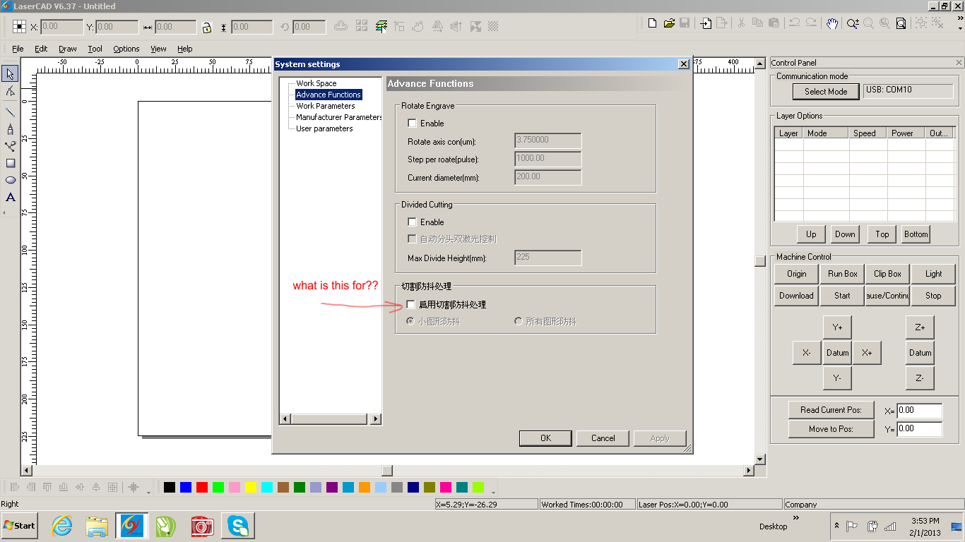

did you find out what the chinese language stuff means in the new lasercut manufacturer settings means???

Tech_Marco wrote:When you're doing image importing using the "Import" feature by clicking "File"
You lost me. Where is it?
hi marco
its this here see attachement
waltfl ote="Tech_Marco"]You lost me. Where is it?[/quote]
