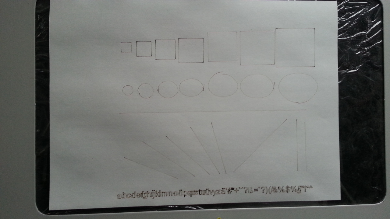

since my laser started working 10 days ago, i've done countless tests with various parameter iterations.
there was some progress but clearly not enough.
i made some tests with squares, circles and lines at various angles.
squares are not perfect but ok
lines are also the same
the major problem is that sometimes the cutout lines would be jagged, but not in a pattern, rather arbitrary. for instance, when i compare some letters i cut out, the errors on same letters are not consistent.
AND THE BIGGEST PROBLEM IS
circles up to 20mm radius are ok but above that, the starting point wont match the end point, not only that but the shape would be elliptical.
i tried to make sure the belts are nice and evenly tight. everything is nicely oiled.
these didnt help, the problems still exist. and suggestions to what i should try next?

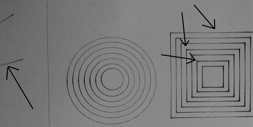

Try changing the "Pulse Edge" from 'Rising edge' to 'Falling else' or the way see if it help
Also, try lower speed see if it made the difference.

changing RISING EDGE to FALLING EGDE fixed the initial problem. check out the results
THANK YOU MARCO!!

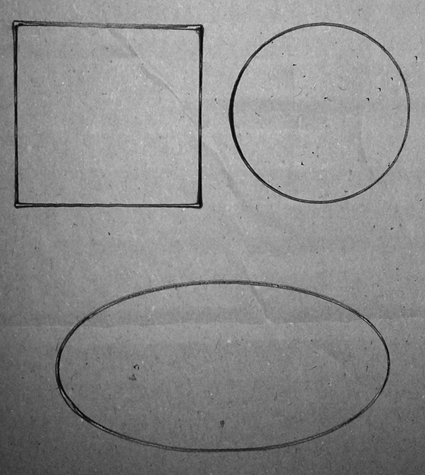

i was making all these tests with 10% power on a sheet of printer paper.
after getting better results stepped up the material to 4mm corrugated cardboard.
with 4mm of material, i have to make several passes (8 passes) in attempts to cut through with 30% power. (more power with less passes idea wouldnt work for this material, as the piece catches on fire, corrugation=glue+air=fuel for fire)
-making several passes/cuts revealed a fresh error, repeating cuts wouldnt align. (cutting text was much worse)
-jagged lines are not as extreme but still there
while the circle and square tests (sort of) pass, the ellipse test is (clearly) failing. please see the attachments
test pieces were affixed via cellophane tape to avoid any sort of vibration related movement
has anyone ever had anomalies as such? any idea why?

What step resolution did you use on stepping motor driver? I suggest to use 1/8 or 1/16 (preferred). How fast did you run the ellipse? For K40, I could run 4~5 times of the same play without any shift. In most case, it's mechanical issue. Double check the motor and the belt tension, especially for the 'Y'
Re: problem with circles and jagged lines
Hi there
first check the end pully on the X axis some new ones was not tight on the L bracked , just wobble on the pully if it moves you need to take out the L bracket and tighten the nut undernice.
try to move the X axis ( gantry by hand with power off and feel if there is something what stuck the weels on the laser head.
make the square test and be precise measuring the burned square with a caliper a tape is not precise enough!
dont use the PPI till everythings is perfect.
one more thing, check the gantry wheels if they are snag on the rail and not loose maybe they need to be adjusted
cutting corrugated cardboard is a bad idea anyway, because of the corregation what has empty spaces in between.

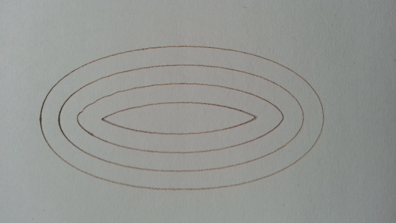

the drivers are set at 8step, i tried 16, but the results were too steppy, perhaps the stepper motors cant handle that. i also tried 2 and 1 out of curiosity, didnt help much.
