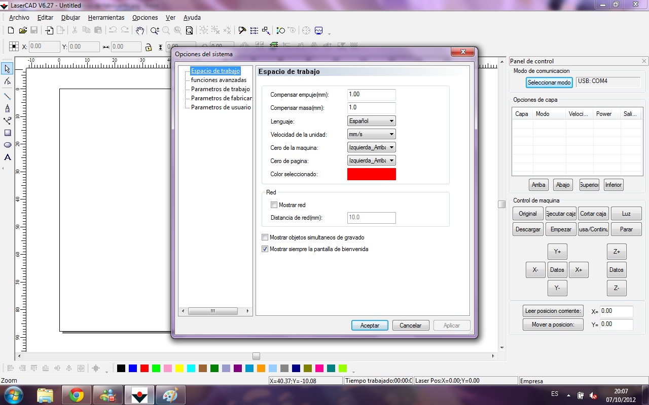

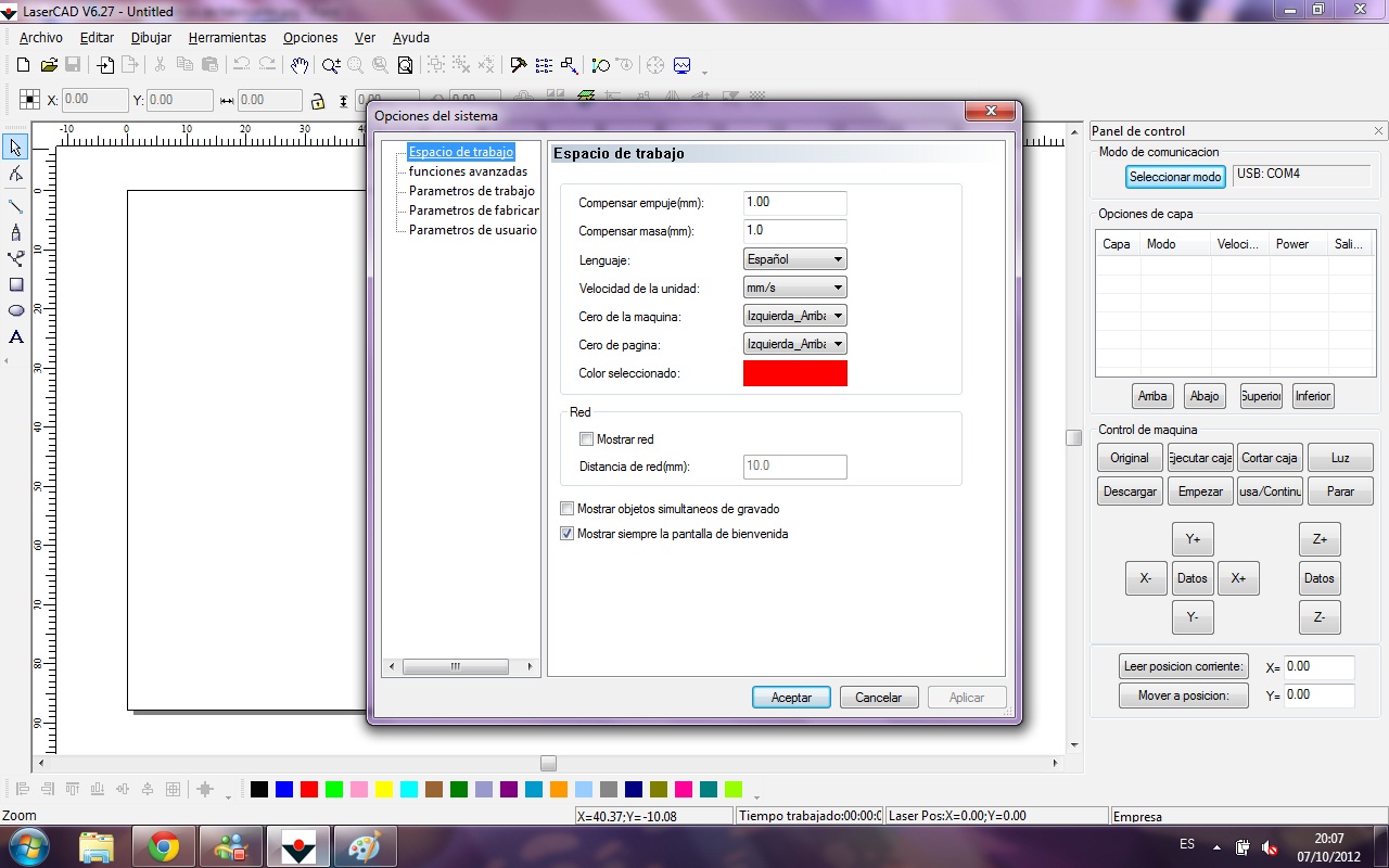

The problem this one that the awc 608 does not recognize the area of work, whenever I order a work from lasercad to the machine begins the work in the point x=0 and y=0 and on having finished the work does not return to the initial position, remains in this last position registering the coordinates as 0,0 and on having begun other one you see the trabajono it goes to the top left corner but it begins in the center of the machine or in other coordinates that not so n the initials

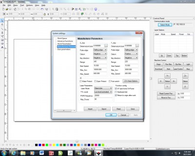

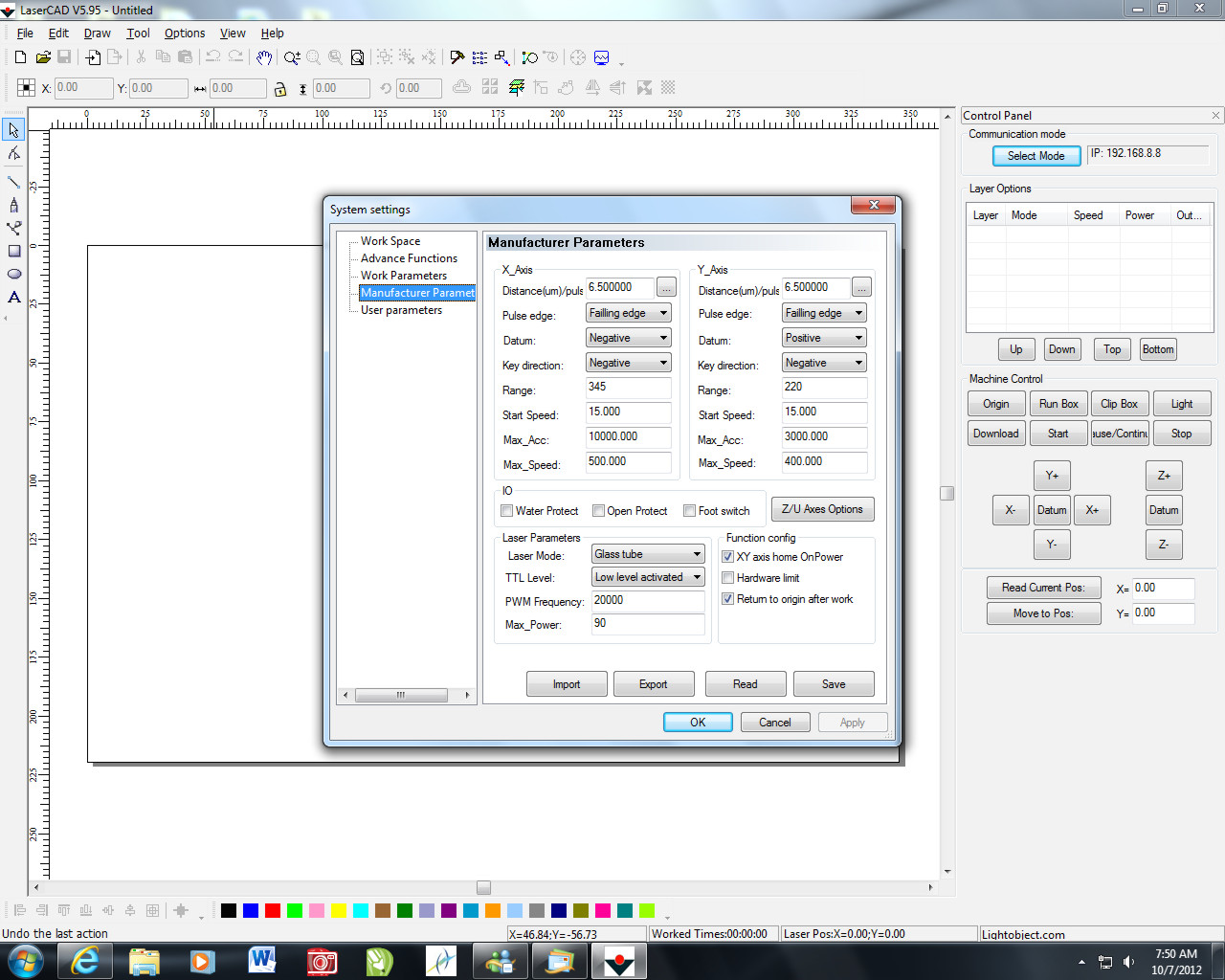

did you set in the manufacturer settings to return to home position?? see picture
you maybe also need to set the home position manually with the arrows on the display back to
the position you want and then press the home botton.
no probleme with language.

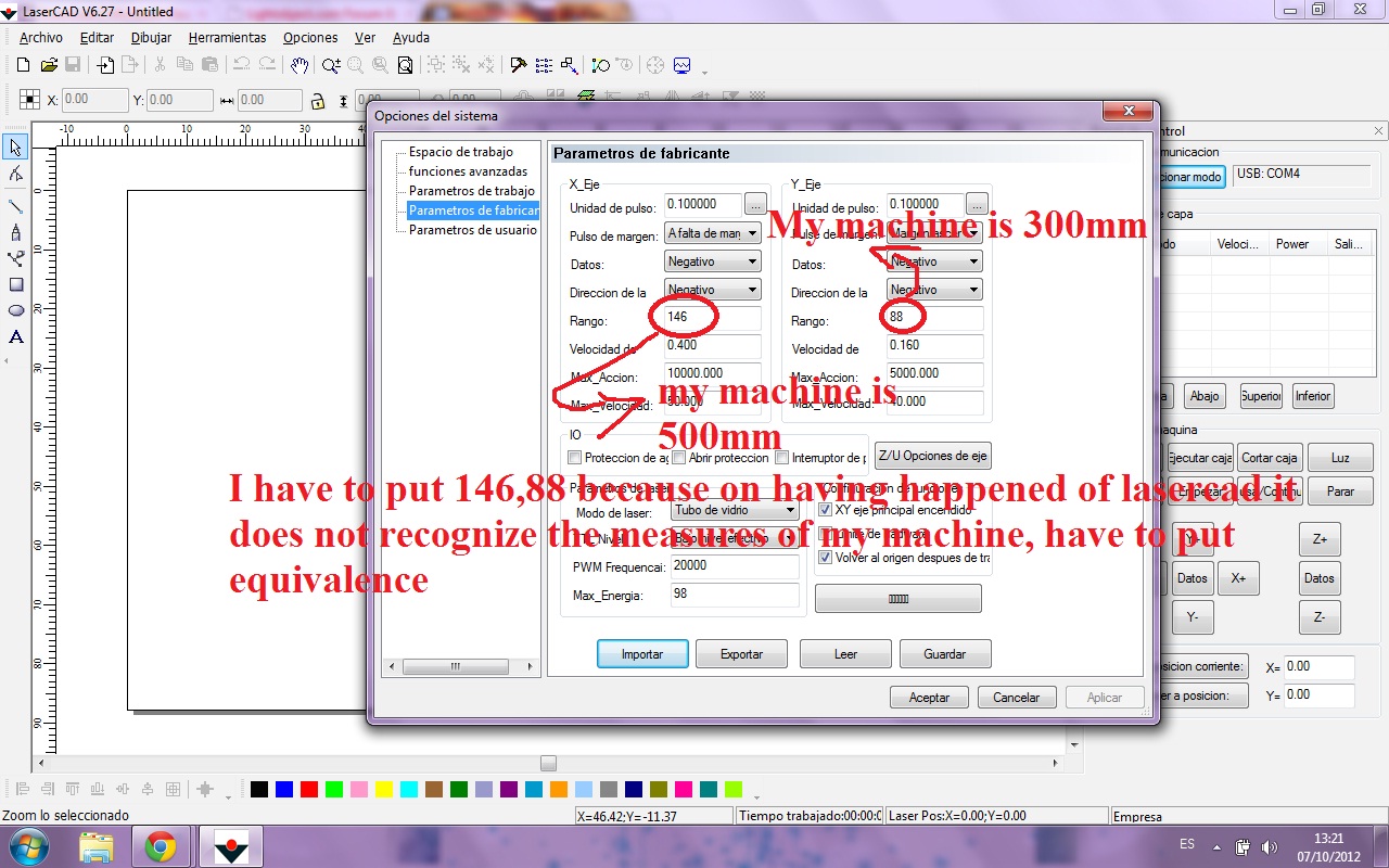

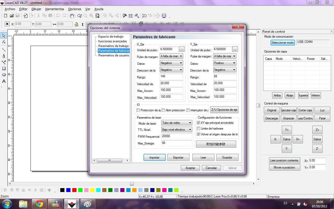

If, apart from this problem I have other one that I show in the image. On having put in lasercad a unit of measure on having ordered it awc608 this one it me realizes it in other measures that do not correspond with the puttings in lasercad, but first querria to solve the problem of poque me does not return to the point of beginning thank you very much

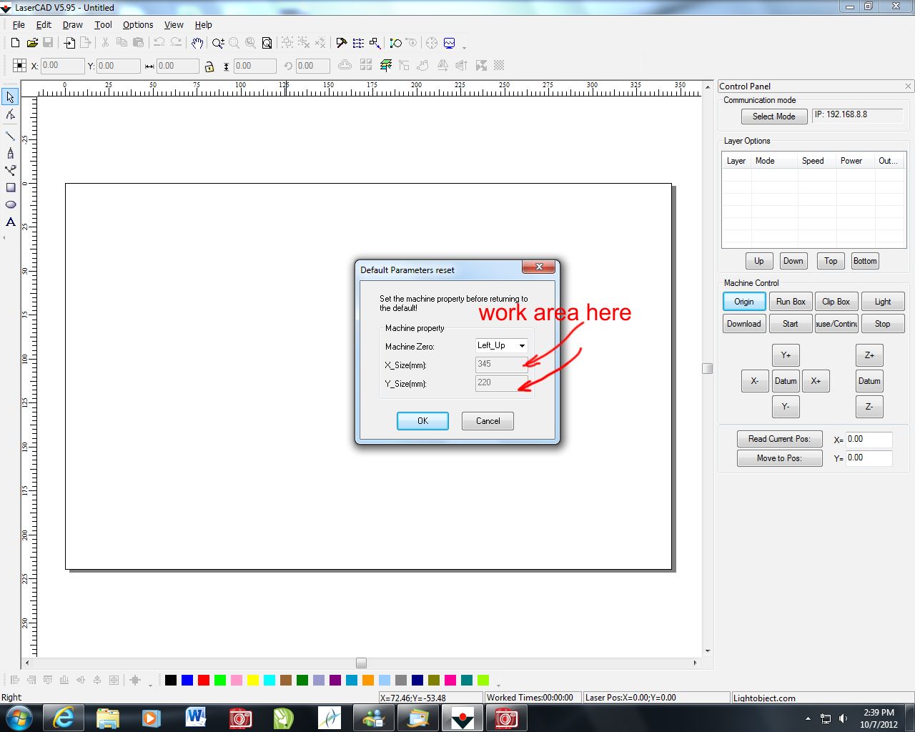

hi javier
see picture.
did you make the stepdriver adjustment?
if you need more avice just send me a PM at a542002@hotmail.com
see picture.
Javier wrote:If, apart from this problem I have other one that I show in the image. On having put in lasercad a unit of measure on having ordered it awc608 this one it me realizes it in other measures that do not correspond with the puttings in lasercad, but first querria to solve the problem of poque me does not return to the point of beginning thank you very much

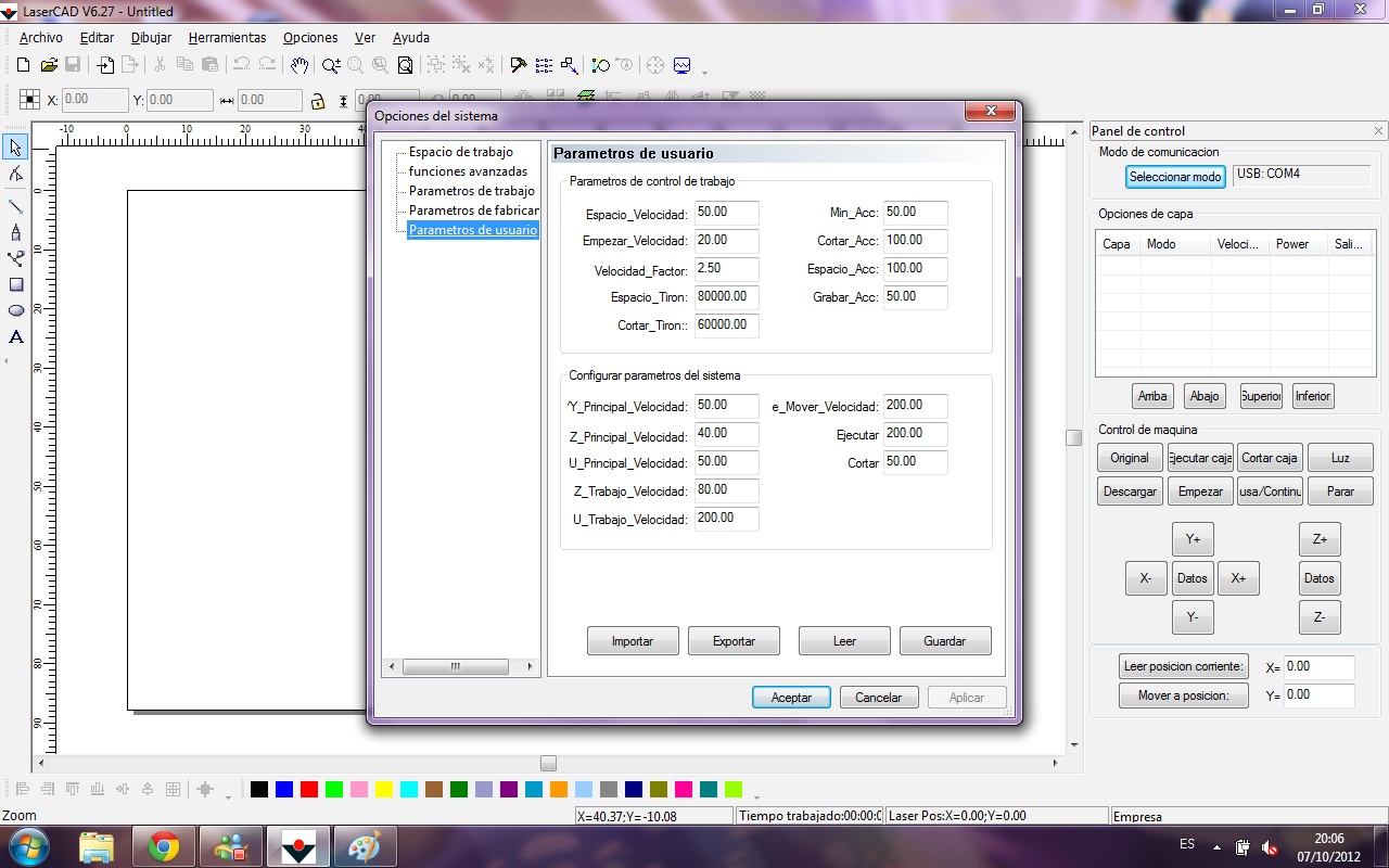

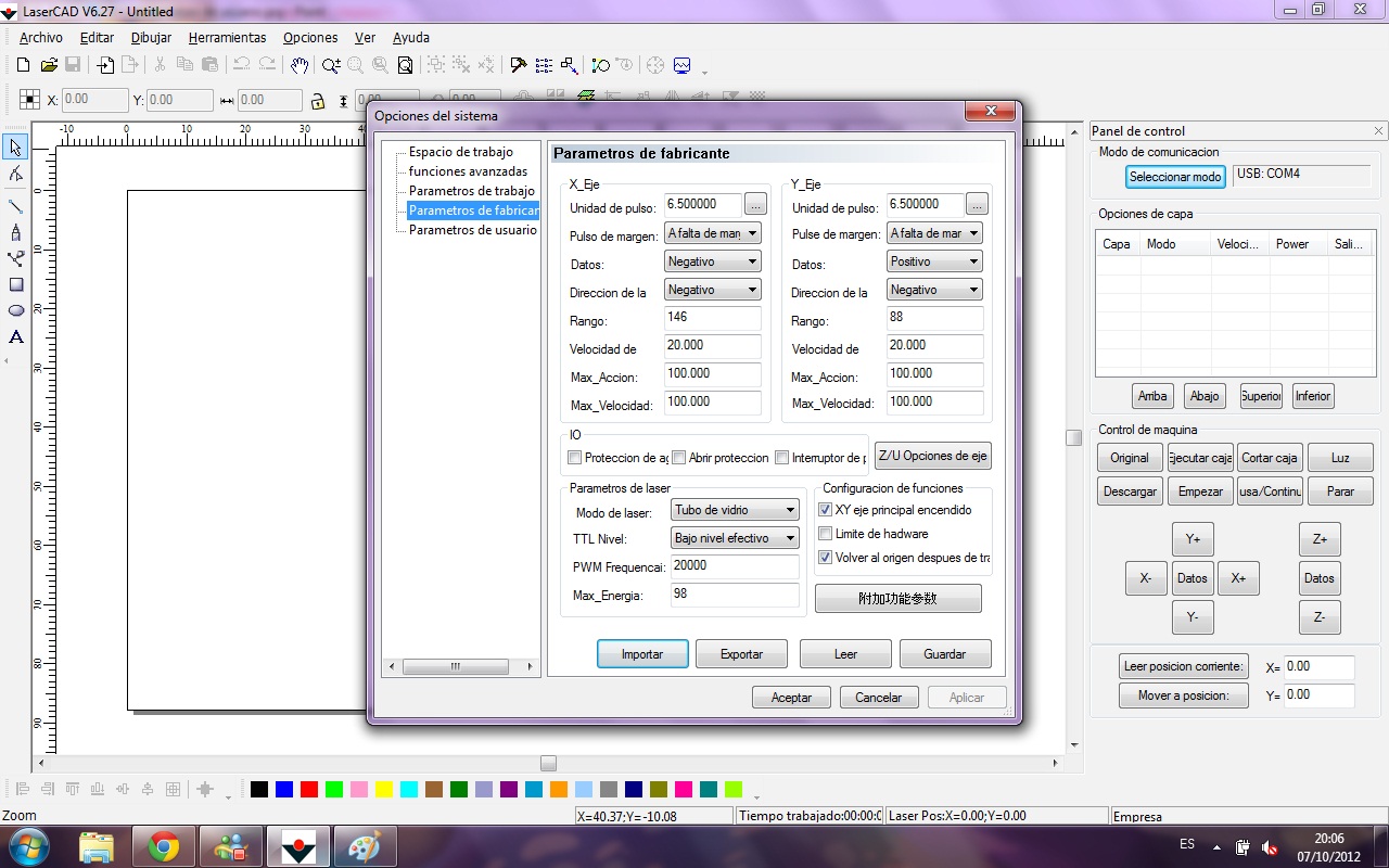

If also I have modified these parameters, I put the same ones 146x88 because it does not recognize me the royal ones that are 500x300,I am going to record a video and to hang it on the post to teach yourself as the machine it does not recognize the area of work
Re: Awc 608 Problems
Hi javier
did you safe the parameter??
best if you send the screenshots from the three what I have postet .
and what stepdriver and stepper motor you use.
make a 50mm square in lasercut then send it to the laser as cut with about 15% power and 50mm speed then measure the X and Y size
this are the parameter what you need to put in.
depends on the stepper driver settings which should be for beginning set to 3200 steps/revolution.
dont forgett to set on the display to software
Javier wrote:If also I have modified these parameters, I put the same ones 146x88 because it does not recognize me the royal ones that are 500x300

my steppers motor are dm542 and pulse in axis y is 1600 pulse/rev and axis x is 400 pulse/rev
Hi javier,
I just read that you dont have the DSP from lightobject what means you dont have the latest were the lasercut 6.27 programm is for
un installe it and manual remove all files after restart download the lasercut 5.95 and install it then it probably would work
Javier wrote:my steppers motor are dm542 and pulse in axis y is 1600 pulse/rev and axis x is 400 pulse/rev
