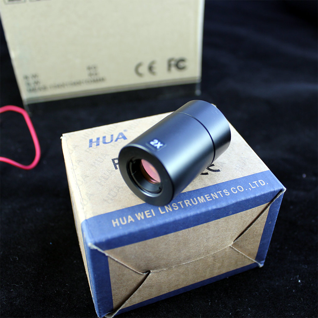

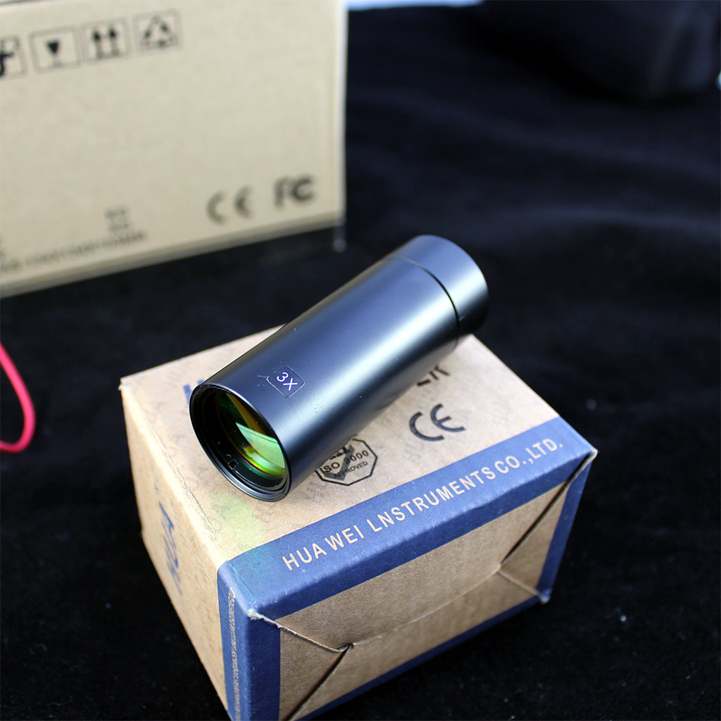

Tech_Marco wrote:See pictures of 2x and 3x beam expander

By diameter, you mean input diameter? Or the physical diameter?
The RECI beam diameter is rated at 8 mm, so that would make the output 16 mm with the 2x and 24 with the 3x. Juding from the pictures, the unit itself is 20-25 mm in diameter, so I doubt a 3x would work. Could you confirm.
Re: Beam expander + beam combiner
I think I need to take more picture to show you what is that as it could be considered as Input or Physical size. The 2X got small input hole but the 3x is bigger. However, there is a mount that make 2x smaller and if you take it out, it seems that it can take wider beam. I haven't had too much experience about the beam expander and I'll consult the manufactuer in next couple days.
I'm afraid that the 2X is not going to work with your 150W tube. The beam of 150W is about 10mm so 2x = 20mm. The output lens of the 2.0x has a diameter of 19mm. So, regardless the input is 10mm or wider, the output will be blocked. You may need toget 2.5X or 3.0x instead. I'll get more info tomorrow as I asked them to send me detail infofor the 2x and 3x. Now, I think I need the 2.5x as well. FYI, the bigger the number, the more power you will get.
By the way, what is the diameter of the reflection mirrors and the focus lens you're using? I think you have to have 25mm mirror and 20mm ZnSe focus lens (or even bigger like the 25mm)
Don't buy it yet. I need to order new one for you.
Reason:
2x: Input diameter: 10mm, output diameter: 10mm
3x: Input diameter: 10mm, output diameter: 19mm
It is not suitable for Reci 130W laser or higher tube. I need to get 10mm/25mm or 10mm/30mm beam expander. It will take about 2 weeks
