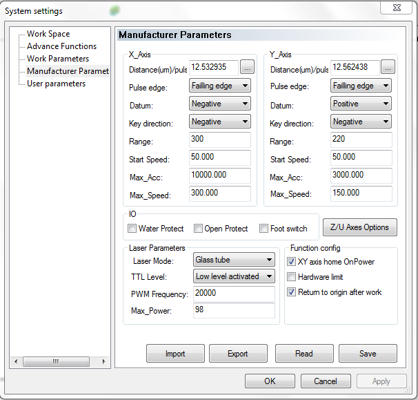

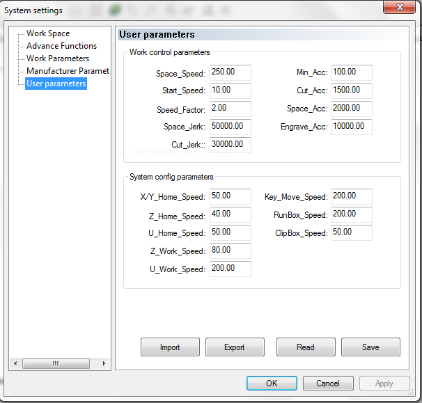

Run box will work but clipbox gives beyond size error
Re: Importing Objects/Engrave over size
Send me the "Manufacturer Parameters" and "User Parameters" setup screen shot to me for review.
Also, send me a screen shot of the LaserCad with the image. Try use either "Soft Origin" or "Machine zero" to test again.
Let me know the result

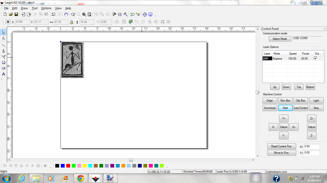

Thx again Marco. My pulse units are 12.532935 on x and 12.562438 on y. Perhaps I'm missing something in my settings . When you say your resolution is (1/16) 3200 where do I find this place to enter/change this information. Attached is just one of the files that I,m having a problem with. Before this update I was able to laser this image very successfully on 130mm x 150mm ply at 150 speed.

The 1/2,1/8,1/16,1/32... or 200,400, 800,1600,3200,6400....... it's the setting you have to do on the stepping motor driver. Nothing to do with the DSP controller or the LaserCad
After upgrade peformed on the controller, you may need to write back data to the machine as it may reset the Manufacturer parameters or the user parameters.
Usually I save a backup of the setting once the system is tuned and working properly.

Tried again as you suggest with Soft origin and Machine zero. Both failed at 34 secs
- abo3.pwj5
- (110.51 KiB) Downloaded 333 times

Do this: draw a rectangular of 200mm x 100mm and center it. Do cutting with speed set to 300 and power =15% (estimated) on a piece of paper. Then, measure the dimension of the of cut (or burned) on the paper. You may use "Simiulation" before do a real cut. "Cntl +" speed up the simulation. It shouldn't be causing the "Beyond size" error.
The scan image you attached is small. I'm wondering how could it be possible that it could cause the "Beyond size" error.
By the way, your HOME is Top Left, right? So, check the "Work Space" under Option and check see if Machine Zero and Paser Zero are having the same setup. If one of them reversed, it may cause a problem.
