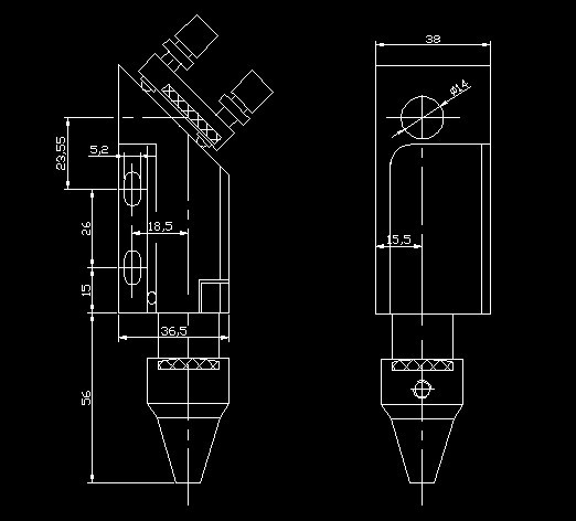

I just purchased the Pro Laser Head and I am trying to track down a technical drawing of it. I would like to know it's exact size, mounting hole measurements, length at minimum and maximum extension, etc. Anybody have such a drawing kicking around? I ordered http://www.lightobject.com/Pro-laser-he ... -P586.aspx
