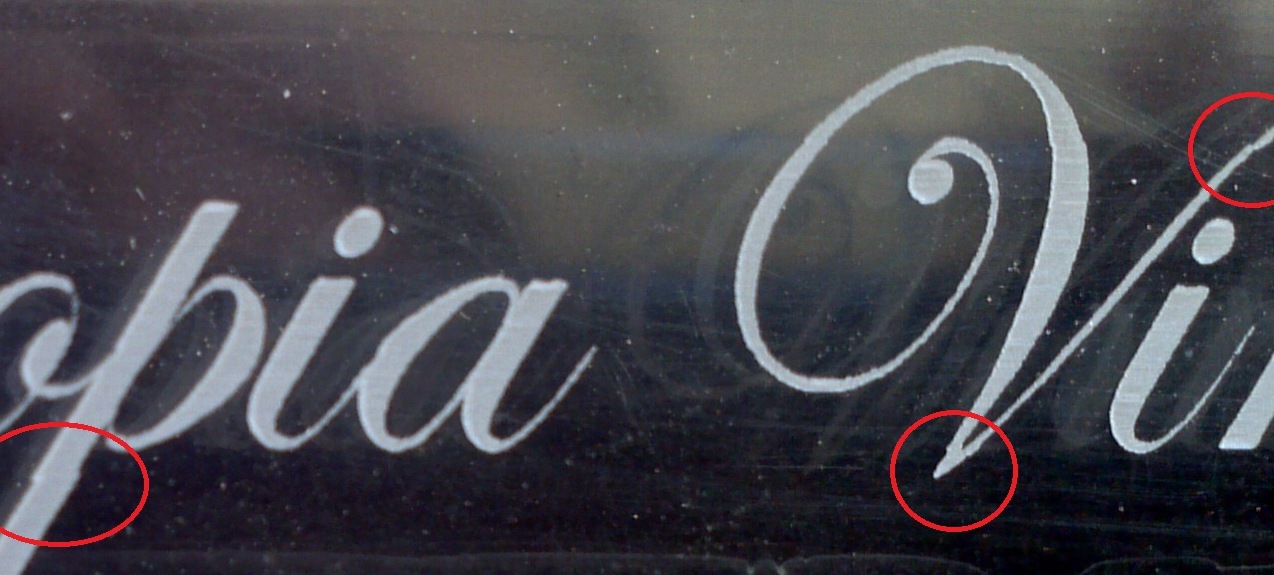

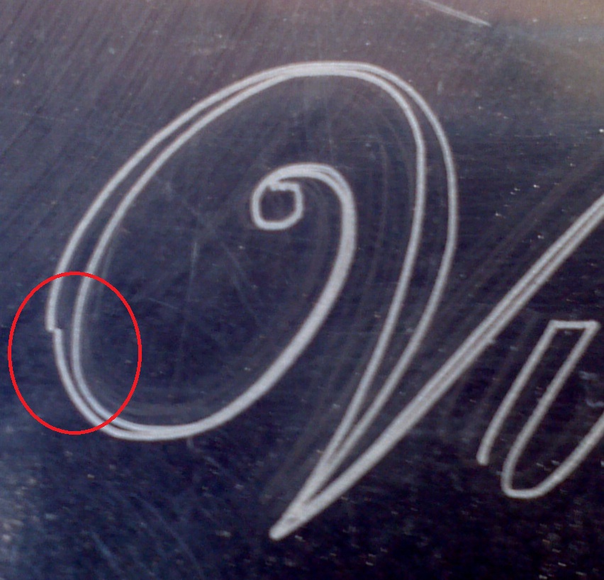

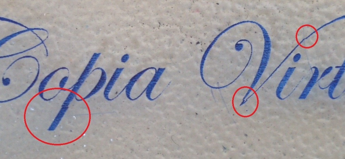

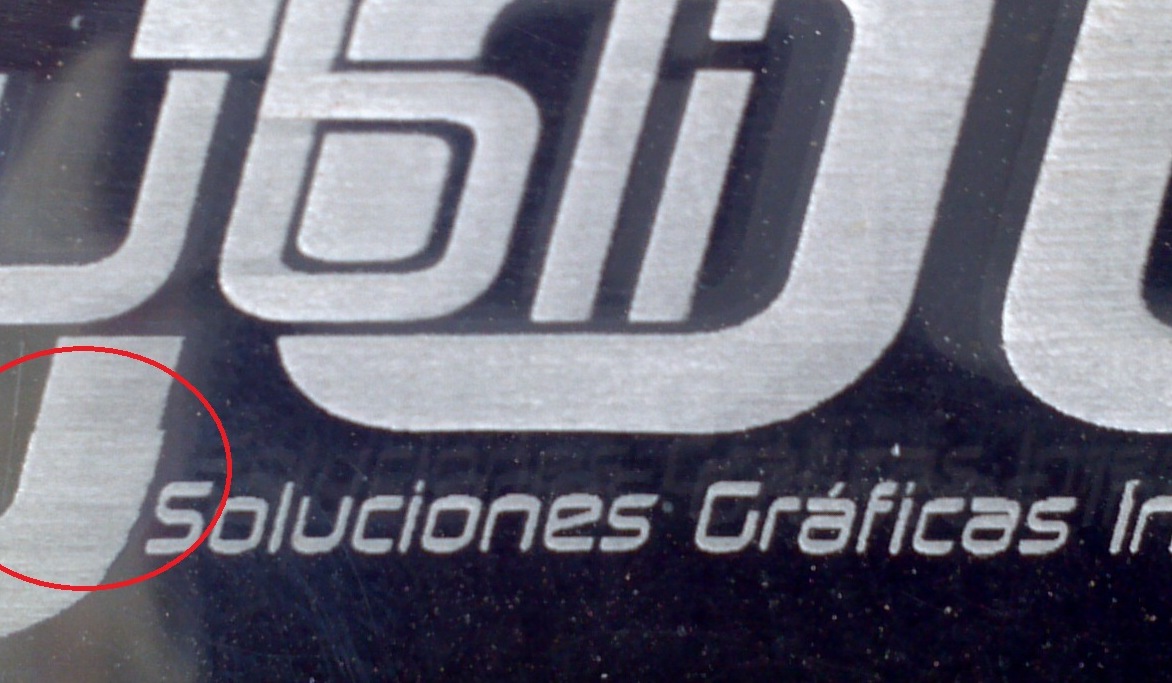

Hi everyone,
I'm running into some problems both in cutting and in engraving with the 2012 DSP, when doing vector cutting/marking I see the beginning and end of the curves don't match, the problem is very repeatable, it happens in the same exact place of the cut everytime it doesnt matter if I put the workpiece in a different place in the cutting table, if I mirror the image and try again the problem is mirrored too so I'm guessing its not mechanincal but who knows, it even appears the same when I increase or decrease the image size.
Now about the engraving problem, whenever I want to make a small engraving I notice some sections of the image look shifted from the correct position, this problem is also repeatable, it happens in the same place of the engraving everytime, I noticed the problem appears whenever the engraving changes in width, if I put a rectangle around the engraved image the problem seems to dissappear because the X travel remains constant, I'm attaching some pictures of the problem, I hope somebody has run into something similar or has an idea of how to solve it.

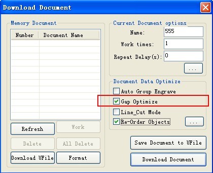

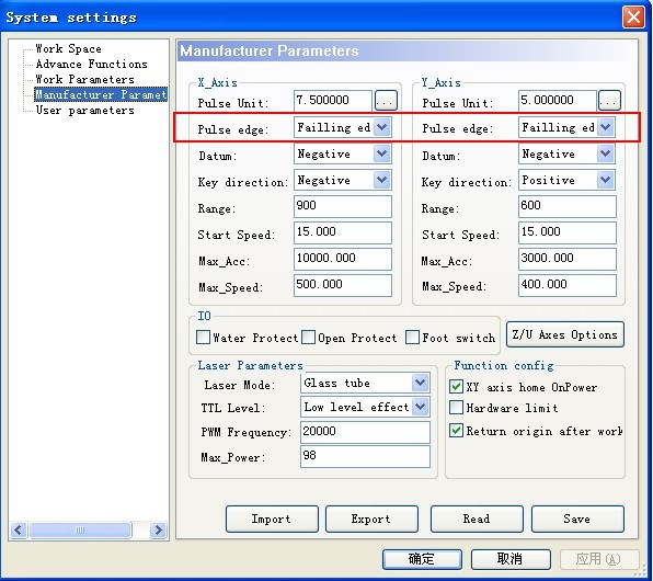

Please send me the .pwj5 file and I'll send it to the engineer for testing.

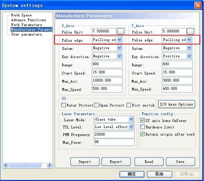

Also, please enable the "Gap Optimize" see if it help. Plus, change the "Pulse Edge" to other way see if it help also. See attached images. Let me know.

Re: Repetitive problems both in cutting and engraving
We tried but couldn't duplicate the problem on our machines. I'll launch another OS see if it help to fix your problem. It look like that it could be some 'compatible' issue as it may happen to a few users but not all.

By the way, I'm using leashine brushless servomotors and their drives, I understand servodrives usually have different pulse durations for the pulse/direction signals than stepper drives, but this problem seems to be happening to "artofmystate" too (sorry I don't know your nameTech_Marco wrote:We tried but couldn't duplicate the problem on our machines. I'll launch another OS see if it help to fix your problem. It look like that it could be some 'compatible' issue as it may happen to a few users but not all.

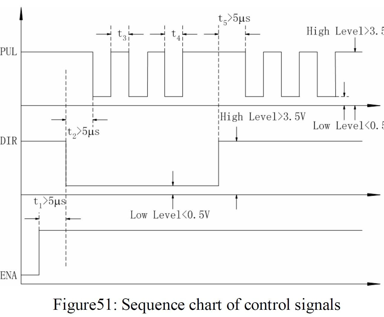

I know I'm asking a lot but it would be nice to have a singal sequence chart of the PULSE, and DIR signals of the DSP, that way we could make sure the servo/stepper driver is compatible with the DSP before we buy it, the chart I'm mentioning looks like this one from my leadshine driver:

Some update:
I've found that the "Gap Optimize" option in lasercad does eliminate the problem for me to a certain degree, there are still some graphics that don't cut correctly sometimes, but if I cut a file without the option checked I get a LOT more issues, does anyone know exactly what the gap optimize thing does? knowing that would help finding the source of the problem, I have 2 more machines to build right now and I'm going to use a different brand of servos, let's hope the problem doesn't show with them as Marco suggested it could be a compatibility issue.
Fernando
