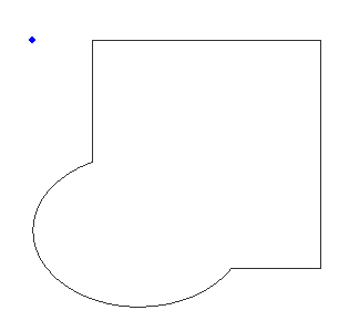

I tried a shape I made in Corel Draw with 2 20 mm sides just so it's not a simple square (see attached image)
Test Shape from Corel Draw
Imported to Laser CAD as a DXF
The two sides that were left 20 mm are the same sides that have been cutting too fast
With the circle in the bottom left everything appeared to cut the correct speed
Rotated the shape 180 degrees and everything appeared to cut at the correct speed
If there is anything else you want me to try I will get to it as quickly as I can
