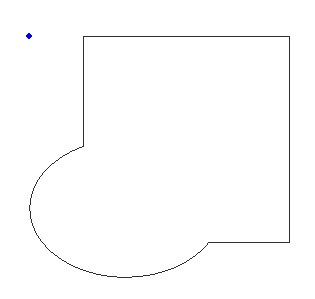

I tried a shape I made in Corel Draw with 2 20 mm sides just so it's not a simple square (see attached image) Imported to Laser CAD as a DXF
The two sides that were left 20 mm are the same sides that have been cutting too fast
With the circle in the bottom left everything appeared to cut the correct speed
Rotated the shape 180 degrees and everything appeared to cut at the correct speed

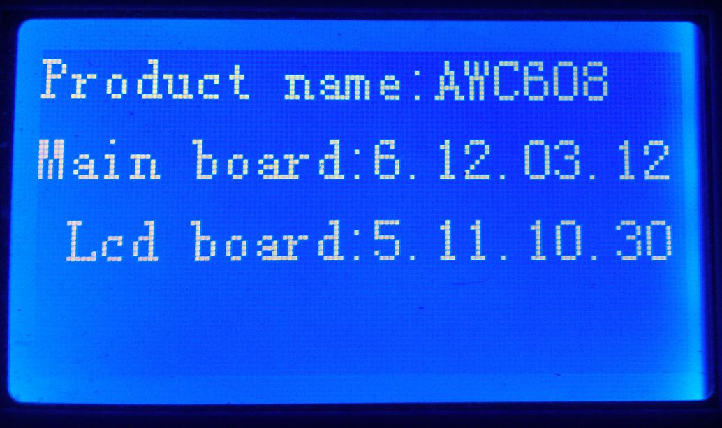

Chceck the version of the DSP. I already reported this issue to Li to look at that see if he could duplicate the issue

Rich, did you upgrade the OS on the LCD and the mainboard for the older AWC-608?
Can you send me the version number and I'll tell you which patches you may need to upgrade it.
To check the version, use the LCD control panale and scroll down to the bottom of the menu and you should be able to find "System version" or something like that. It will read two number for you, the main board and the LCD

System Version:Tech_Marco wrote:Chceck the version of the DSP. I already reported this issue to Li to look at that see if he could duplicate the issue
It's weekend there, so it may take a couple days before I can receve a reply from him
Main Board: 6.12.03.12
LCD: 5.11.10.30

Definitely you need to upgrade the DSP board as you're running older version. You need to run one of this patch before being able to upgrade other: viewtopic.php?f=55&t=941
You need to upgrade the LCD as well by using the attached file. You use the LCD to do all upgrade
Let me know if you have any problem to upgrade it. After, let me know what version of the system and we go from there

mattrsch wrote:System Version:Tech_Marco wrote:Chceck the version of the DSP. I already reported this issue to Li to look at that see if he could duplicate the issue
LCD: 5.11.10.30
Did you miss something? I think there is more after ".12". Didn't it show "V6,V7,V8" after it?

Nope, That's all it saysTech_Marco wrote:mattrsch wrote:System Version:Tech_Marco wrote:Chceck the version of the DSP. I already reported this issue to Li to look at that see if he could duplicate the issue
LCD: 5.11.10.30
