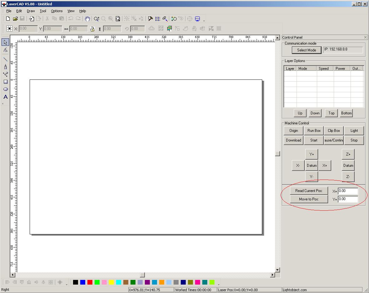

New LaserCad V5.87 just completedI'll post it soon. Now it allow you to use LC to read your current location and then you can set a new location you want the machine to move toward to by enter X,Y number. Plus, if fix some bugs; single chars issue and naming file issue.

Hey Marco,
Great, moving to desired position is indeed great, if you fill in the new position is it then the absolute position? or is is plus the old position.
e.g. the previous position is x 200 and y 225, i enter new position x 300 and y 400 , is that then the new position? , or is x500 and y625 the new position.
Further by publishing the new software can you also add a list with all bugfixes and new features..?
Ruud

The position is in "absolute" position. So it's neither increment or decrement the step but will travel to the true co-ordination.

Read your current position and move the position anywhere. More precise than using LCD keypad.

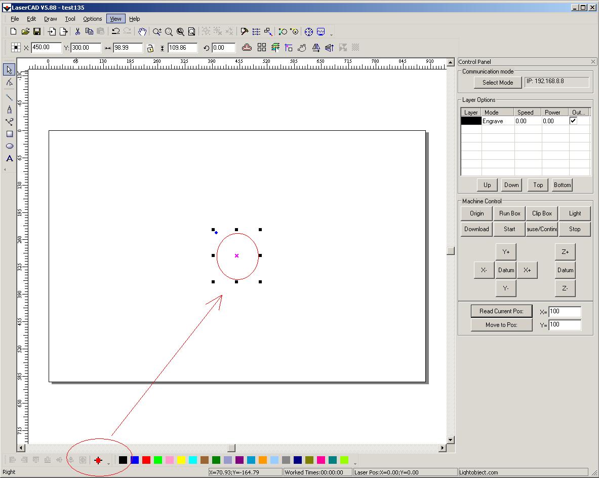

Centralized image with 1 click

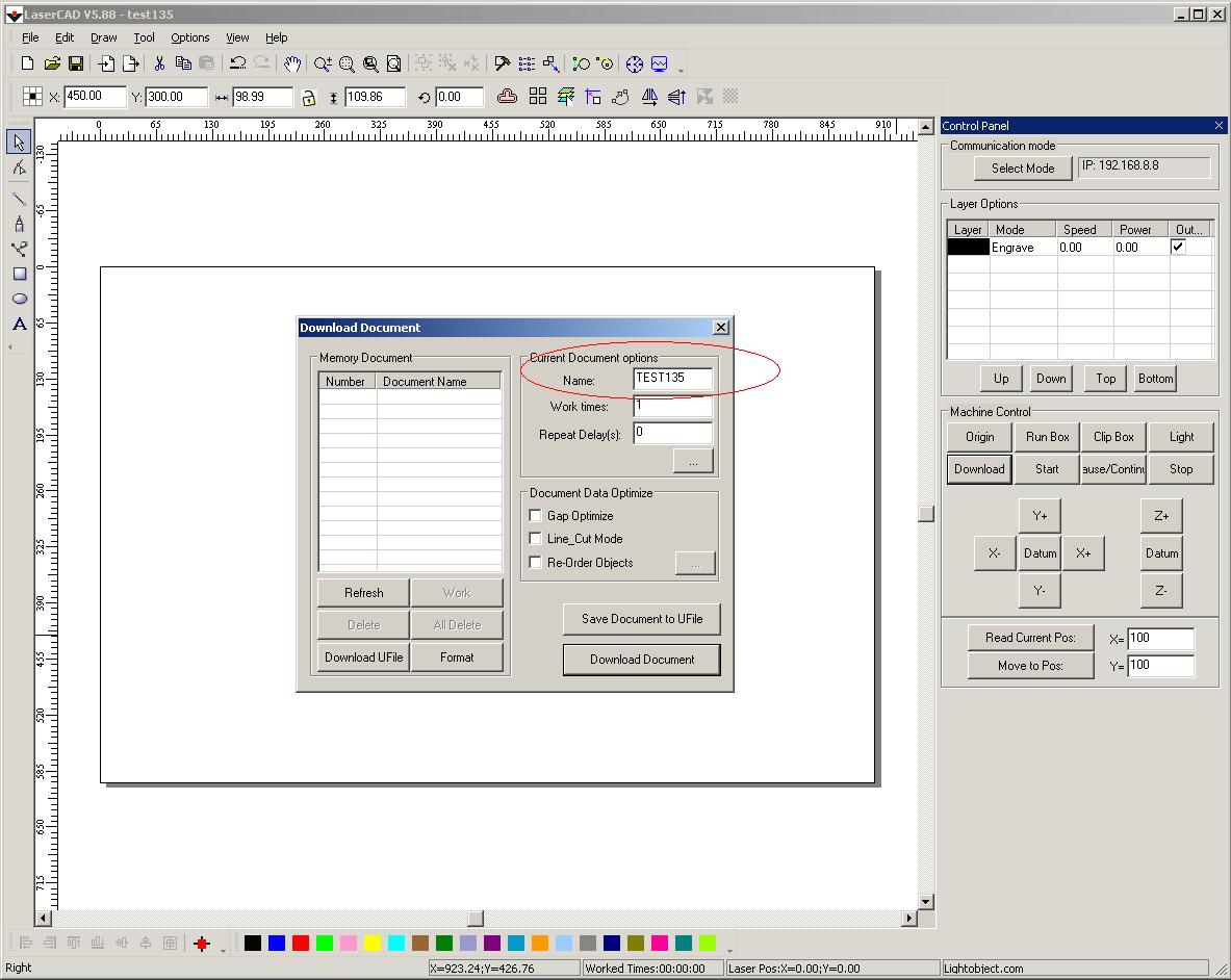

Now the work file name  (.pjw5) and the job file (.UD5) was the same. Also, it's no longer case sensitive. Before Test1 and TEST1 were two different file. Now, it's the same file

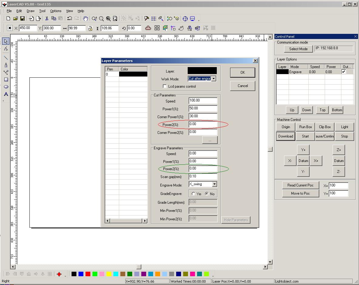

Now you can control the  the power level on Laser2 output. Before, the power % was the same as laser1
