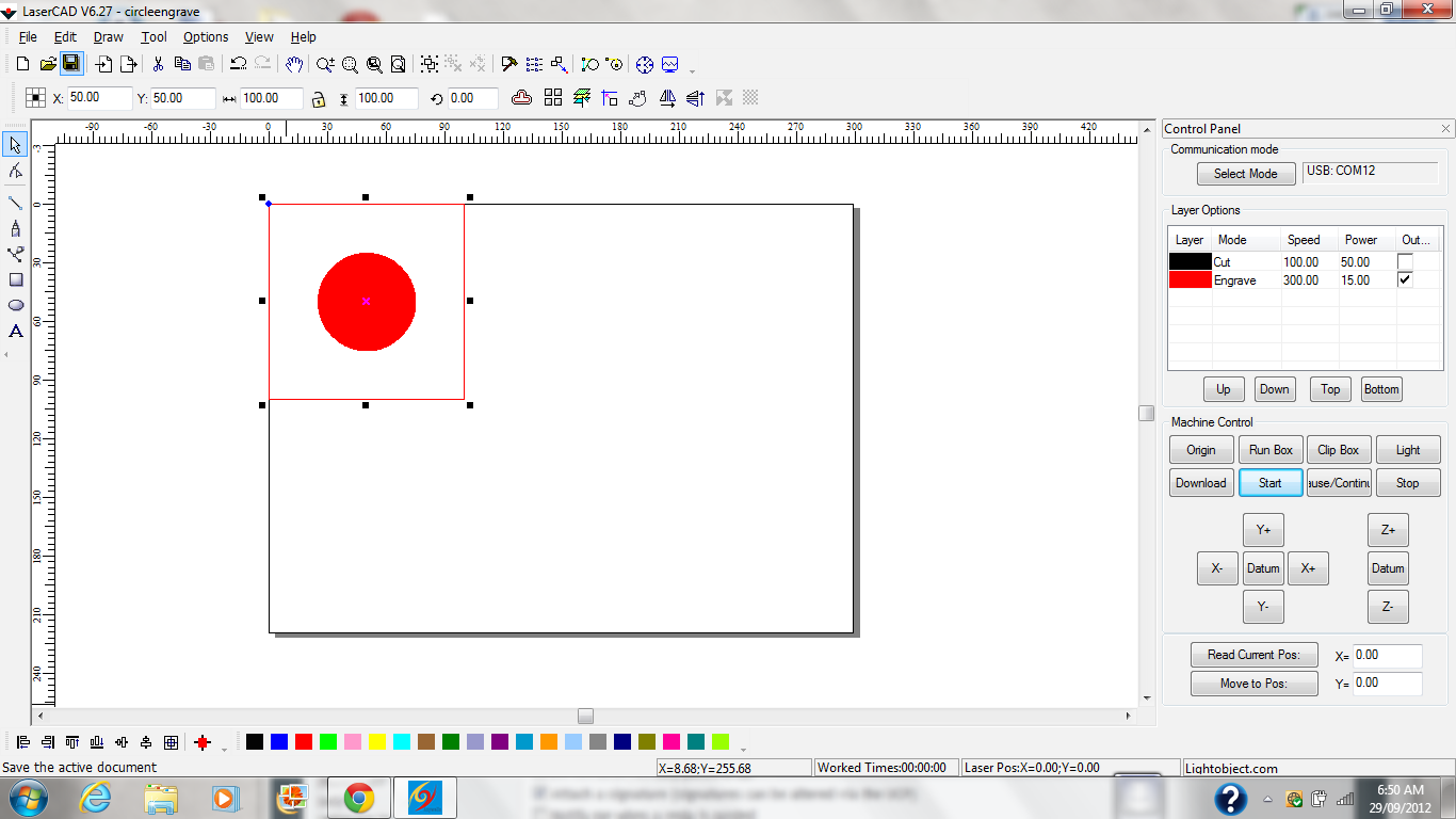

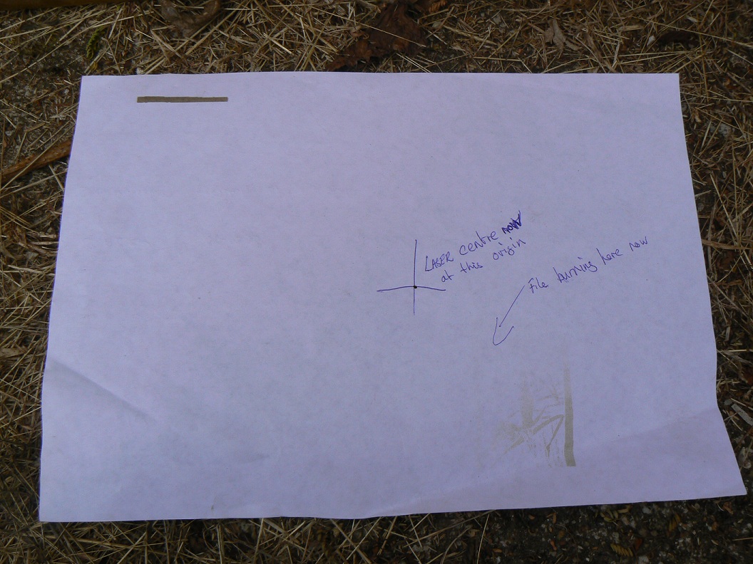

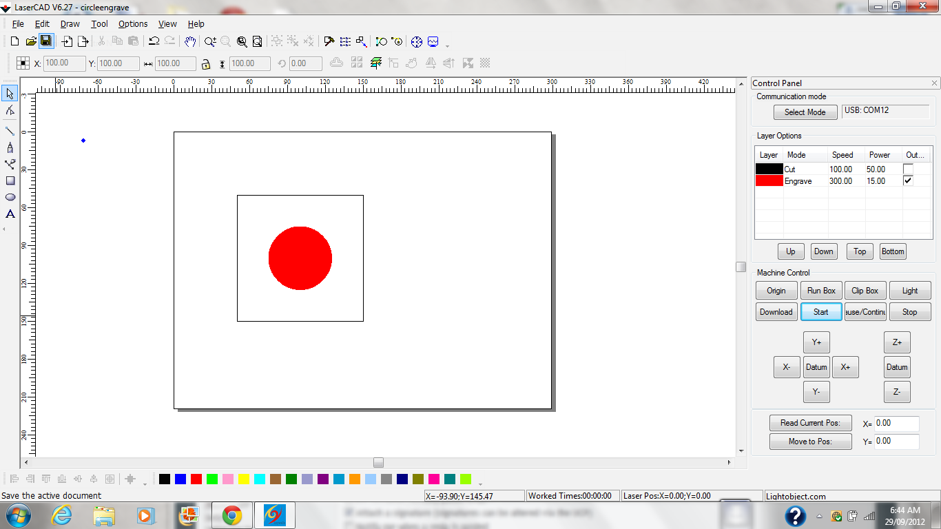

ok, sorry for this hassle Marco, my workmate came over and we've went through and reinstalled everything again , recalibrated etc. (no change AFAIC see)
re previous post.. Travelling the x-y gives (0,0) ,(300,0) , (300,220) , (0,220)
I,ve done the little exercise above. The attached files show how the job was set out but #2 file depicts how the laser printed on my work area. Seems the only way I can place an object is too draw a virtual box around the object and uncheck it in the Layer Options. Then it prints with a correct relationship to (0,0) As for this exercise the circle engraved properly and took 00.03.22 The LCD screen displayed the correct info when the job was printing
