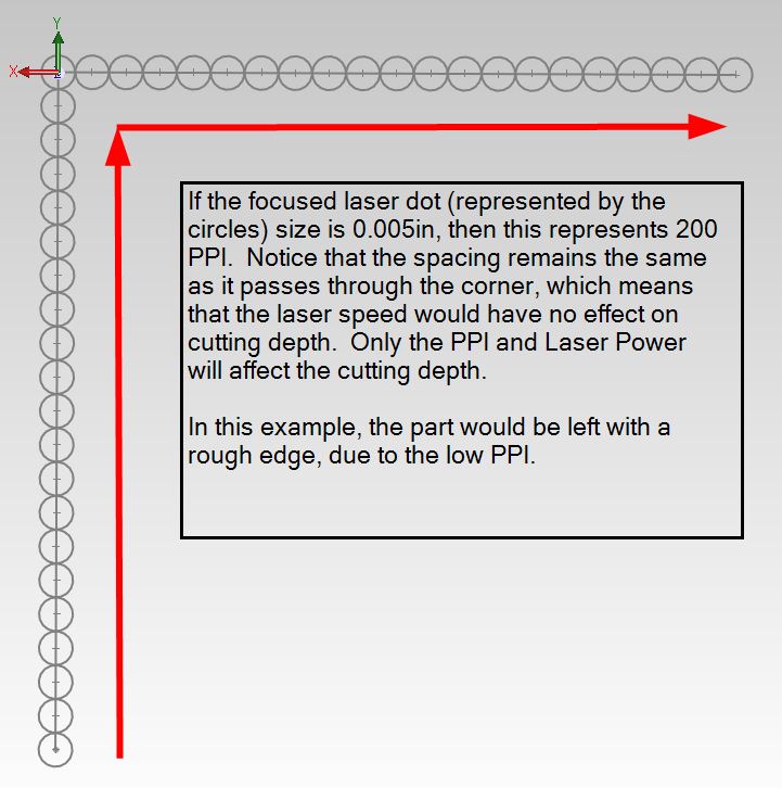

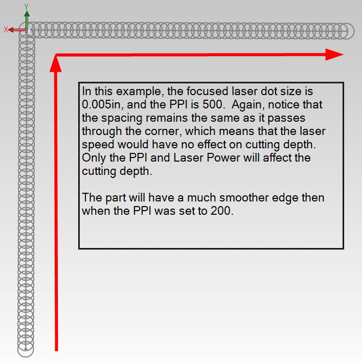

In addition to the reduced charring mentioned above, another benefit when cutting thicker material is that it reduces distortion of dimensions. The burning is more controlled, especially in changes of direction, where the laser stays for a longer period of time due to deceleration and re-acceleration of the head.
It also reduces the extra wide kerf where the laser starts and stops.
It's important for engraving glass, in order to reduce the production of shards due to excessive heat. With PPI, the laser is blasting small pits in the glass, rather than a long trough which tends to create shards. So PPI should be available for both cutting and engraving modes.
I also believe that PPI controls heat in the corners better than adjusting the "Corner Power", because the laser is being pulsed by distance traveled, so the amount of time it takes to decelerate and accelerate in a corner is irrelevant. Anyways, I've noticed that adjusting "corner power" to the point that the corners aren't burning, will then result in inconsistent power between curves and straight lines. I think PPI should replace "corner power".

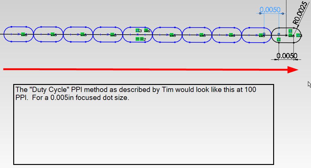

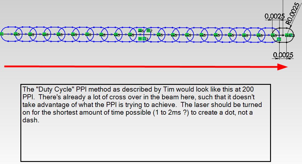

Tim, are you certain that the "Duty Cycle" spacing that you described is what you want. My understanding is that you want to pulse the laser for the shortest amount of time (1-2ms, or whatever the fastest response time is). So for 100PPI, the laser would be pulsed (turned on and off as quickly as possible) every .01in. This would create a perforated pattern, rather than a dash pattern, and distribute the heat better. The first 2 images below show what the "Duty Cycle" pulsing would look like with a laser beam diameter of 0.005in.
The images below represent examples of cutting a corner using PPI, at 200 PPI, and at 500 PPI. The important thing to notice is how the pulses allow the heat from the laser to be varied along a path, independent of the speed along the path (to an extent). Theoretically, each pulse should go about the same depth, so the part can be cut by increasing the number pulses per distance until the pulses overlap.

Engineerable wrote: Tim, are you certain that the "Duty Cycle" spacing that you described is what you want. My understanding is that you want to pulse the laser for the shortest amount of time (1-2ms, or whatever the fastest response time is). So for 100PPI, the laser would be pulsed (turned on and off as quickly as possible) every .01in. This would create a perforated pattern, rather than a dash pattern, and distribute the heat better. The first 2 images below show what the "Duty Cycle" pulsing would look like with a laser beam diameter of 0.005in.
I have learned to never be "certain". And in this case, I am certainly open to learning from those who may have more experience. Your method may be easier to implement, as it is a bit less demanding of clock cycles - keeping the "on" time constant and only calculating the time between blips.
In a version of the software that came with a much earlier version of the card, they did, in deed, have perforation mode available. I really liked it - made great dot-to-dot drawing for the grandkids when spaced at about 1" apart. I think I mentioned that mode in an earlier post on this topic.

Has anything happened with integrating PPI in the controller. I can't wait to cut wood without charring the edges.

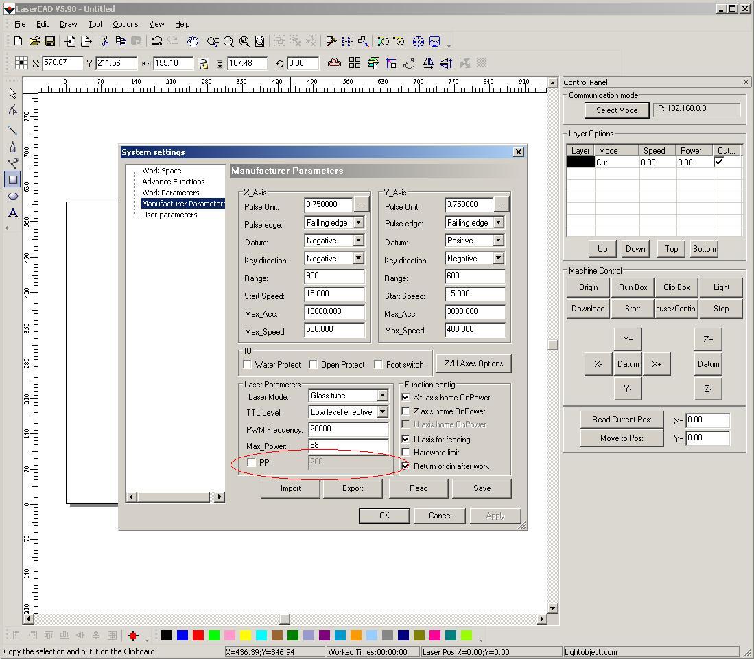

Update: V5.90 with PPI is ready. Li is doing test on the upgrade patch for the DSP card. In order to support the PPI, the mainboard need to be upgraded. I'll post both software and the patch once he completed the test.
His forumula:
For every 25.4*1000)/(2*PPI) um (distance), signal level reversed.
PPI = Pulse per inch
inch = 25.4mm
mm = 1000um
Re: 2012 DSP Feature Request : PPI
PPI completed and available to download from there:
viewtopic.php?f=55&t=1095&p=4030#p4030
Post by bluewave65 »
Works fine, but i don`t understand why is ppi setting located in that area ???????
It should be in lasercad layers section to set each layer with another ppi setting ...........
