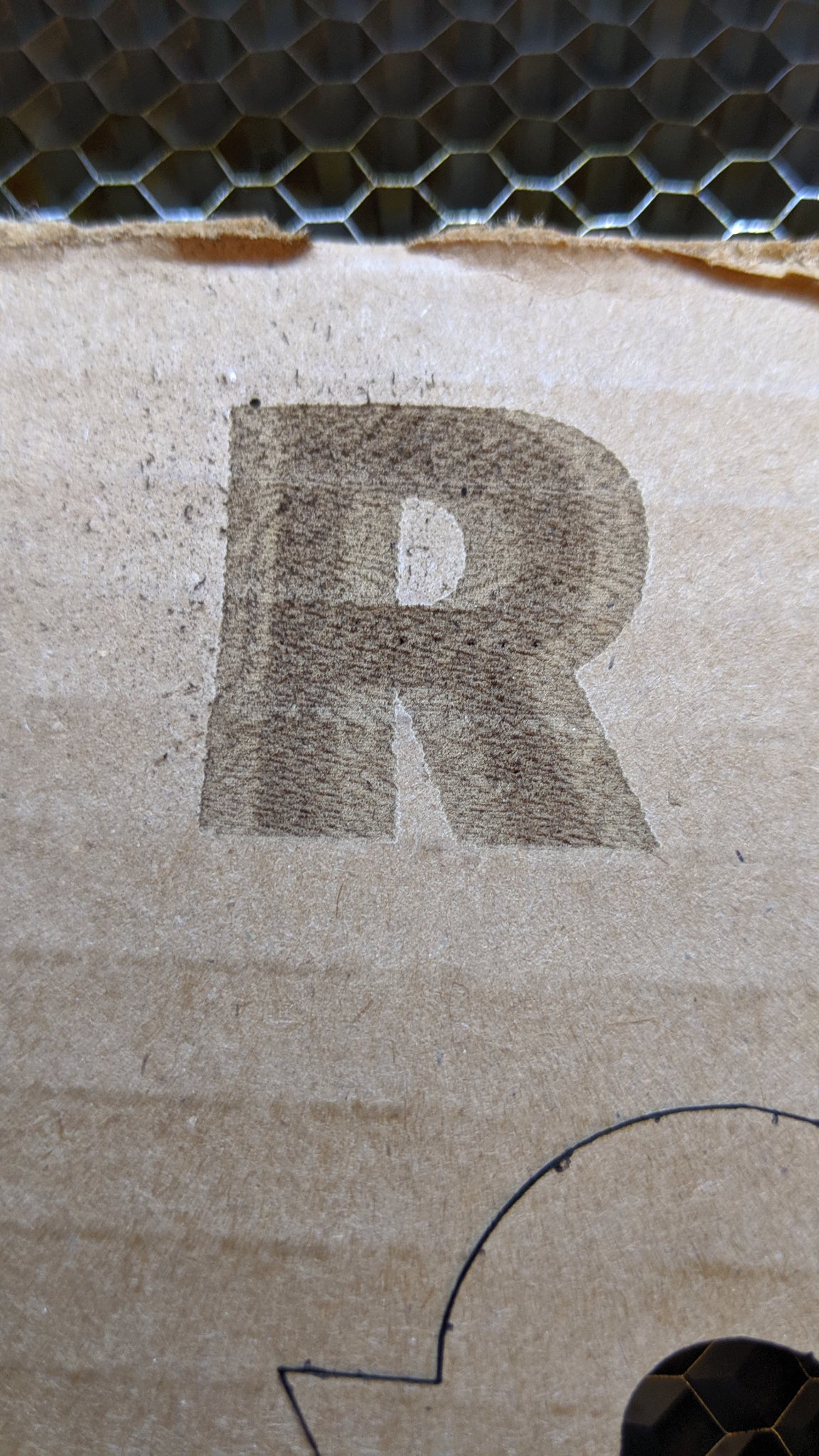

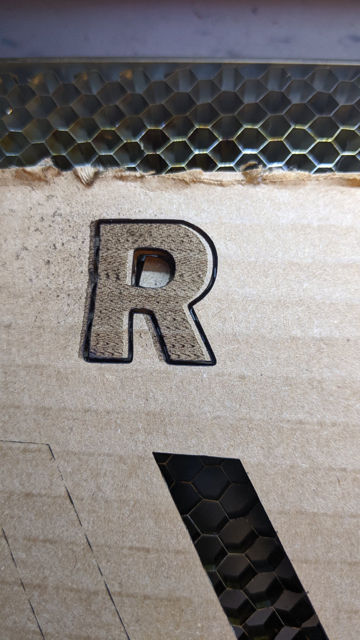

Ok, I ran one more test before shutting everything down. I am still getting double images and misalignment when cutting after engraving.
I've uploaded two images, one that was an engrave using X-unilateralism and then a cut function and it cuts slightly off the engraving. The second was only engrave but using X-Swing.

Hi Marco, Merry Christmas, Happy Holidays! I wanted to let you know the suggestions you made have been very helpful in making the laser more functional, I trust it allot more to get the jobs done. I was hoping you could help me fix the last issue I'm having. As you can see in my last post I'm getting a double imagine when I engraved in X swing mode and can't do a engraved then cut function because they don't line up correctly. I have to engraved then send a seperate cut function to the laser and move the origin point to the right about 1.5 mm to get it to line up with the engraving and then execute the cut function seperate.
Thanks for any help!

I think it is hardware issue.
It could be one of this issue
1) Motor
2) motor driver
3) Loose gear
Solution
1) swap X&Y motor or get a new one
2) swap X&Y driver or get a new one
3) Double check the motor gear. This issue is hard to troubleshoot and you need to test it with a bit of patient. Power up the laser machine and both XY motors should lock up tight. Then, push belt or turn the heat by hand see if you can find the loose part. Again, this problem is hard to find and take long time to troubleshoot.
