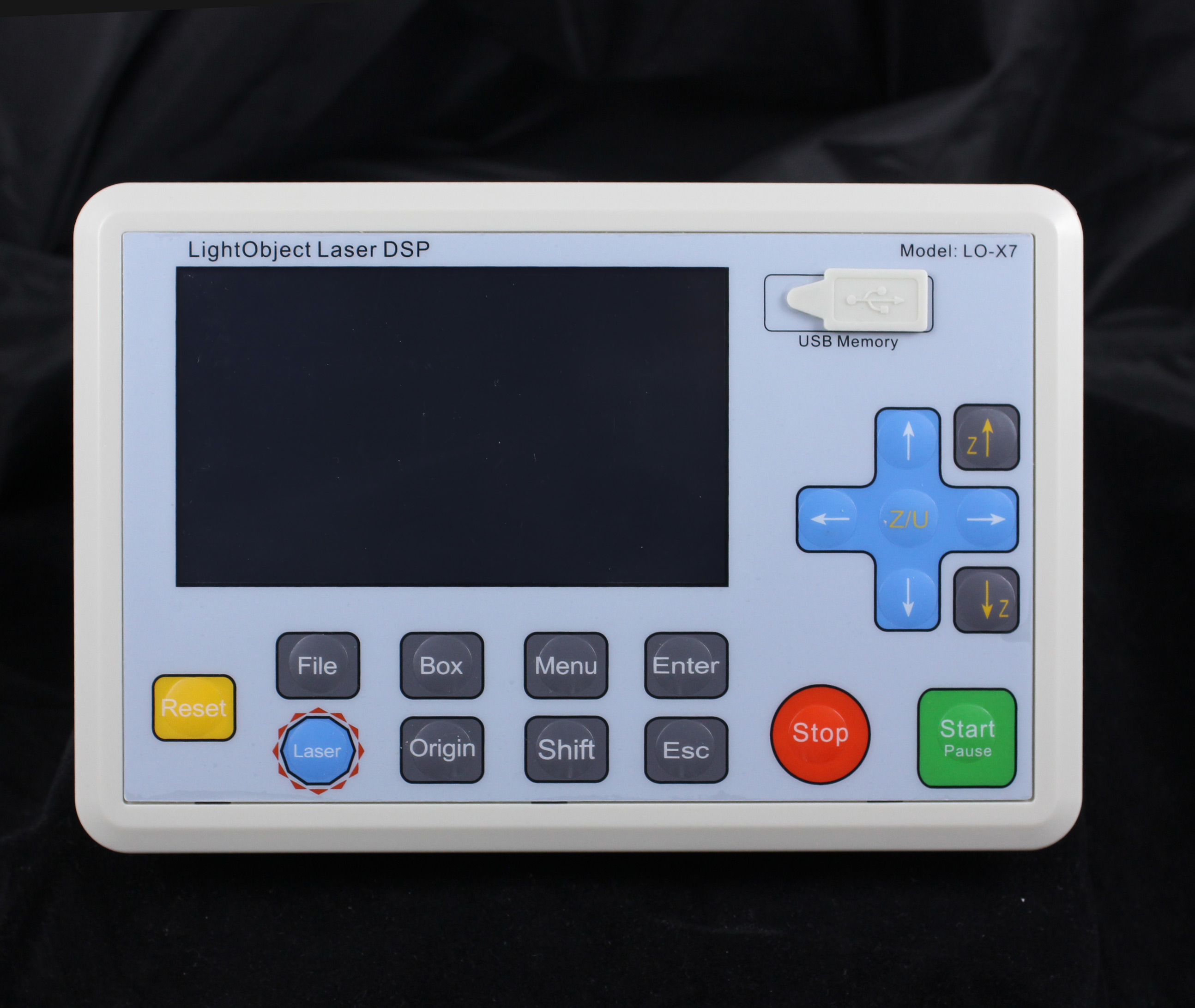

Re: New LO DSP controller card with Dynamic Color LCD V7
The new layout looks clean. I like the separate Z+/Z- buttons.
In fact, I'd like to plan to replace the AWC608 with this when the time comes.
- Is the cutout for the display the same as the 608? If not, do you have a footprint for it yet?
- Is the DSP itself the same size as the previous one? Are the connections in the same or similar locations?
I know you're mostly looking for display feedback, but here are my top controller requests:
- A delay-start, to give the exhaust time to come to speed after you press the START key and before the laser fires first time.
- A way to disable (or make it hard to use) the LASER button on the panel. I intend to let high school robotics students use my laser (supervised), but I don't want anyone to manually fire the laser unless they know what they're doing.
/Mitch.
The 2.5D is where I am most interested. I would love to be able to engrave 16 or up to 256 shades of grey for a great 3d effect or fine details in pictures so I can engrave granite headstones or plaques.
* This is my most wanted thing for a laser.
The panel looks fine as it is and is uncluttered.
A 2 button press for laser firing is a good safety idea too. I don't need it but can see the benefits for the schools etc.
I'm pretty happy with everything else as it is. I've had other software and this hardware/software for me is just the "bees knees"
Keep up your great tireless work Marco. I try to send people here as much as possible.

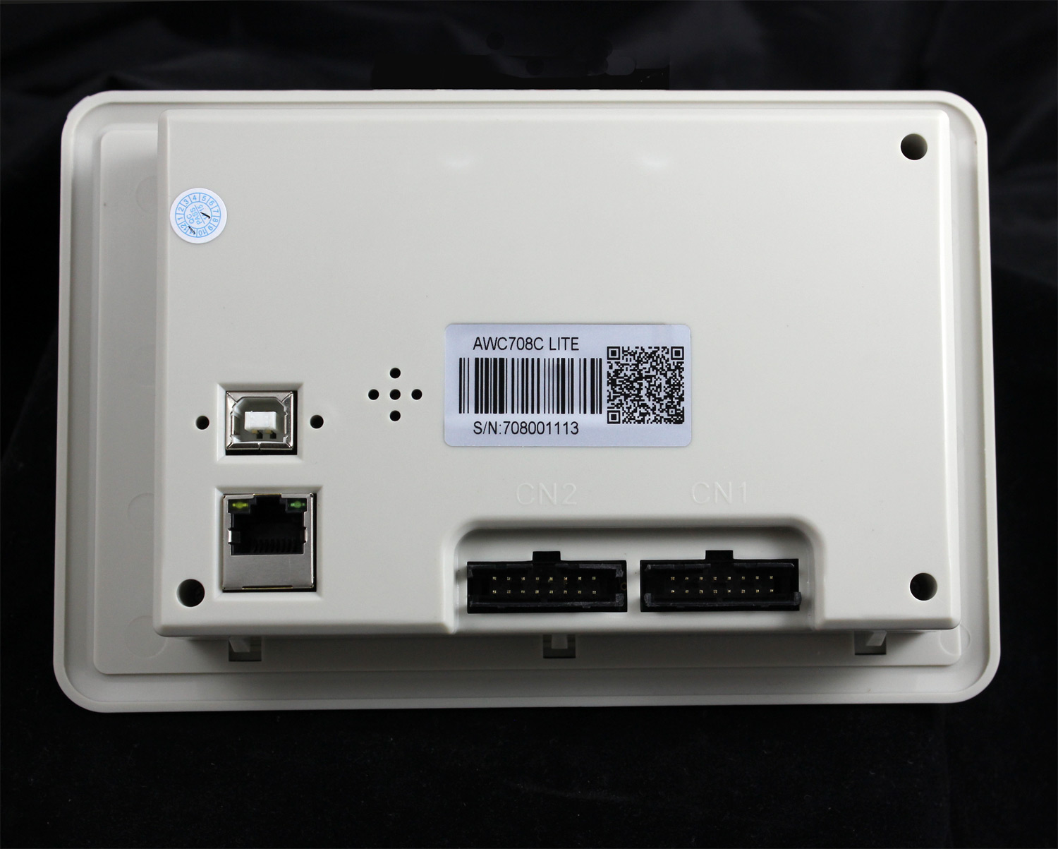

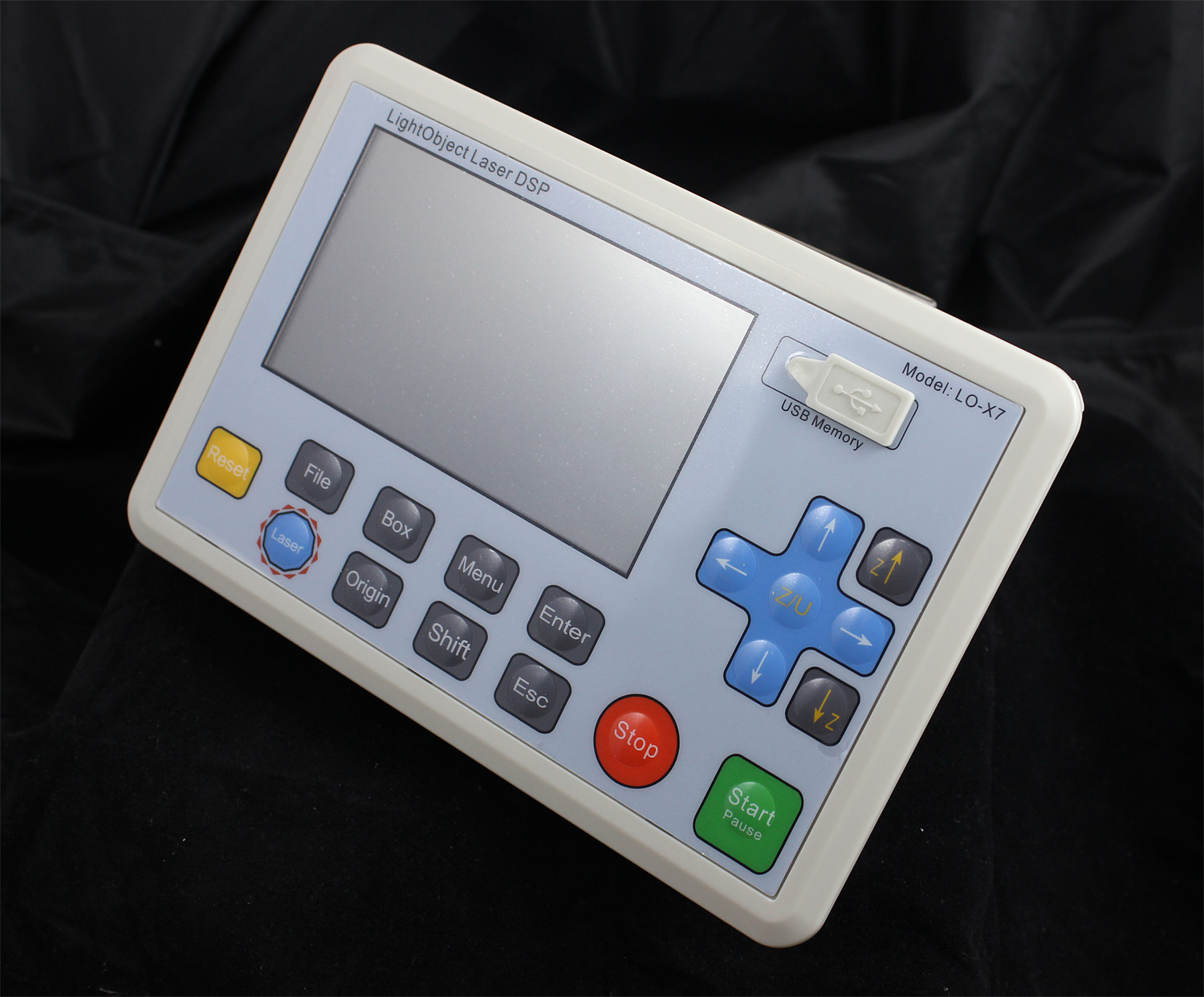

Ladies and gentlemen, here we come the latest color DSP!
Cool, looks neat!
I still haven't cut the opening for the DSP for my laser yet. Do you have a drawing of the display's cutout? I'm hoping I can make a cutout that would work with either display (3D printing a bezel for the 608 if it's smaller).
(I know a CAD model isn't going to happen, but have you measured your samples?)
/Mitch.
Wow! That looks really good! I really like the USB port on the controller. If the new DSP will engrave grayscale I will definitely buy two!
I'm finally getting around to installing the 708C (upgraded from the 608) in my laser.
I have it powered up on the bench (but not installed in the laser) - initial impressions:
- The color screen is fast and clear. I like how quickly it responds to the buttons compared to the 608.
- The user interface initially comes up in Chinese (sure, why not?) Press Menu, go to option 9, then press <- -> to select your language of choice (or stay with Chinese if that's your language!)
- There's a time-of-day clock on the screen that I can't figure out how to set. Perhaps that's settable in LaserCAD.
- The layout of the connections on the DSP box is close enough to the 608 that it should be a snap to install. The only recabling I'll need to do is to move the USB and Ethernet pigtails to the back of the control panel.
- There are two connectors CN1, CN2 on both the display unit and the DSP, but one cable supplied. I've connected only CN1 assuming the others are for future use.
First problem I ran into was the USB driver - the 64bitUSB_Driver.rar is identical to the one for the 608 but is not recognized. The 708C looks like a VCOM device with USB VID/PID 1FC9/0083 - this is an NXP VID. I installed this driver:
http://www.lpcware.com/category/file-types/driver
Then forced Windows to use this driver for the 708C in the Device Manager. It seems to be able to talk to the 708C now, but this is not ideal (Marco? Is there a different driver we should use?)
I'll copy the axis parameters into the 708C later today and see if I can start cutting stuff.
/Mitch.
