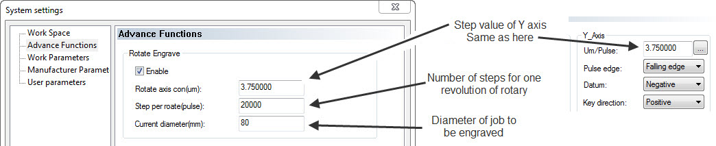

The "Rotate Engrave" function found under "Advance Functions" does work for raster engraving (back and forth like an inkjet printer) as shown on your second youtube.
All you need to do is enter the correct values and enable it. See pic. below.
However unfortunately that function does not work for vector cutting or vector engraving (as shown in first youtube) It only works with raster engraving.
So what we must do for getting vector work to come out correct size is enter the appropriate step value in the Y axis step field.

The first entry in the "Rotate Engrave" is whatever is the step value for the axis being replaced by the rotary. Y axis in most cases.
Once this first entry is entered, it should under normal circumstances never need to be changed. See Pic below
When using this feature you DO NOT alter the Y axis step value in "Manufacturer Parameters". Leave it untouched.
The second entry is the number of steps required for the rotary to turn one full 360 degree rotation. You must calculate this value for YOUR machine.

Once it is entered it should under normal circumstances never need to be changed. See Pic below
The third entry is the diameter of the job to be engraved in mm. This will need to be measured and set for every job.

So 20,000 is entered in the second field. (or the number of steps for YOUR machine)
