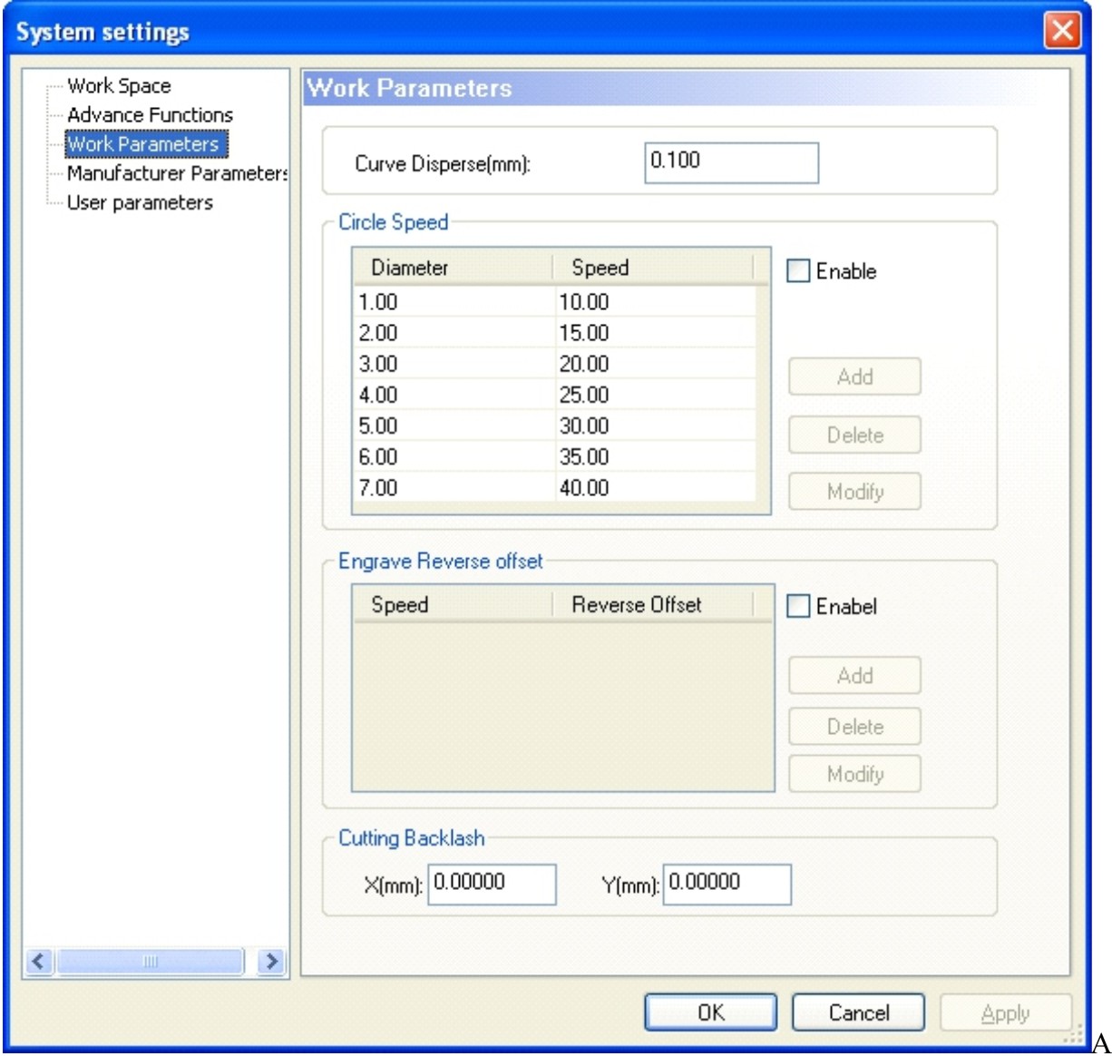

You may want to try adjusting the "circle speed" parameters in the system settings. The manual states that these settings can "greatly improve the circle cutting quality".

any suggestions? Its been a long time since I looked at the original manual

Start by enabling the feature and use the default settings.
If it makes a difference you can tweak the settings for better/best performance.

thanks for the tips Rad, I'll try it out.
