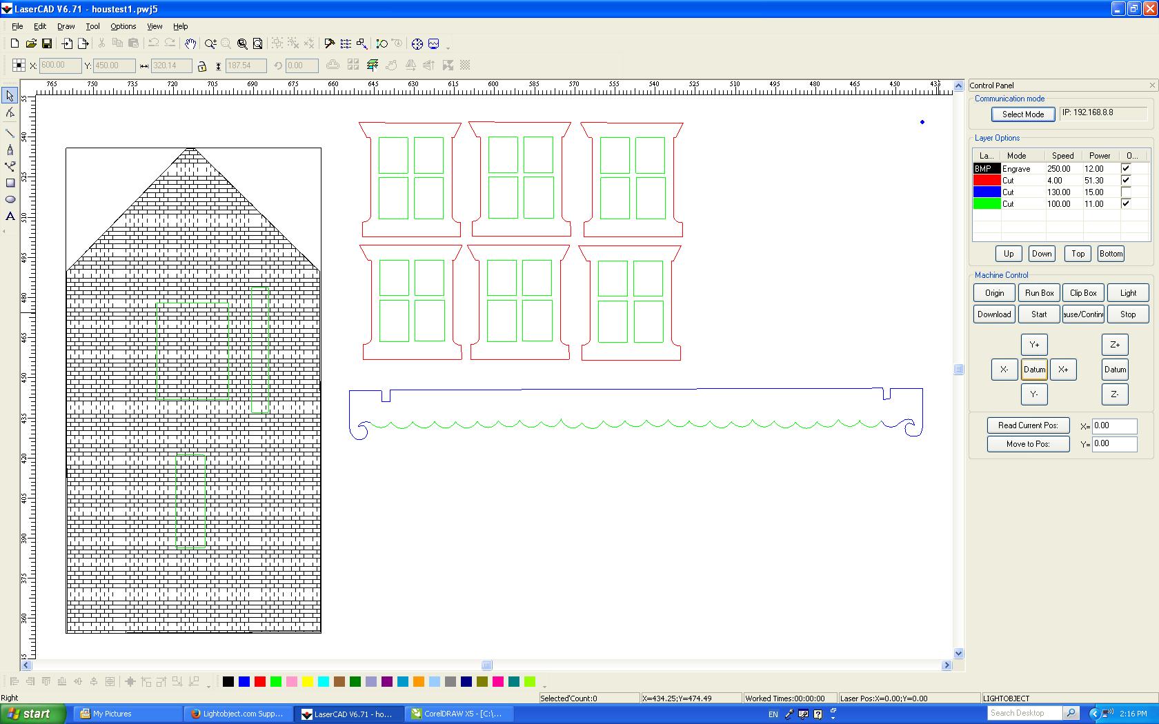

now I got a problem or maybe probably is that if I insert a pattern in a object lets say the roof tile pattern in a house roof in CorelDraw x5 and send it then to lasercad the pattern shows up as square not in the form the roof is.
maybe marco can ask the programmer why tis is and how to fix it.
pattern inserted in a object in corel comes out as square in

Have you just simply converted it over to a DXF and then loaded it? I've had 0 problems with DXF's so long as they are AutoCad made or Corel converted...though loading CDR's and AI's have been almost always an issue.
Re: pattern inserted in a object in corel comes out as squar
No I never convert from corel to DXF I always send it directly to laser cad
attached are the two files one is the original CorelDraw X5 file and the other is the lasercad file
Axeman wrote:Have you just simply converted it over to a DXF and then loaded it? I've had 0 problems with DXF's so long as they are AutoCad made or Corel converted...though loading CDR's and AI's have been almost always an issue.
- houstest1.pwj5
- (1.33 MiB) Downloaded 174 times
- housetest2.cdr
- (95.39 KiB) Downloaded 172 times

Oh I saw this problem show up elsewhere in the forum, it was how you removed the pattern from the 'front' shape that was the solution. I believe if you went the longhand route...I can't recall exactly what it was, but if you did "minus front/back" method it would remove the pattern properly and this error wouldn't show up.

no this does not solve the problem I try all of this but in the moment where the file gets to lasercad it changes it most be something with the lasercad program, probably only with the new one because I can not remember to having this problem in the past, but I did not use this for a long time. maybe marco can look in to it

You need to convert the patten square to "bitmap" and it will show exact on LaserCad. Currently it is a layout but not an object
But it is not perfect yet as the outline border still seem. Well, I think it is all about the layer issue on CorelDraw. Since I'm not an expert and I know a little. I let you to figure it out
- houstestByMarco.pwj5
- (390.66 KiB) Downloaded 173 times

thanks for your afford but the problem with the conversion to bitmap is that the laser then will engrave it and not cut it like the vector and takes a long time. and it also uses the square border to engrave
there is only one layer in corel.
