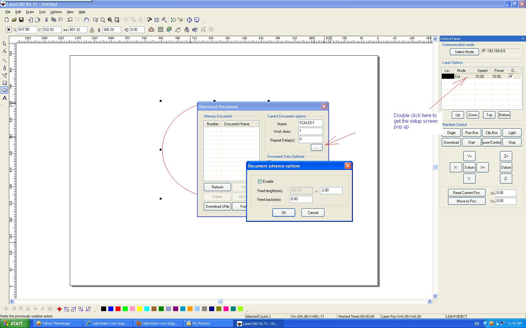

Hey guys, I've since switched from using Cad/Cam setups with parallel style cards to a DSP that is being shipped to me right now.
I've been looking through the software and trying to get adjusted to it...but I have not found a way to cut 'holding tabs' into my cut vector. I can do this with my Cam software to hold a particular cut vector in place with a .5mm tab that holds it for shipping it to the customer without it falling out of the main piece of wood (specifically for 3D puzzles).
Is this feature in here? It's a pretty big necessity.

Is there a chance this could get implemented in the future Marco?
Re: Holding tabs
There is "Feed" feature on cutting. Not sure if it is capable to handle "negative feed" as I haven't setup my machine yet since moving to the new shop. Therefore, I need your help to test it and update me after the test

Hmm, interesting. I shalt test it out later and report back.
