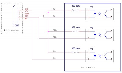

Should I just extend the outputs to the inputs on the corresponding card? Would I use pin 8,9 in Mach 3 to setup Axis A as slave?
Also I was wondering if I should make axis Z the extra card so that X and slave A are controlled by the same style micro-chips on your board.
Re: 3 axis controller questions
Should have that info soon as a request for connection diagram has made
For sure the single channel board (slave) must be have Direction and Step input instead of a parallel port
Will post it once I got the connection diagram

See the pdf file

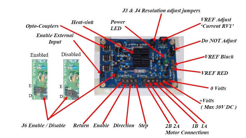

I'm not tech savvy enough to know exactly what is going on. I was hoping to use this board which I already have as a 4th axis.
http://www.routoutcnc.com/singlesmall.html
It doesn't need 5v that I can find. For outputs 8,9.. do they correspond to the 4th axis output?
Also, what are the specs on the relay output? amps, how is it triggered.. that sort of stuff.
It's pretty straight forward. Just map the pin from our controller to your board. That's all you need to do! You don't have to use the +5V. "Direct" to "DIR", "Step" to Step, "Enable" to EN
If you can't handle this, then you better ask someone to do it for you.
