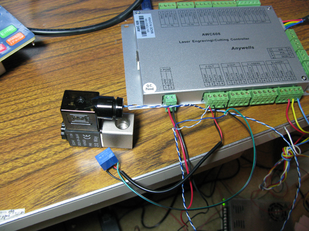

I finally got a chance to test air-assisted feature from the DSP today. It seems the connection and logic is pretty straight forward.
The output is OUT1 at "2. OUT" .
Note, the stage of OUT1 is HIGH (24V in respect to GND) when the machine is idle. Once the X & Y start moving, it changes it's stage to "low or 0V". If you want to use postive logic by turning air ON when X,Y is moving, then I'll suggest to use 24V (pin#1) & OUT1 (pin#2) as OUT1 will turn into 0V, so you will get 24V in between pin#1 and pin#2.
However, the output current from OUT1 is very low and you can't drive a solenoid directly from OUT1. Instead, I would hook up a small DC relay that take less than 30mA to energize for controlling a solenoid. Then, by connecting the normally opened contacts to my new found "Air-Tac" air-valve in series to board 24V. The mechanism seems working good even though I didn't have air tube/pump hook up.
The Air-tac is a DC24V dvice support up to 10 bar pressure. I'm thinking it's a prefect for the application unless you want to drive an air pump On and Off and On and Off... until you kill it. My suggestion: try not to drive an air-pump On/Off too often as the surge current can shorter the life of motor quick. It's better to use a compressor tank instead and having the air-valve to control air flow.

Working on the picture now. Will post it in a day or two. Stay tuned.

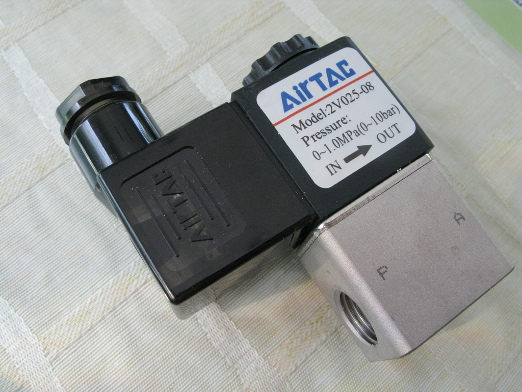

Here is the air-valve. http://www.lightobject.com/DC24V-Air-valve-P689.aspx
Havn't had a chance to measure the thread size. Hopefully tomorrow as it's very busy here.
