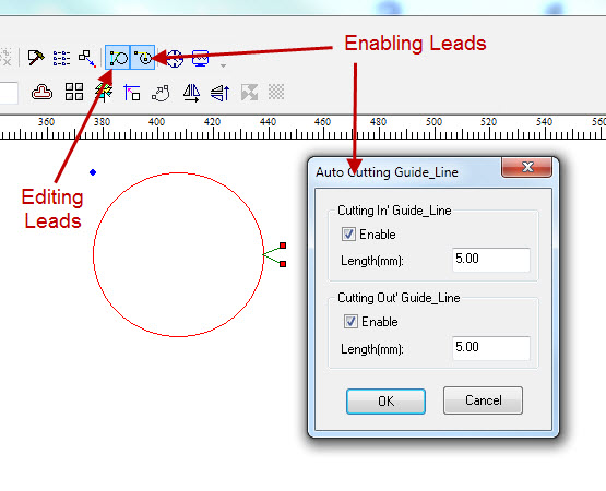

"Overlap does not work in combination with lead ins and outs."
Where did you find the setting of "lead ins and outs"?
If I enabled "Line_Cut_mode", mine won't do the over-cut as I test so many times.

Tech_Marco wrote: Where did you find the setting of "lead ins and outs"?
When I tested yesterday, overlap worked with "Line_Cut_mode"
I will retest today. See if I made a mistake.
I retested. Cut a simple circle with 3mm overlap set.
Tried with "Line_Cut_mode" set and not set.
Overlap definitely happened in both instances.
