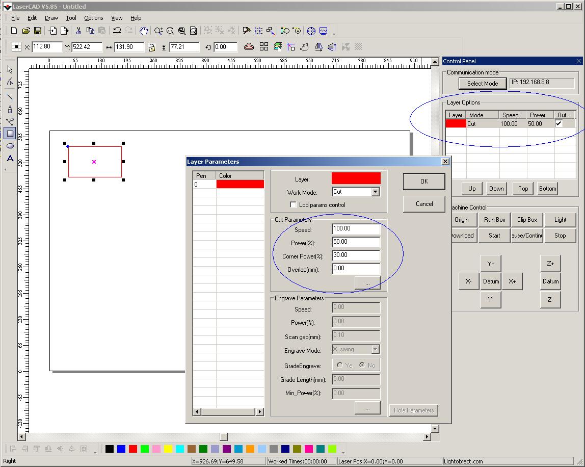

Re: Cannot get RF laser to fire.
Did you set the power output on your drawing? Also, did you put a 'tick' on the later ? I think you just forget to enable the output.
Hey Marco.. So it was not firing because I didn't have the corner power set. When I set it to a percentage it started firing. However, I must have set something else weird because now when I draw a square and run it, it does little loops in the corners (i.e. it goes to the corner then does a kind of loop and then goes to the next corner does another loop). Any ideas?

Gadroc
- Posts: 118
When you click download there is a dialog that pops up. You probably have the "Line_cut mode" checked.
powerfade
- Posts: 45
I think you are right. I will double check that tomorrow. Thanks for pointing that out. I appreciate it.
