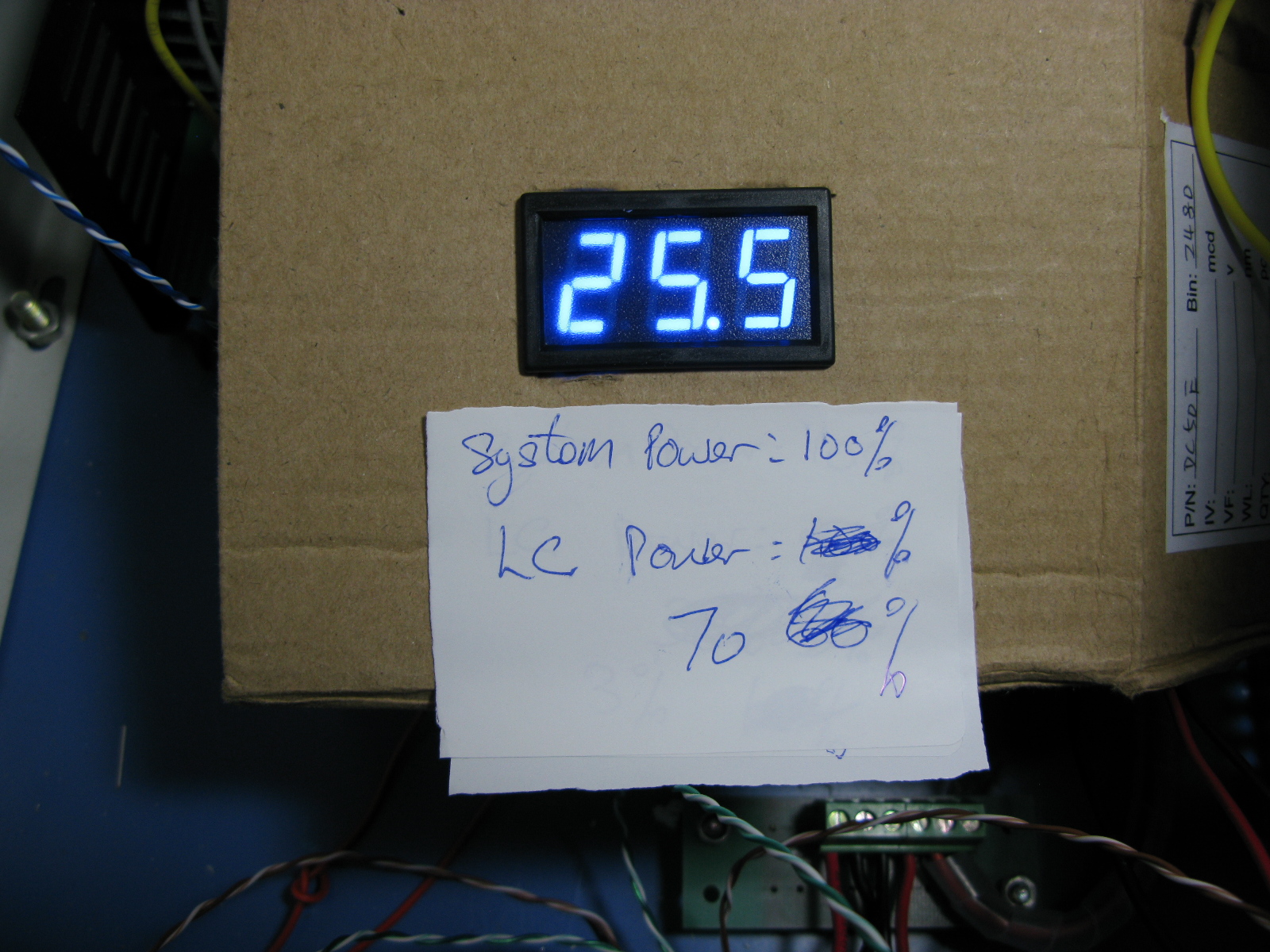

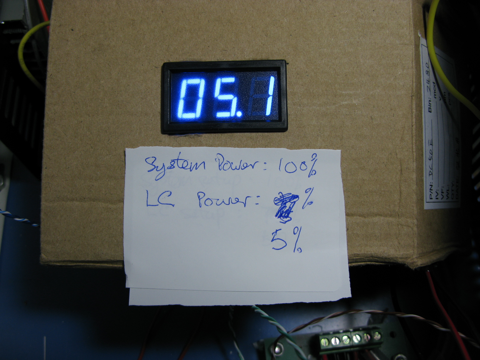

I'm going to post a few screen shots per rating setting. It's true that if you set full power 100% on manufacturing and anything over 80% (not 60%) make no significance. But Idon't think this is a "life or dead" suituation.

System power:100%
PWM frequency: 20KHZ (20,000)
LaserCad setup: 3% to 100%
In general, system power by default shouldbe 90%. Anything over that really make too much significant as high voltage PS won't respond to high speed enough to discharge.
100% power on LaserCad,100% on System setup
75% power on LaserCad,100% on System setup
70% power on LaserCad,100% on System setup
65% power on LaserCad,100% on System setup
60% power on LaserCad,100% on System setup
30% power on LaserCad,100% on System setup
20% power on LaserCad,100% on System setup
10% power on LaserCad,100% on System setup
3% power on LaserCad,100% on System setup

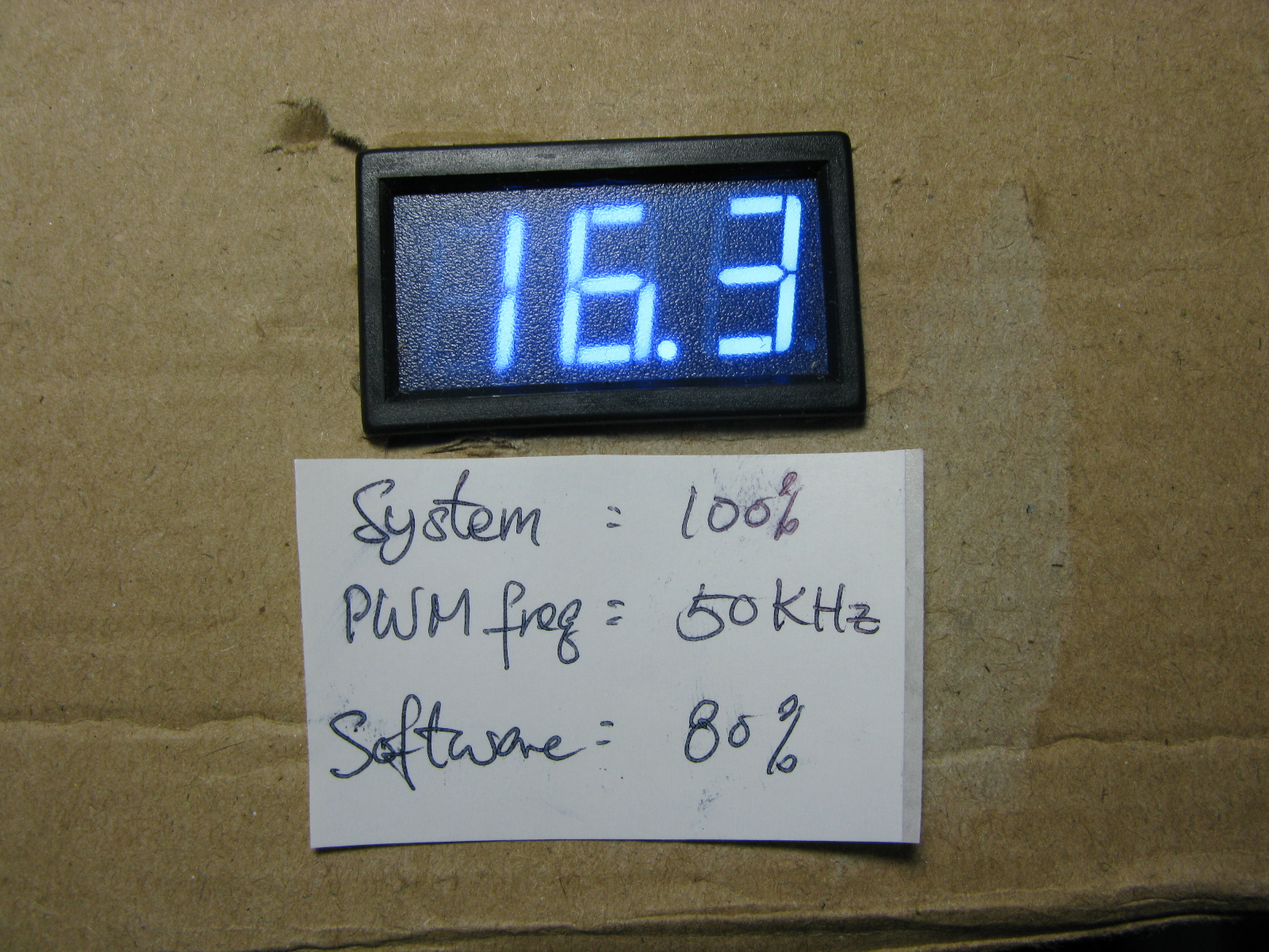

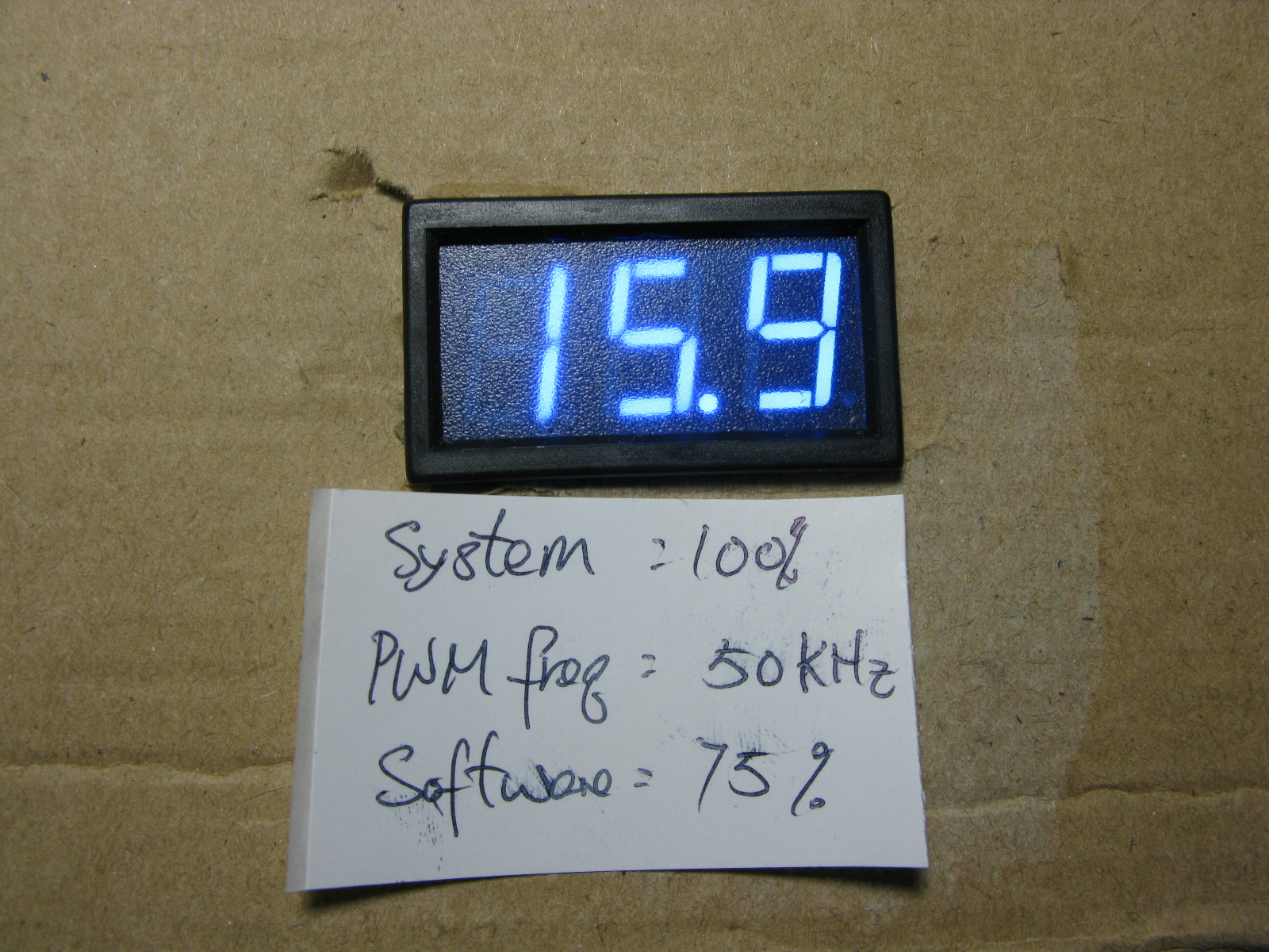

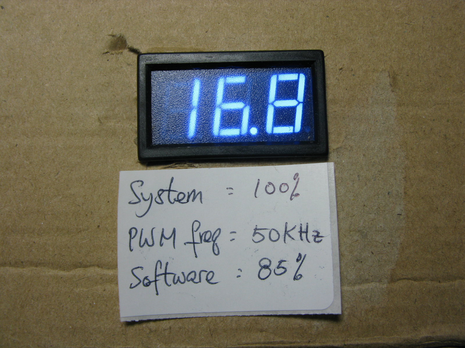

I discussed that matter with the programmer Li after spending two days for testintg and trying to dig out more info with my troubsome Tektronix Scope. Then I did some tests with him for several hrs (chatting by typing, pain as ...). In fact, the card was actually performing it was supposed to be. 70% 3.778V, 95% 5V. So logically, it worked the way it designed. But in reality, it's hard to see much difference after the Max_Power setting is set over 80% . I guess the PS was in saturated mode.
So, my suggestion to the programmer is to rewrite some code to 'fool' the controller. Pretending that 65% was as 100% and add non-linear adjustment to the code. That way, we should be able to see current changing via 65%~100% adjustment, hopefully.
Looking forward to see his new code

Please make no assumption. A quality 40W PS can output as much as 26mA and a true 40W laser tube should take no more than 18mA in general. The controlling from the DSP is perfect if you have a scope to monitoring the output. It output pefectly waveforum in the proportional to the power rating setup. Say 50% power and I could get a 50/50 squre wave. That's very making sens output. The true is that the power supply doesn't response fast enough to the signal (or non-linear) and if power is set over 75% or above. The slope of the curve go rapidly than the region at 20% to 60%. Plus, the PWM frequency does have some effect on the output as well.
I hope you guys wont get panic about it. Once you understand the logic behind it, you should be able to make good adjustment on the power setting. I talked to the programmer about that issue (it's truly not the fault of the DSP card), it's compatible issue and the law of physics. To deal wit that, I asked him if he could extend the range of the zone from 70%100%, make it like triple long. So, that you can see the difference (human eyes issue) more obviously.
