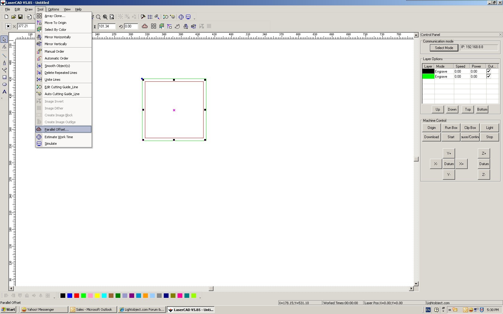

There is a new feature on the V5.85 call "Parallel Offset". In the beginning, I didn't now what was that for and how important it was until today!

Now back to the subject. What is a parallel offset mean? Now, smart you folks. I don't think I need to explain what it is and you can come up the idea. Yes, it let you to 'expand' or 'shrink down' the orignal image by the amount you set in outward or inward.
Taking the 100mm x 100m square cut as an example. If the machine follow exact route from the drawing, ideally it will cut 100mm x 100mm. But since the laser is doing "melting', so, it will end up a square of 99.5mm x 99.5mm (note, it's just my assumption for that amount). So, let's now set the "Parallel offet" by 0.5mm Outer. It will do 100.5mm x 100.5mm cuting. After minus the burned off, you will get 100mmx 100mm perfect square! Isn't it a good features!
