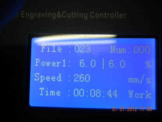

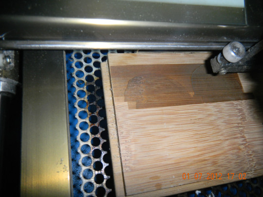

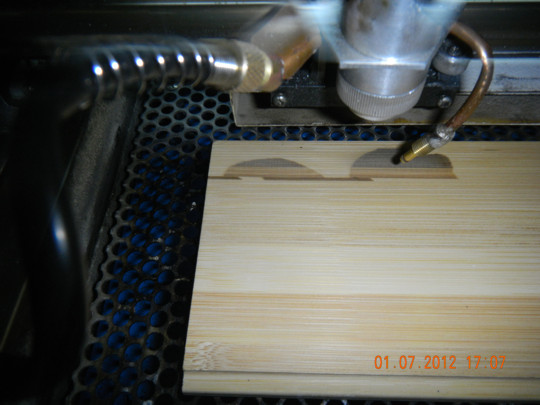

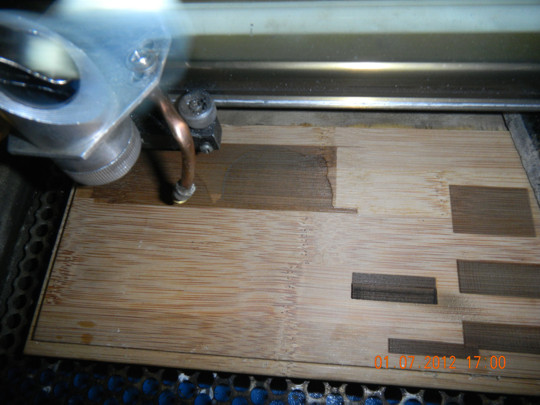

changing on the LCD panel the power and /or the speed after halt /pause let the laser jump to another position ( see picture)
the probleme is if a job is downloaded to the machine and the machine starts but the result is now what I wanted I used to change the settings with the LCD panel and start again it was fine before with the old version but now when I start again it startes on a different place what ruins the whole.
