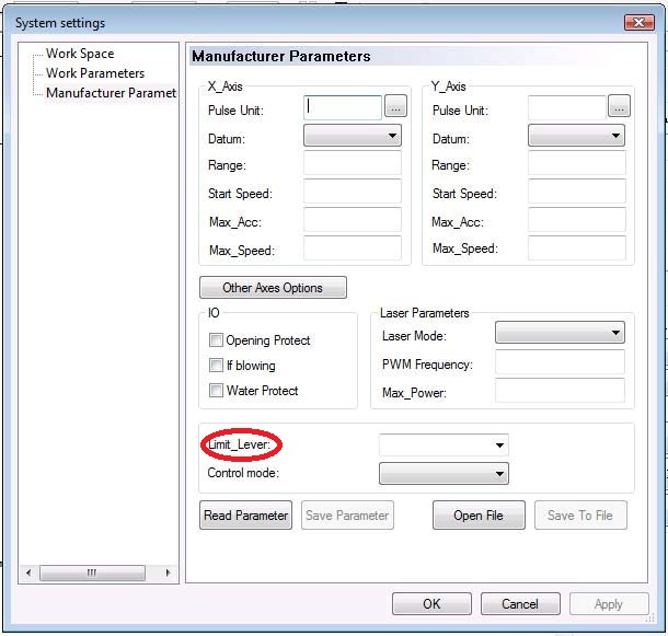

Reading the older manuals PHcad v4), by the way I am using LaserCAD v5.77, there is a "Limit_Lever:" setting, but I can't find it on LaserCAD v5.77.

Limit switches for the 2012 need to be normally open and when triggered the connect to ground.
I've attached the manual for LaserCad 5.7, which for some reason was excluded from the RAR file when 5.7.2 was uploaded.

Yes I have the 2012 version (AW608).
So, if There is no way to change the behavior of the limits in the software, then I had to change the wiring.
I wil connect in this way, normaly open and close it to Ground. (I don't like it, but who cares.!!), and connect the chiller water protection directly to the Laser PSU.
