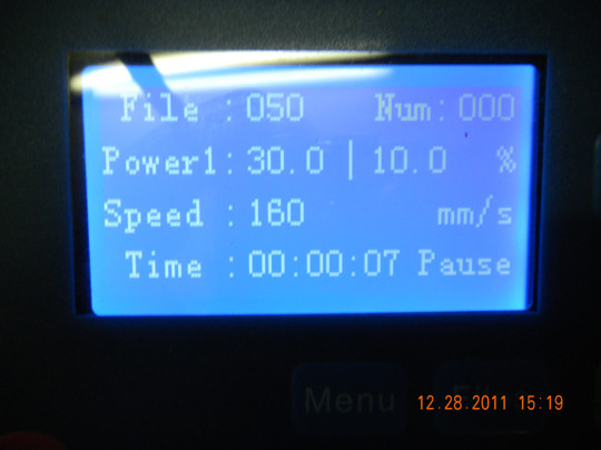

here are a few picture from the changing on is own of a file during working.

here in sec 7, changing again on his own to power 30/10 and speed 160mm/s here I had to pause and set everythings back tyo the original and then starts the game again
here in sec 6, changing on his own again to power 30/30 and speed to 160mm/s
here changing on his own to <br />power 30/30 and speed to 160mm/s
this are the original settings:<br /> power 30/9%, speed 180mm/s
loading file # 50 from DSP memory

I still can't tell the problem, please write down the issue under the picture. The programmer said that the power default setting on the LCD is for the "Box" and the "clip". Once the machine start the file, it will load the setting of the working file.

I just wrote the description under each picture but you have to read the picture from the bottom up bottom is the first one from the sequence

I don't see any "explaination" under the picture but "label" only. I can read the LCD info so your 'lable' under the picture really making no help for me to understand your question. I was hoping that you can tell me the "step by step" how you get the problem. It sounds very odd that the DSP went high speed then slow it down. It seems that you have a lot of trouble on the card, from memory read/write, upgrade, waveing, and speed.
We couldn't duplicate the problem that you're having. The programmer suggested you to format the memory on mian board (note, not your USB memory stick) then do the upgrade on the DSP again.
The new software has nothing to do on the "wave" that you complained about. He said he didn't change anything on the software but just adding a couple features. Plus, he double check it with machine and found no error like yours.
I think we have spent too much time on this board and I'm asking you to return it to me for diagnostic check.

I just though that the explanaition did not go on the botton it did go on top of each picture, sorry.
the probleme is what you can see on the picture I download a job file ( by the way after download the display dont show this downloaded file it showes the previous file only after hitting the start botton it shows the actuall file) the the machien starts and during the first couple second it changes but sometimes it even changes right in the midle of the job.
Ok please let me know when you got the new cards in because like explained I can noy wait for more then 5 days . thanks anyway I will first re format the memory lets see if this changes anythings.
