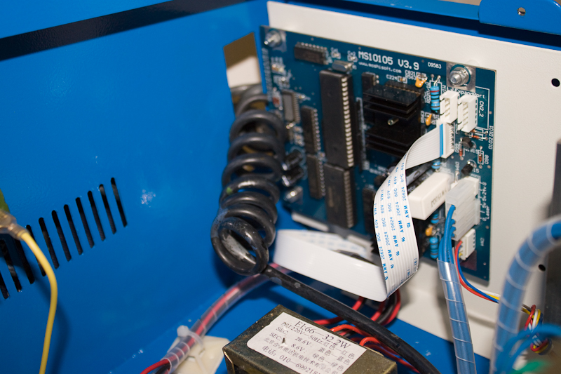

Hi all,
This week i have buy a CO2 machine on eBay DC-K40IV, the software (Moshidraw), is very bad and not user friendly.
I see on the lightobjet shop the DSP for using with coredraw or CNC card for Mach3.
But the DSP or CNC card is ok for the version 4 of the machine ?
it is necessary to change other components? (power supply, stepper motor ?)
The DSP ou CNC card, work on vital machine ? (Moshidraw, not).
(Because i use a mac with parallel desktop)
Best regards
Olivier

I converted a Chinese 40w (w/MoshiDraw) laser last year. I tried to go to Mach3 and a general cnc card, but the experience was not successful. I could cut OK but engraving with Mach 3 is nearly impossible. I then upgraded to the DSP from LightObject. Once I got it going, it was fabulous.Hobby wrote:Hi all,
Best regards
Olivier
That being said, you will likely have some issues with setting it up. Nearly everyone does. Not that it is so difficult to do, but knowing exactly what to do is not that easy. The instructions are poor. HOWEVER, having done it once myself, I can help you a lot. When you do it, let me know and I will send you a config file that you can start with and help you get through it.
What you need:
DSP Controller & software
- 2 stepper motor drives

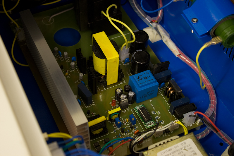

24v PS (yours is likely 110 to 220 converted and will work, but if you can spend the extra $40 or so, a new one is nice)
Laser PS (your will likely work here as well, but I doubt that it is PWM, which is the ideal configuration for the DSP. If you use the one you have, you will still be controlling the power manually and connecting from the DSP is a bit trickier.)
Note, I have subsequently ripped everything out of my 40w Chinese laser and put it into a home built laser. The DSP truly shines when in a machine that is well designed. I now use the DSP and my new laser for up to 12 hours of continuous work and both perform great.
If you decide to go ahead (and I hope you do), please feel free to contact me and I will do what I can to help you.
Good luck!

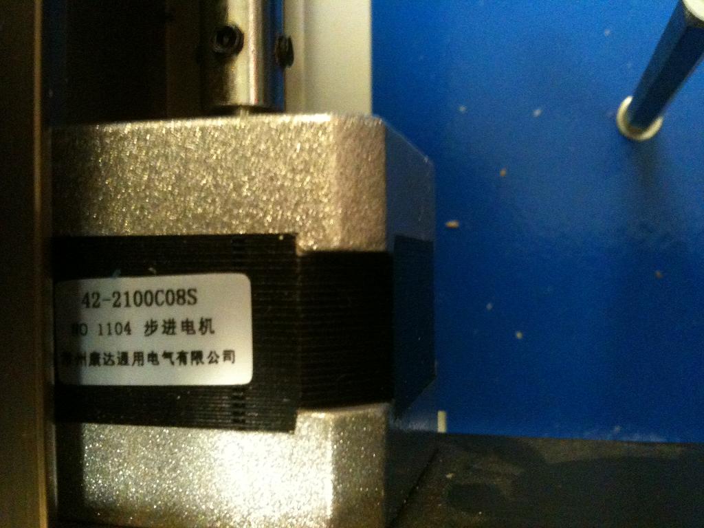

I can use the existing motor stepper ?2 stepper motor drives
Best regards
Olivier
twehr
- Posts: 204
Re: Converting K40IV machine
The existing motors should be fine. You need the drives - like these: http://www.lightobject.com/1-Axis-CNC-L ... -P451.aspxHobby wrote:Thanks for your response.

You can PROBABLY use your current laser power supply, but not knowing what that is, I can't say for sure. If your supply is not what is considered the current standard (like the ones here on LightObject.com), you may want to consider changing.TeacDance wrote:Hi

first one thanxs to answer. Power supply is the machine orginal and i'm not sure is that standard supply or cheap china modelYou can PROBABLY use your current laser power supply, but not knowing what that is, I can't say for sure. If your supply is not what is considered the current standard (like the ones here on LightObject.com), you may want to consider changing.

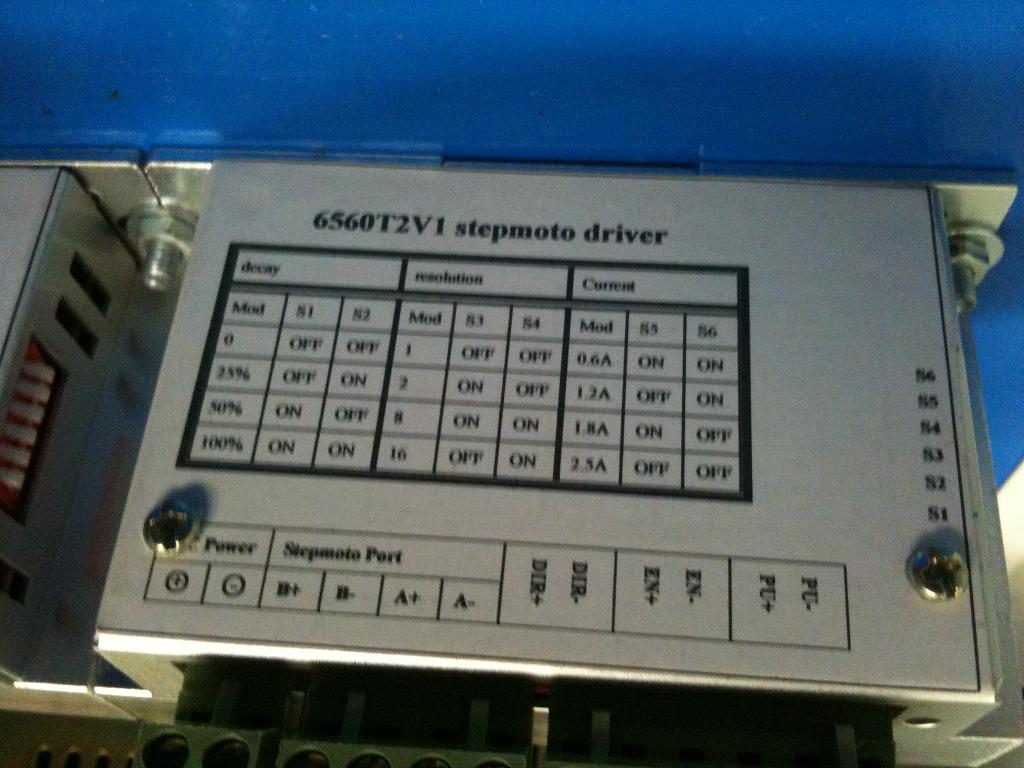

What is recommend setup for those stepper motor? all dip switch is ON position is that OK?
Is stepper motor connect right? red blue white yellow see on picture
