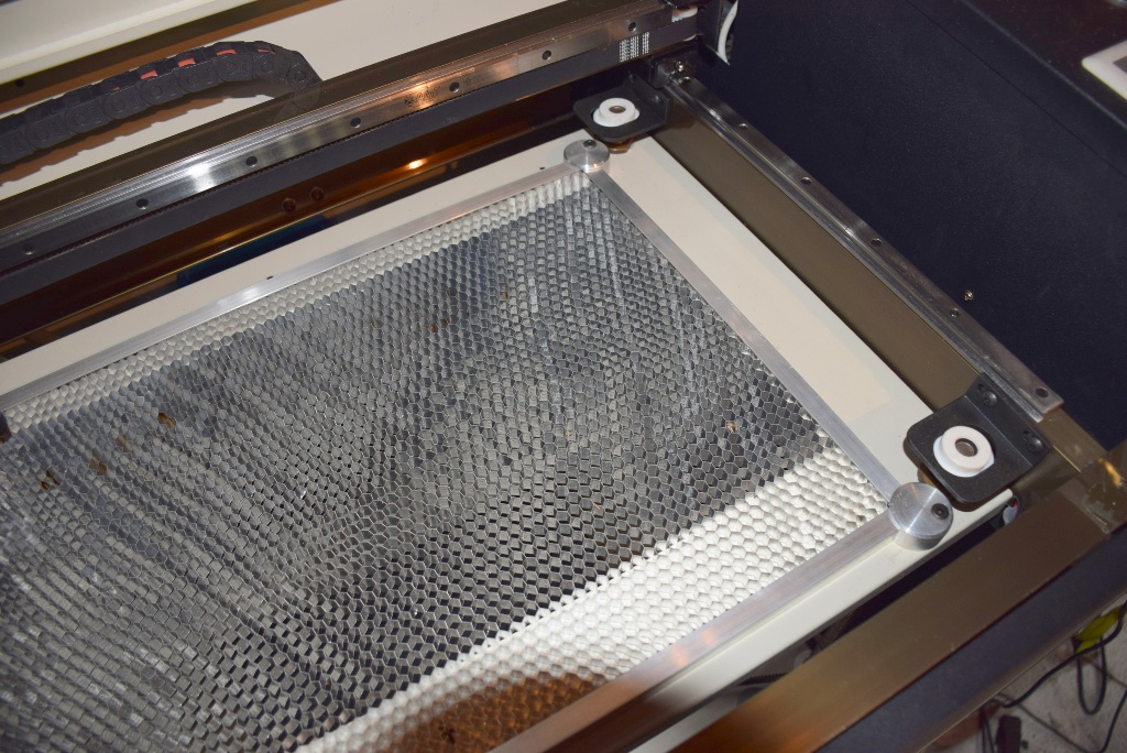

I made my own honeycomb bed/frame by purchasing an unexpanded honeycomb stick (cuts down on shipping costs) which can be stretched to roughly the size you need. I was able to cut the sheet with a sharp hobby knife. You just have to support the sheet near the line you want to cut and then shear each cell wall by pushing the blade smoothly downwards at about a thirty degree angle. It went a lot better than I expected it to. I cut some 12 X 12 X 1.5 aluminium angle and machined some aluminium corner blocks which had a 90 degree pocket for the angle and honeycomb to fit into. The honeycomb was 10mm thick and the angle was 10.5mm inside so the honeycomb is just held loosely against the bed of the machine. My machine came with a flat aluminium table with slots, usually called an engraving table. If you try to cut anything on these tables the material you are cutting will vaporise with the heat of the laser and then condense on the cold aluminium. This can cause oily or tarry residues on the back of the stock. I removed the slotted sheet completely and fitted the honeycomb instead. I believe this material I purchased is used mostly for composite constructions like aircraft parts and formula one cars.
My honeycomb table
My honeycomb table
