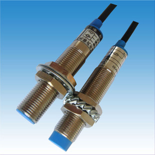

My tech found me a special active proximity switch that works without any mechanic part. I think it's good one for being used as Auto Focus sesing on the DSP controller. This switch need 10~30V (or AC 90~250V for AC type) to power and there are five different types. I think I'll pick A or D for testing. Should have it in about 10 days
Type:
1ï¼ÂÂA:three wires NPN Normally Closed or Normall Open
1ï¼ÂÂB:three wires PNP Normally Closed or Normall Open
1ï¼ÂÂC:four wires three wires NPN or PNP (Normally Closed and Normall Open)
1ï¼ÂÂD:DC two wires, N.O. or N.C.
1ï¼ÂÂE:AC two wires N.O. or N.C.
2ã€ÂÂVoltage:10ï¼ÂÂ30V DC ã€ÂÂ90~250V AC
3ã€ÂÂOutput current:200mA /300mA
4ã€ÂÂSens distance:Sn=4mm
5ã€ÂÂAccuracy:≤5%Sn
6ã€ÂÂFrequency:30Hz
7ã€ÂÂSize:12mmÃâ€â€12mmÃâ€â€1mm
8ã€ÂÂTemp:-25℃ï¼ÂÂ80℃
9ã€ÂÂMaterial:Copper with coating
Found Active Proximity switch for DSP Card Auto Focus

Update of this post:
I received the sample yesterday and ran a preliminary test on it. It's a pretty good device and it respond quick once a distance of ~1.5mm between an object (any object, metal, plastic..) is detected. The sensor is made of a 3 wire NPN normally open circuit and input voltage is DC 9v~36V.
I haven't tried it on the DSP card yet as I need to do more test before appling it to it, can't afford of blowing off the card. I believe that I need to setup a R circuit with two resistors of which it forms a voltage divider. It is because that the operating voltage is higher than 5V, the trigger voltage of the DSP. For example, if the input is 24V, then I need to get two resistors: 10K and 40K. So when it's inactive, there is 4.8V voltage drop across the 10K or 0V when the sensor is triggered.
Will test more later and will post more info here
Re: Found Active Proximity switch for DSP Card Auto Focus
Update:
I talked to the tech guy and he said that there is no need to setup a resistor voltage divider and saying that I could connect the output from the proximity switch to the limit sensor input. Just power the proximity switch with the main board power which is DC24V. The open loop output from the NPN collector pin is almost the same as 24V. But once it's connect to the DSP U- input pin, it dropped to 5.6V which is safe for most TTL circuit.
Guess what, it works!
The proximity switches that I used for testing were capactiance type and it can detect most kind of materials. It can be metal or non metal. If you have RF type, then it reflection surface must be metal. I have tested two different sensors, one comes with fixed detection distance, about 1.5mm and another one is adjustable from 0 to 10mm. But the diameter of the adjstable is about twice as big as the non-adjustble.
Currently, I have 20x adjustable in stock now. Will order the fixed distance later.

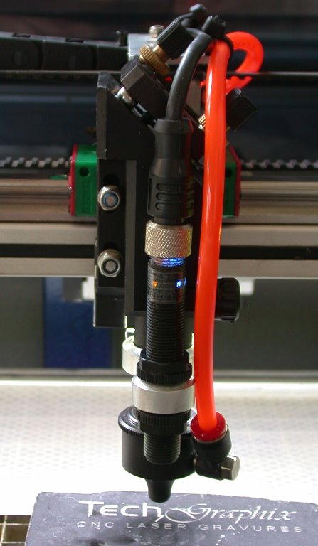

Thanks. I will see about the ultrasonic sensor. I do cut felt but I would assume since it is so thin it would just sense the bed. I am going to order one today. Hook up is about the same? So looking about 300$shipped so not bad. Would I need the programmer also?
Techgraphix
- Posts: 492
When you lay a piece of paper on top of the felt you will have no problem and the difference is almost zero..
The connection is the same.

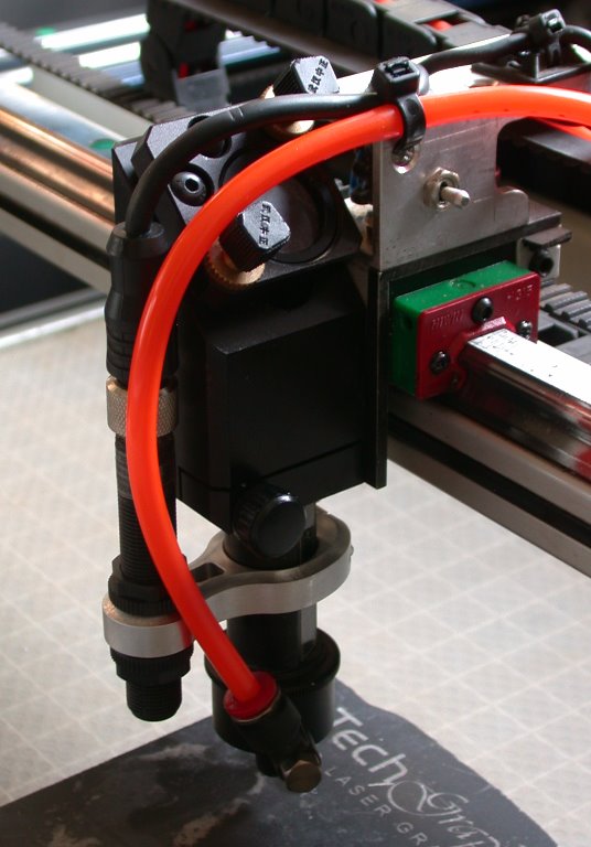

I use a small on-off-on switch (a tumbler with middle position). One side connected to +V, the other side to GND and the middle to the teach-in entry of the sensor.
In that way i can position it to the desired distance and give it a teach-in-pulse.. Then i set this switch back to the middle position.
On the photo, you can see this switch placed on the aluminum cableguide-support. Kees
