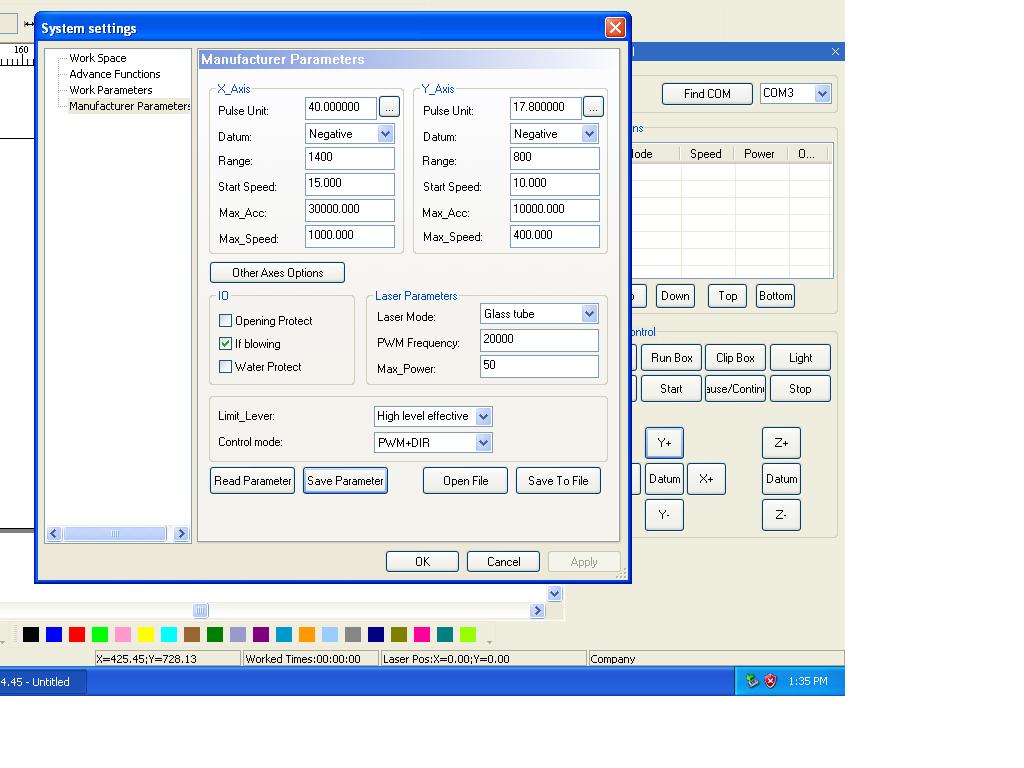

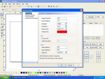

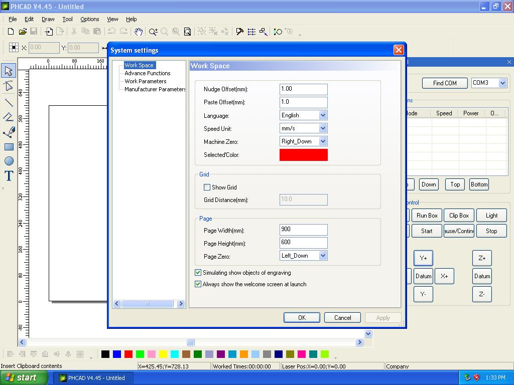

powerfade
- Posts: 45
Re: DSP motors not turning
I have attached screen shots of my parameters. Rich, I think it is basically the .ini file you uploaded.
Thanks..
Chris
Thanks..
Chris
Hi Chris,
Thanks for the pics.
Just a couple of questions.
Have you got the "Emergency Stop" switch wired up and if so is the switch pushed in? I was caught by this little bugger once and was pulling my hair out until I reset it. Had a bit of egg on my face but was happy everything worked in the end
Have you got the limits sorted out.? I don't think it will have the sort of effect of not letting your motors turn but I found this to be the hardest part of setting up the DSP.
You need to cross check all the wires and make sure the polarity is the same for all the switches going into the DSP.
On the "limit lever" you have the High setting selected. This is for the laser to fire as well as the limits orientation and this means the DSP will want to see 5 volts when the limit switches are activated. Make sure the switches are wired up for this. If, say, your home is at the right hand bottom of your machine then you need to set your "home" to the RH bottom and also the "Machine" to the RH bottom. I think there are about 3 different places you need to set up for them. All very confusing sometimes.
Also check the table size of your machine in the settings as this can have a bearing on weather the motors will move. If the size isn't correct you will get and error on the HMI (Human Machine Interface or LED display) saying something like "Y spill error" or something like that.
