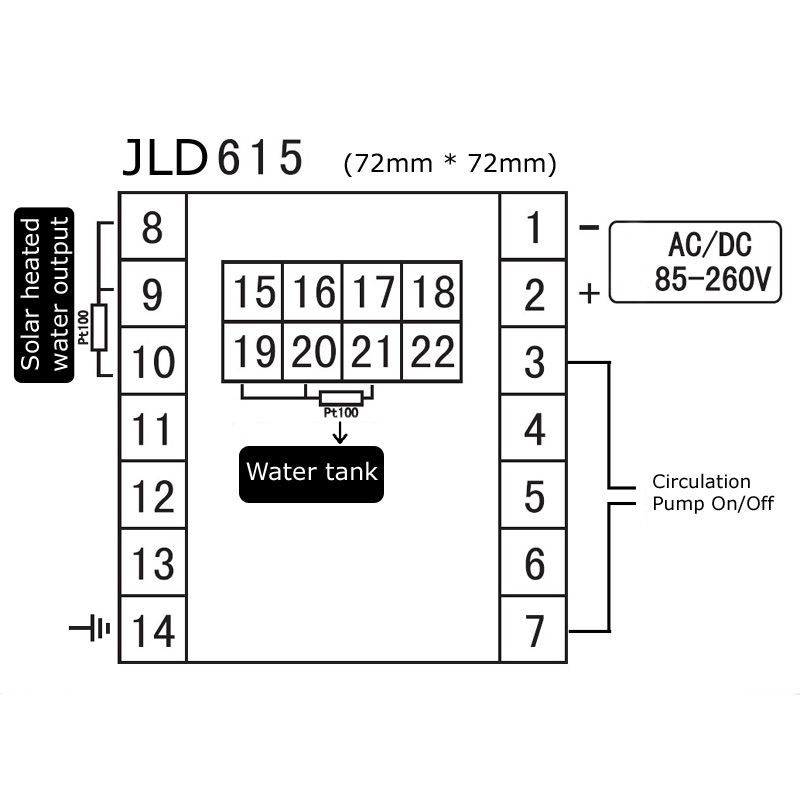

I am drawing the wiring diagram for our application, can you send a draft of the terminal strip?

Working on it. See the back connection terminals below
