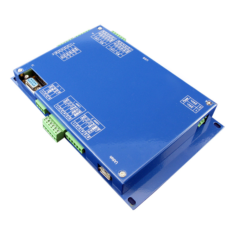

By the way, the new card that comes with auto focus now having an enclosure to contain the main board. That way, it helps a little to eliminate noise from the other devices

Quote -:- "the new card that comes with auto focus now having an enclosure to contain the main board" This sounds good for me as I think I have those issues.

See that, all card now comes with a case (metal) and to some extend, it should help to eliminate some magnetic interference coming from the power supply.
By the way, this card is Auto focus ready and software is completed. Manual,... I need to translate the auto focus and post it here soon.

Nice looking case and probably easier to mount as well.
