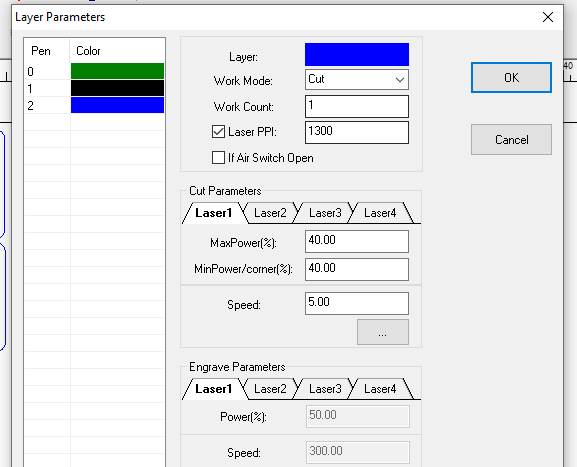

I recently upgraded to the new DSP T9 from and older version using LaserCad 7.77.3. In the old software I was able to set PPI per layer. This was crucial for soft balsa and detailed parts. I was able to lower my PPI to make the finer cuts. with the new software that came with the T9, I do not see this setting. I have my laser frequency set at 2500 which is the lowest setting but that does not help. all I do is burn out the fine details.

Go to the installed folder and open a file name: AWCCfg
[BaseCfg]
Language=3
MachZeroPos=2
IfEnbleSoftCtrl=1
IfEnableLineMode=1
IfEnbleRightStart=0
IfEnbleCountAndPPI=0
IfEnbleClothMark=1
IfInnerMark=1
Change the "IfEnbleCountAndPPI=0" to "IfEnbleCountAndPPI=1"

I am using the new LightObject version of laserCAD. ver 7.22. The only AWCCFG file I found was in older LaserCAD folders.
Re: No PPI setting
There is no LaserCad 7.22.x. I think you mixed up with LasrSoft which doesn't support PPI

Re: No PPI setting
T9 currently is not supporting PPI
I have been asking the programmer a long ago but do far so didn't hear any update from him yet.
Let me send him a reminder

Re: No PPI setting
James:
I don't know about that but Ruida doesn't support PPI, TZ doesn't support PPI and PH doesn't PPI either. The PPI was a request that I made 6~7 yrs ago to the AWC608. So far, only the LaserCad or RayCam supports the PPI. The only quick solution is to get a X7s which support X,Y, and Z. It is selling for $195.
I have made a request to both Ruida and T9. I don't have a timeline when are they going to do it, or willing to do it.
T9 is good by adding 're-cut' feature and support well on.SVG and .DXF. Plus, engraving quality seems one of the best. To cut better (minimize the charring), what you can do is to use high pressure compressor like 40-50psi and it will improve cutting speed by 20-50% and reduced smoke & charring. That's an alternative way to reduce charrying effectively beside using the PPI.

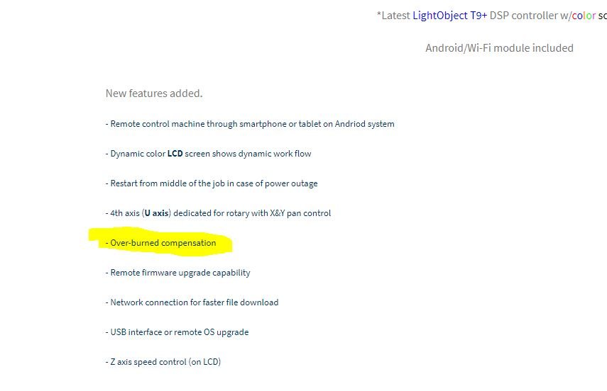

On your web page under T9 features, you list "Over-burn compensation" as a feature. That feature is not listed in the LaserSoft manual.
Re: No PPI setting
Sorry it was a typo. If you purchased within a month, you can send it back for refund.
