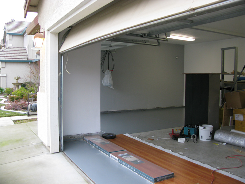

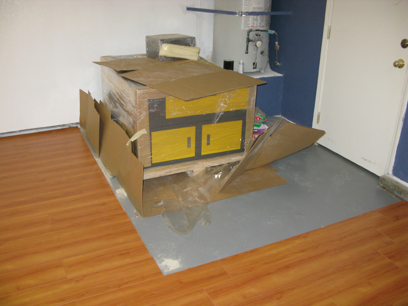

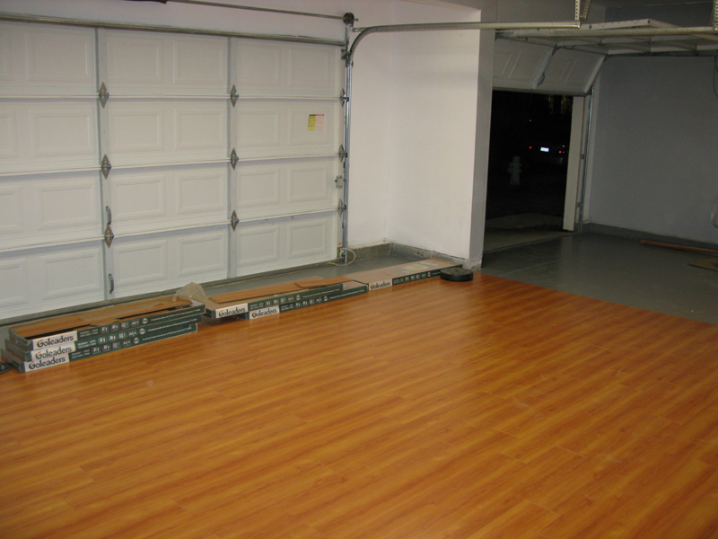

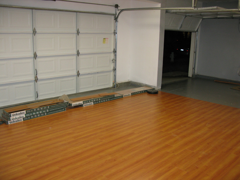

See pictures for my garage conversion. I'm installing an insulation to cover up the door to protect heat lost. It should be done in two days. After that, I'll setup three CO2 laser machine for demo.
