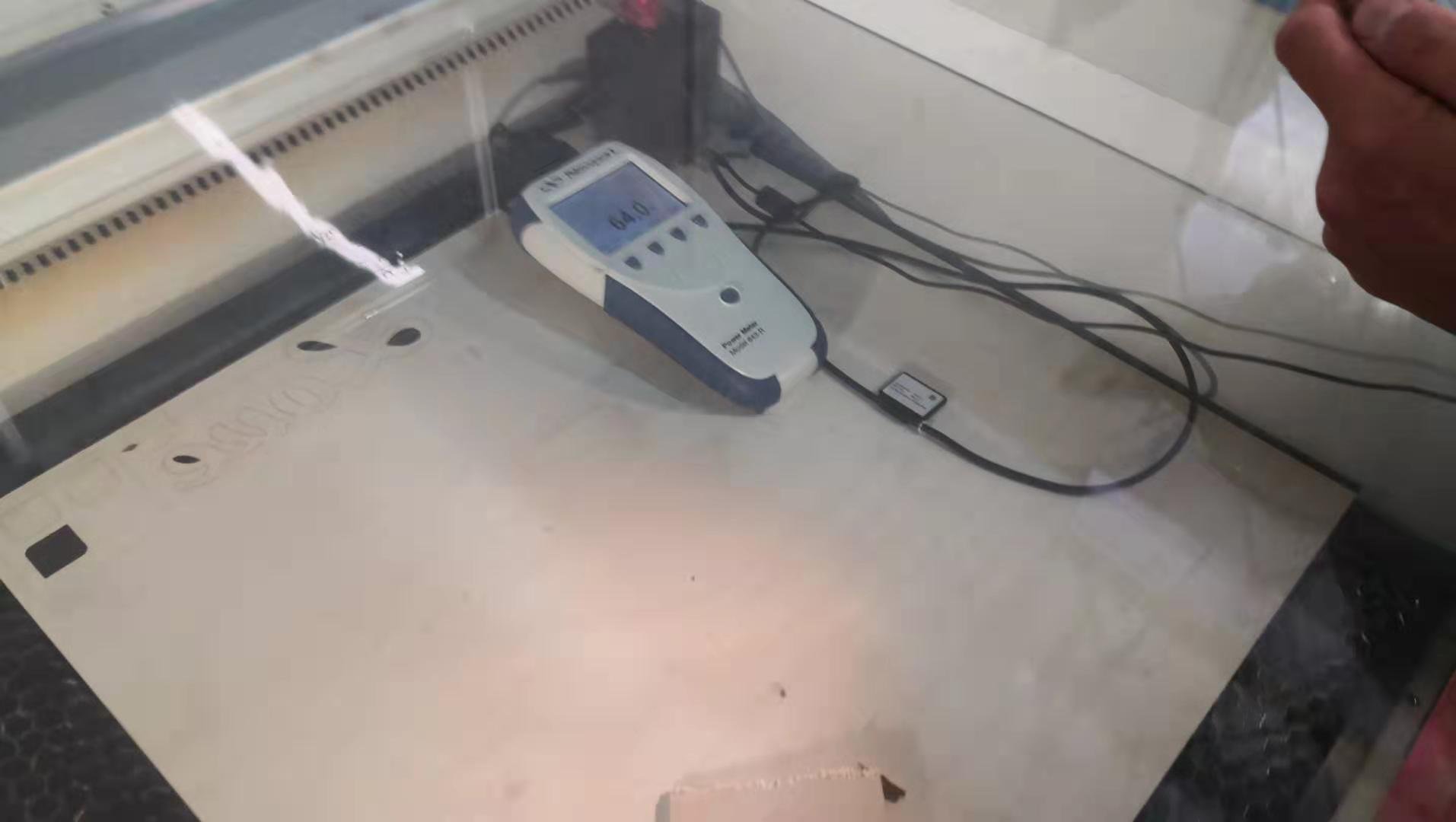

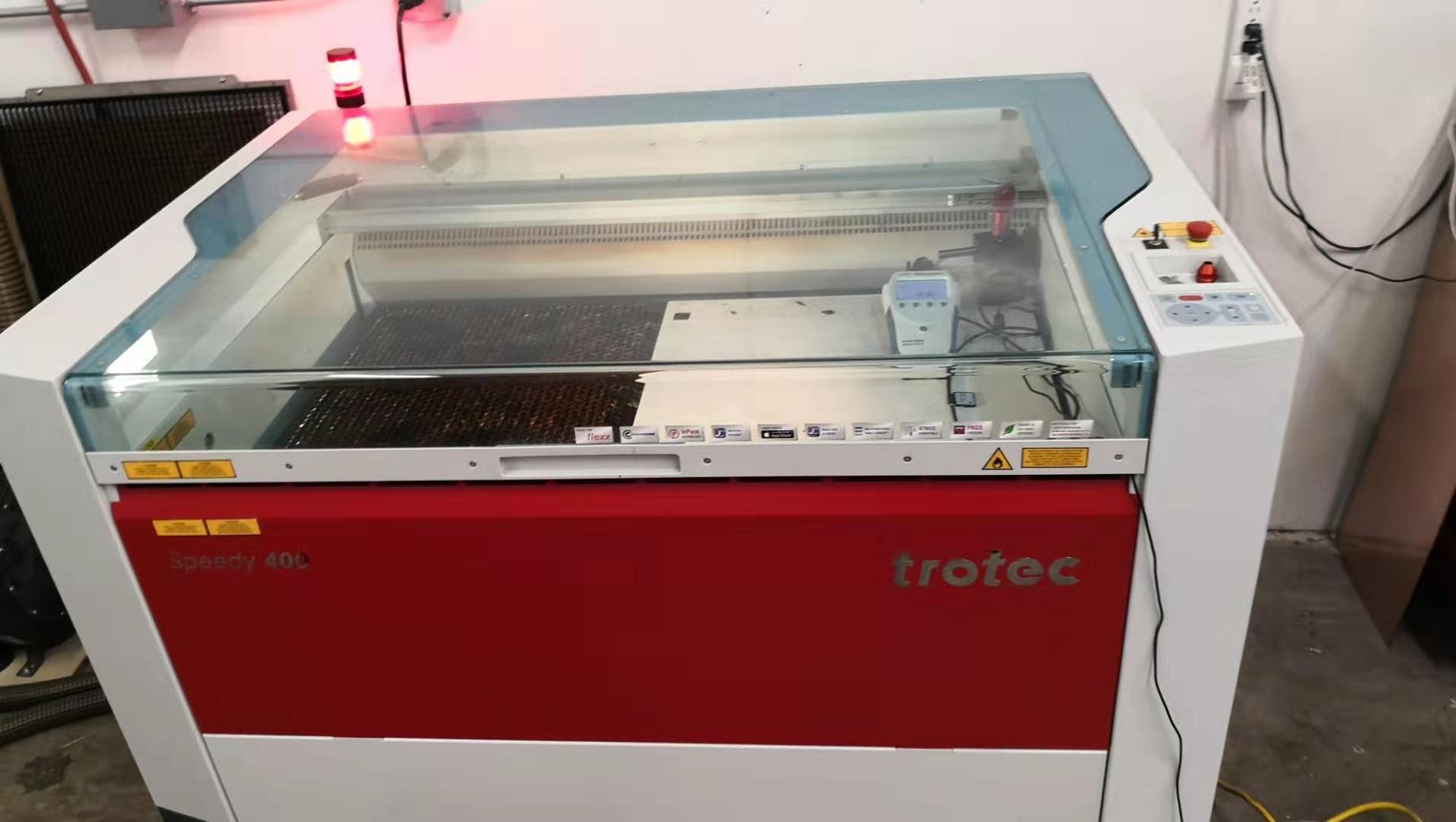

Received a call that requested help on a Trotec 130W with weak power. Bought my NewPort Pro laser power meter there and ran through a few test. The tube was supposed to delivered 130W but ended up 64W roughly. This is a ceramic tube that run similar to a RF laser tube. If it need to replace, it is going to cost the client over $10,000! Hopefully the Trotech do repair on it.
