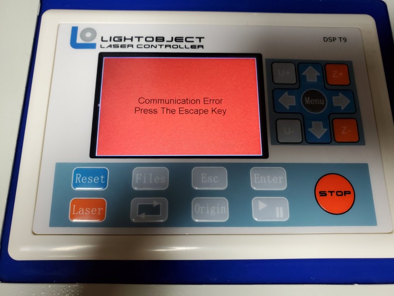

Bought t9 upgrade for my k40 in Nov 2017. Had family matters to deal with. I just did the upgrades over the last few weeks and all was looking good. The x and y axis homed correctly and the z axis moved fine.I went to run the test square and only the x axis moved,the y axis didn't. I was able to control everything from the computer and the dsp screen without any problems.The next day booted everything up and the same thing happened. I was looking up what to check and when I went back to lasersoft program everything was in Chinese. I uninstalled and then reinstalled laser soft but it wouldn't connect to the machine and the machine screen was red and said "communication error". I tried to reinstall lasersoft several times but keep getting the error. Tried 2different usb cables without any extension,Ethernet cable and the Wi-Fi module without any luck. I can't even move anything from the dsp screen. Is there anything else that I can try? I saw the other post and tried disconnecting the display and all other connections with no luck.

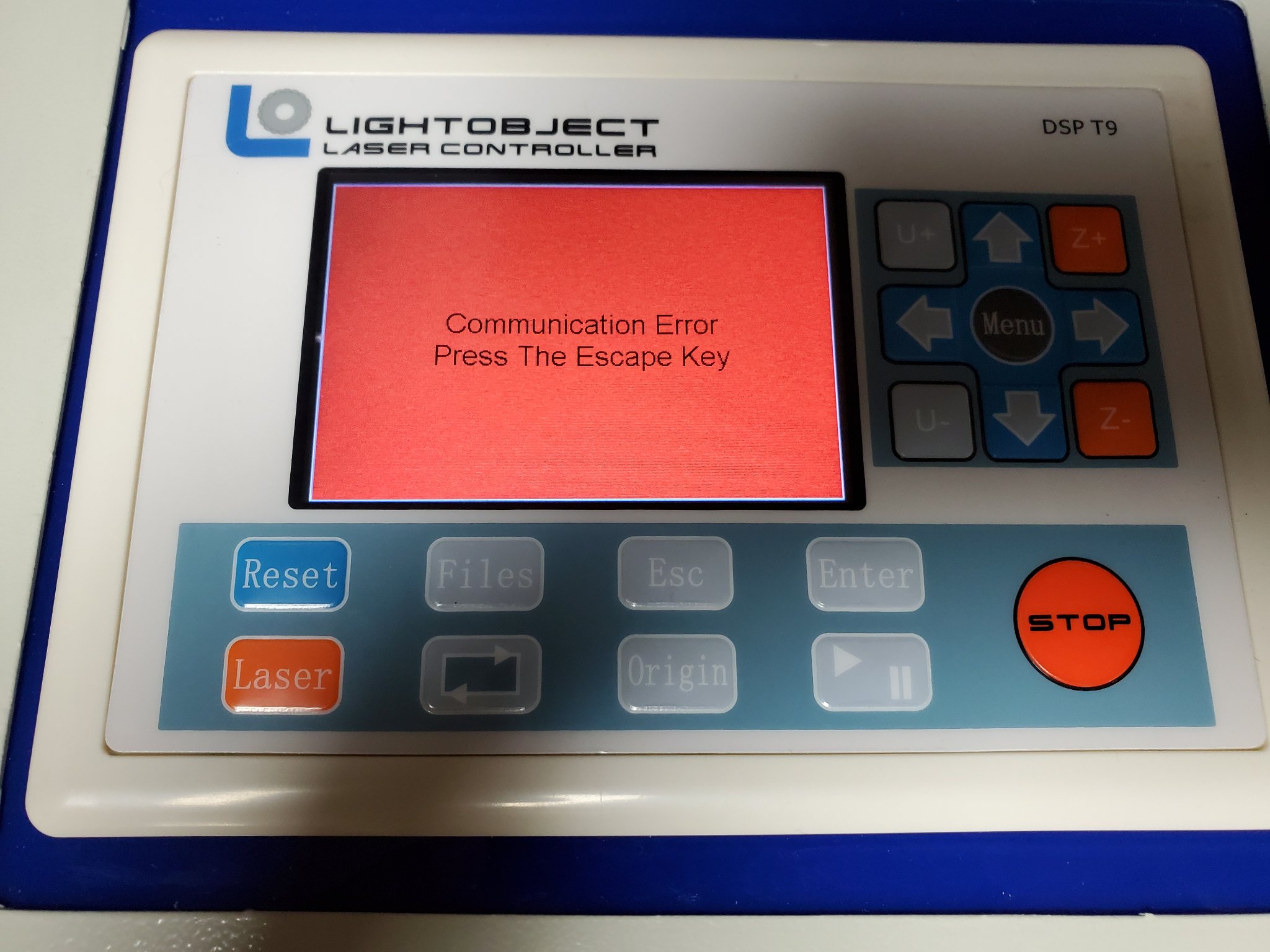

Unplugged and replugged in, has firm connection. On the lcd I can access the menu and u file will stay on when selected but none of the jog buttons work or other ones will stay on. They all go to the communication error screen and the reset button will cycle the screen but ends at error.
