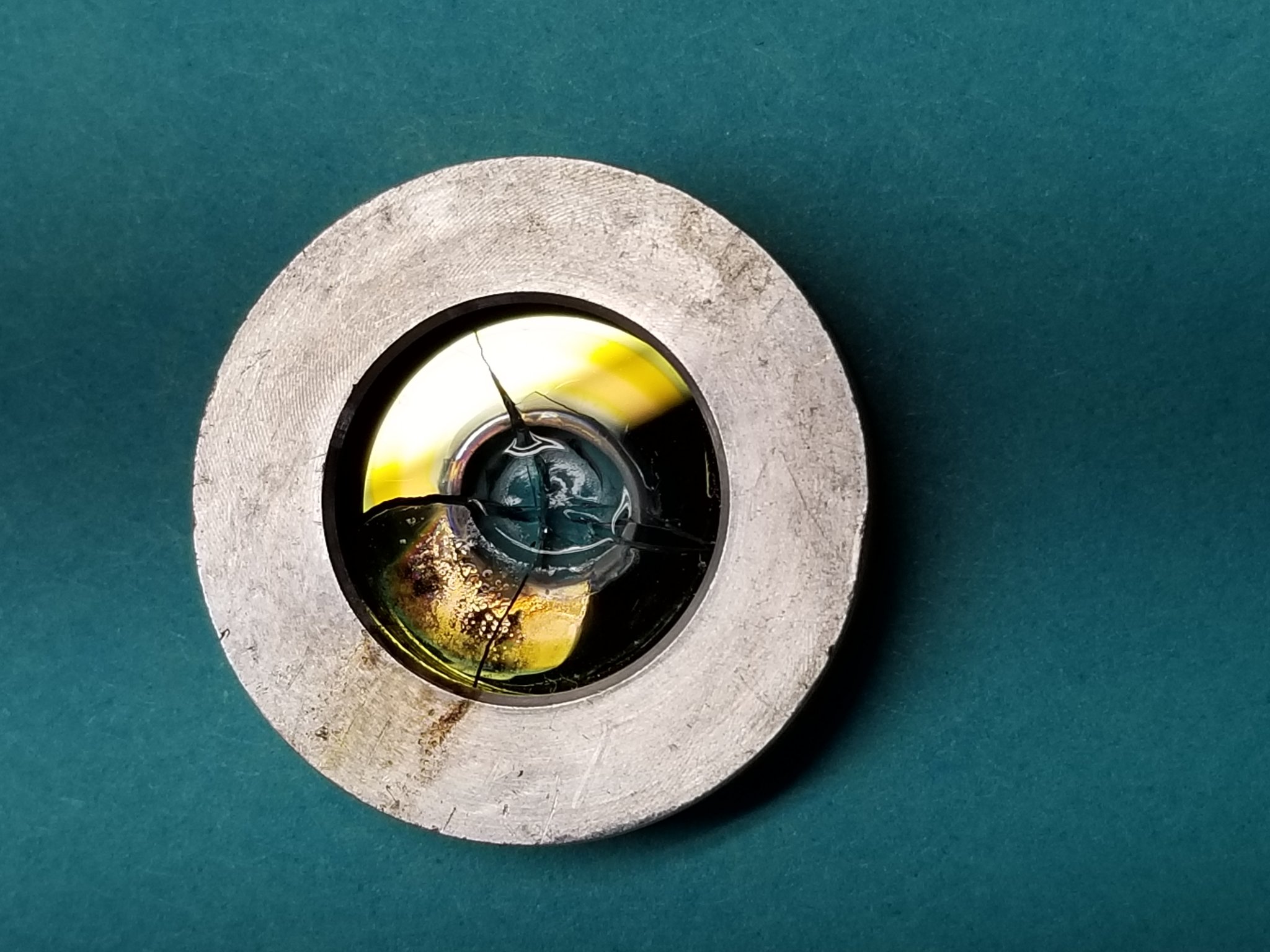

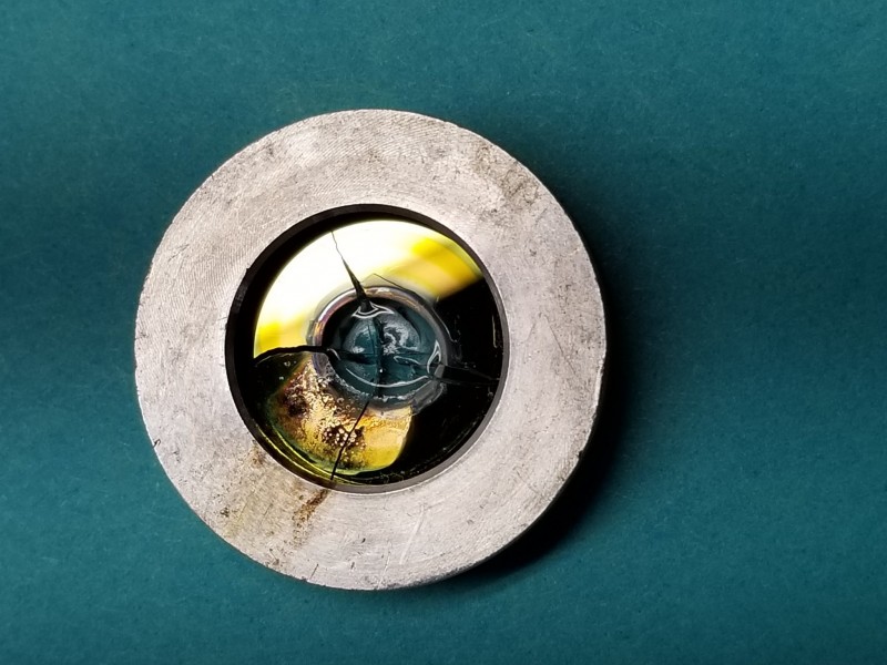

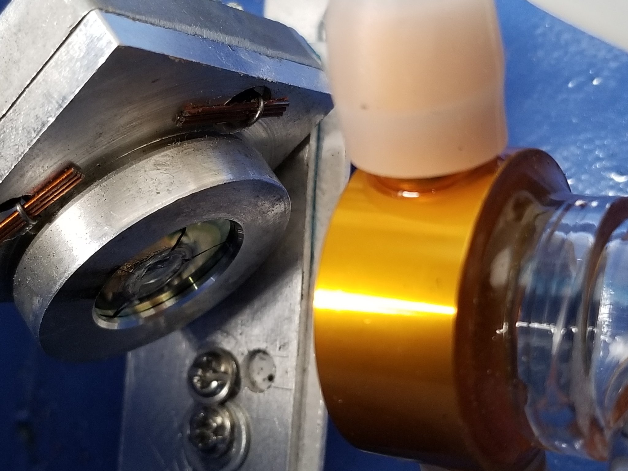

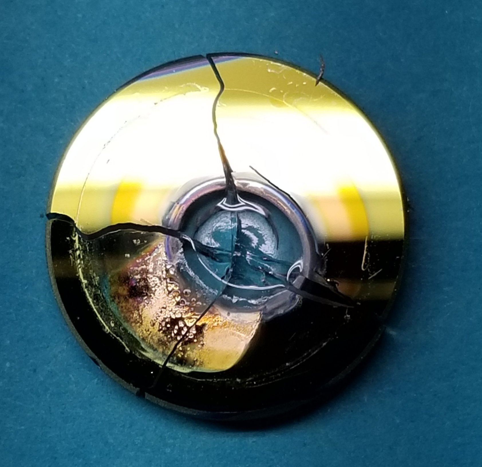

Yesterday, I installed the new water pump and aligned the mirrors. My first cut was 3mm acrylic and it cut through in one pass (but still not as powerful as when the tube was first installed a couple days before). When I attempted to make a second cut in the acrylic, I noticed the laser stopped cutting but the laser head was still moving. I then saw a BRIGHT light from the near the business end of the laser tube. It appears the laser was FRYING my 1st mirror closet to the laser output side.
Now, I’m not sure what the problem is and I desperately need HELP!!! I don’t know where to even start.
I’ve attached photos of the latest damage and I’m seeking any suggestions as what to replace, purchase, reset etc.

It seems that the coating of your mirror was damaged and laser beam could not be reflected by 100% so heat accumulated. what you need to do is to get the mirror replaced by "Si”. Then it should put you?back into business
