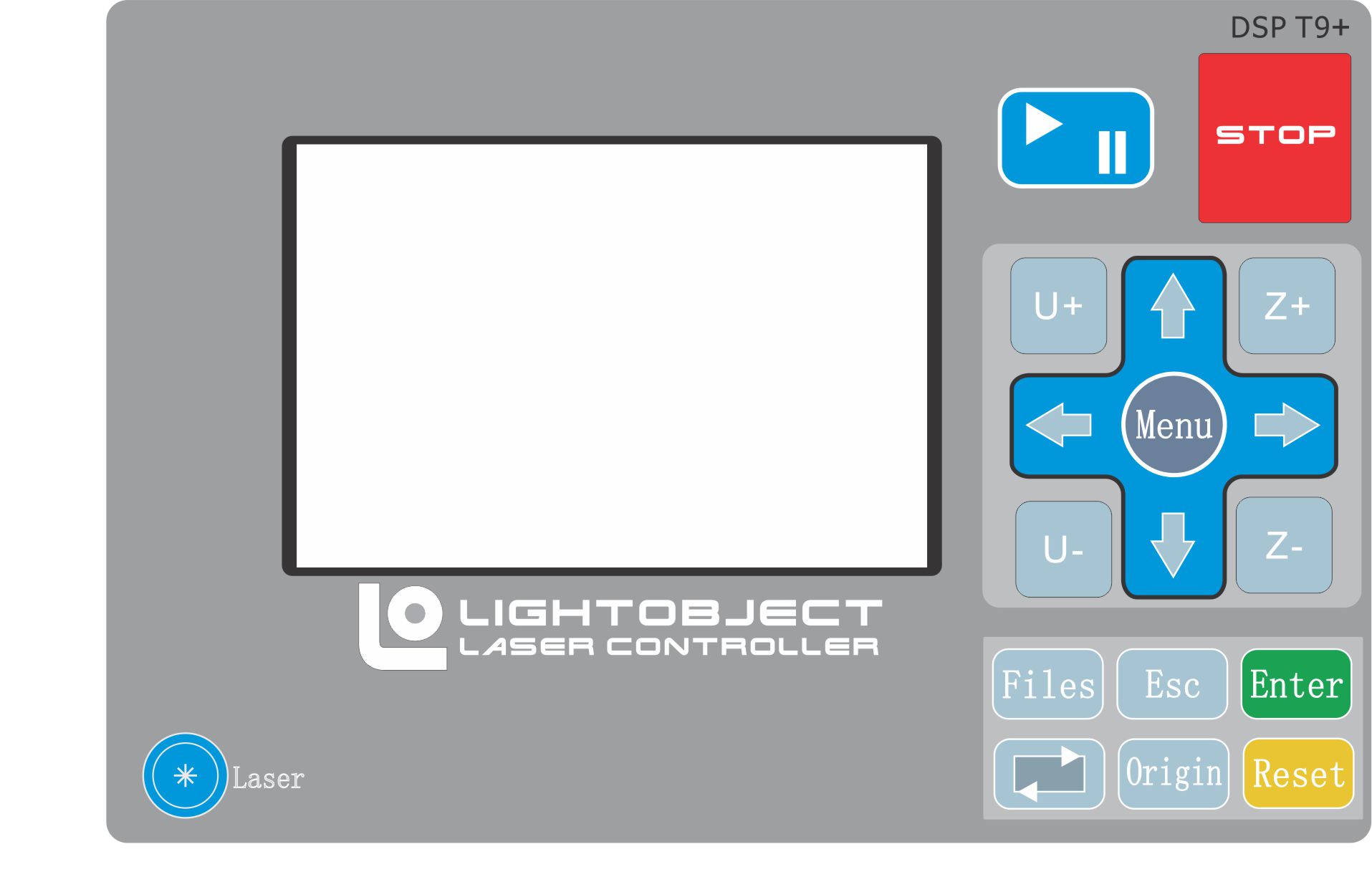

I just designed a new keypad interface for our T9 DSP controller card. It should be available by the end of August. I think it looks more Pro than the current layout smile
Following is a list of features that I put on it my 'wish' list and has presented to the manufacturer/programmer for evaluation. Suggestions and comments are welcomed but no offensive. I need to make it clear that I don't own the card company and I'm not the programmer. There is no guarantee whether the programmer can complete these tasks from my request. He may able able to do some but he may not be able to handle all. It is just features that I think will benefit all of us when doing laser project. Even if features were successful lanached, how good they are I really have no control but all I can do is to provide more feedback to them and get some improvement after that. Therefore, no blaming on me! :roll:

Small note on the new design of the teach pendant. I personally prefer all the buttons aside from the movement keys to be offset to the left so that I can easily use both hands to operate at the same time without it being cramped.

It sounds a bit unusual to me per your design. Can you make a draft and share with us. If majority people like it, well I may make it possible by order different panel template.

I like to add one thing in general:
in many workshops the illumination is not that bright or it is on the wrong place..
I think the contrast in light-grey and white is somewhat poor..
And how many users have a U-axis??

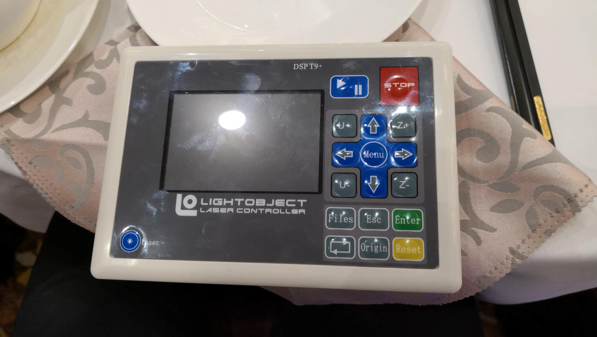

Update:
Just got the new template done. Any change request got to wait till 500x sold out (sorry Kee smile)
By the way, the LCD box will be painted to the similar color of the template so that you won't see the white border like the attached image is showing.
A few new features added, like the 're-cut' is my favor the most. I tried it and it work but I made a request to the programmer to make it more user friendly.
Two small features added: Layers sequence is easy to move around by mouse. Object on drawing area once picked, the layer for that object will be highlighted. So, it is easy to tell what layer is the object belonging to. Sometimes when two colors are closed and difficult to tell by eyes, this feature helps a lot.
The next change will be SVG file enhancement and added support for the new DXF and Illustrator and so on

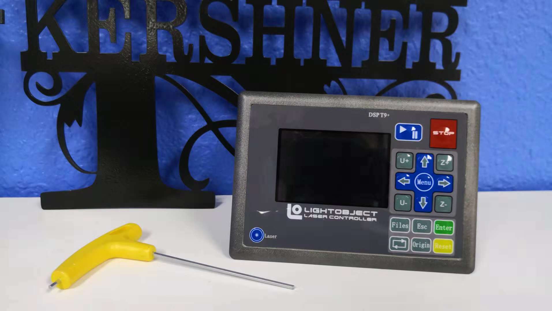

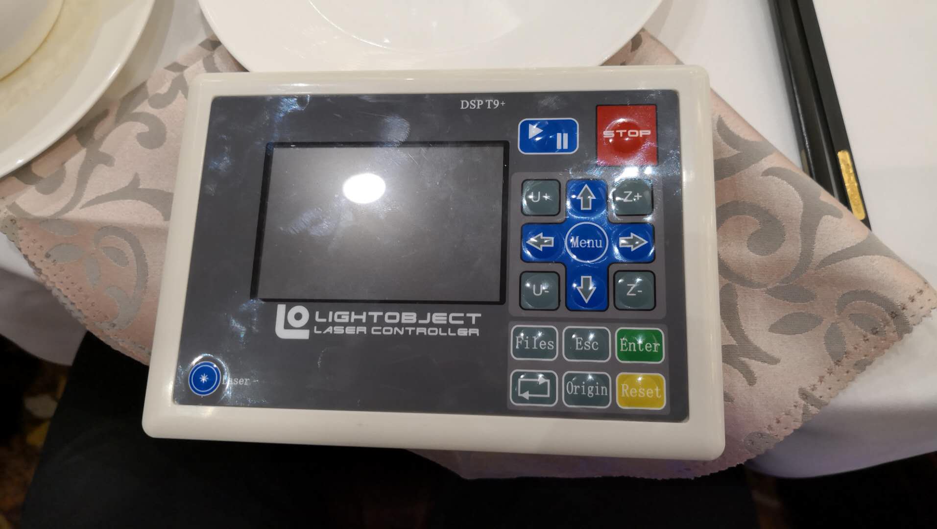

Here is another one look (actual) of T9 with new template and box.
The controller now come with a new software that allow 're-cut' . What is a 're-cut'? Image if you're doing job for a complicate design take take 30min or longer to cut and found that part of area not cut through from the 1st cut. What would you do? Well, like it or not, with other controller from other manufacturers, you have no choice but to start the cut from the beginning. Worst case would be that even the 2nd cut didn't cut through! :o
With T9 new software, you can have the laser head move direct on the area to do 're-cut'. You don't need to wait the laser head traveling from the beginning route. So, instead waiting for 30min or longer, now it take seconds. I'll try to shoot a video to show the new feature

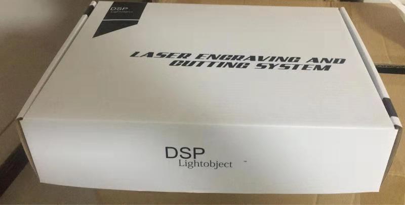

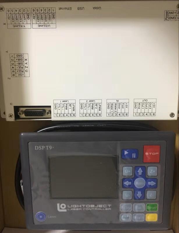

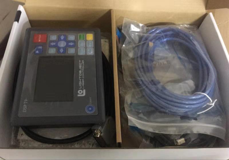

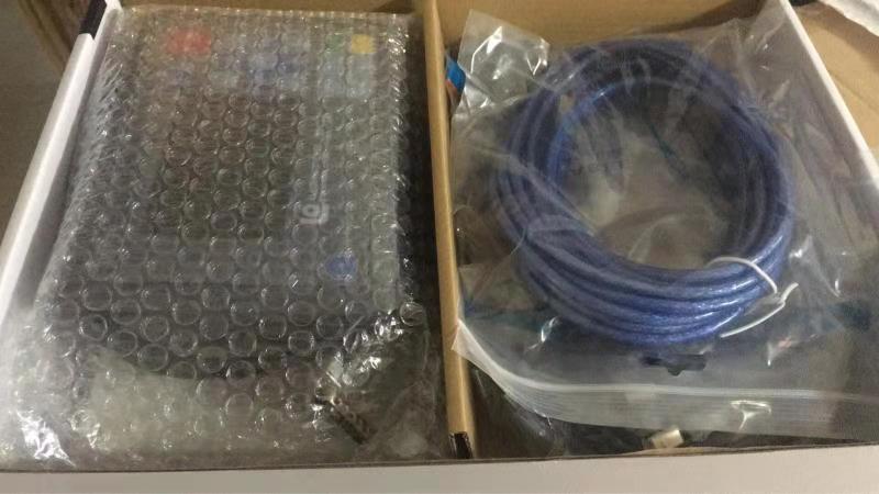

See our new packing of the new T9+
It will be ready in about 2 weeks

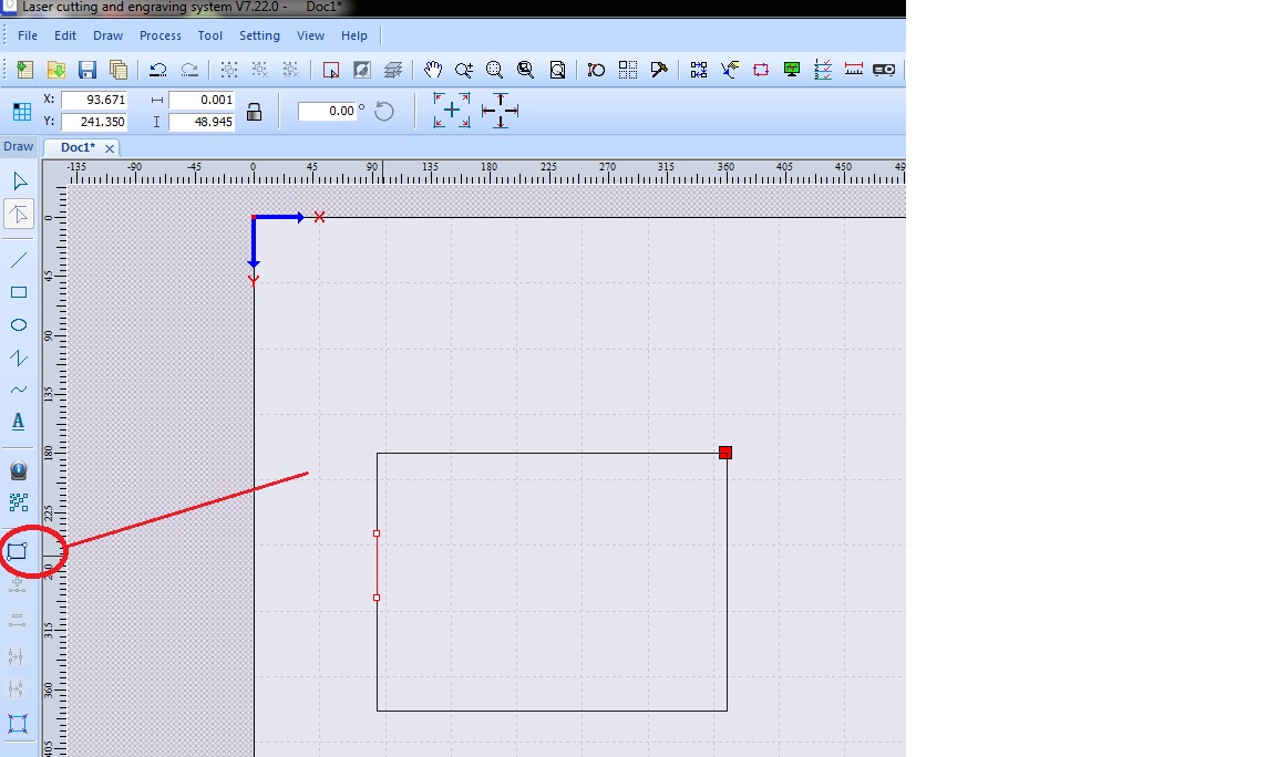

Morning folks!
I just posted a new download link for the latest LOLaserSoft 7.22.0. The new change of 'Re-cut' is pretty impressive and I like it. I have made so many attempts and finally the design team got it work the way I like. Welcome any feedback and I'm hoping that it is all positive experience with the new feature! smile
Download link:
viewtopic.php?f=55&t=3801
How it work: select the object you need to apply the second cut. Click the icon
Then move mouse on top of the object and make two set point by double click to cover the area you want to perform the recut. Afterward, point the cursor on top of the re-cut segment and right click the mouse. A menu will show up and from where you will see a choice of "Cut+". Click it and you will notice the selected segment changed color and a new layer will be created with default speed set 40% faster than the original setting. You can disable the other lays and leave the new layer checked. Click 'Download' and now you're ready to re-cut the area. Pretty straight forward, isn't it?!
So let's Cut! Cut ! Cut!..............!!! :lol: :lol:
